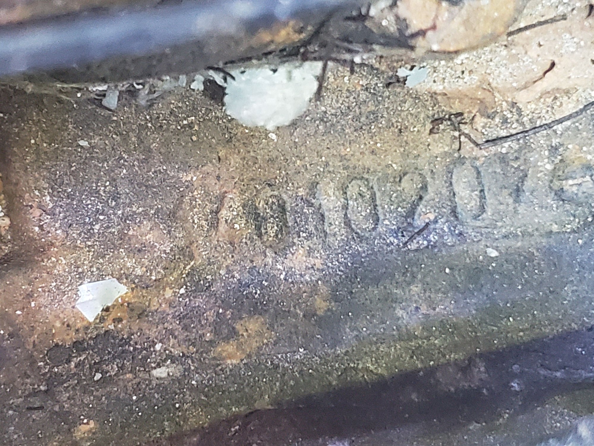

Finally made it back to his farm to look at the car and get more pictures. Still trying to figure out if it's an original 427. I'd been researching the forums and online and saw that 1 fuel line along the passenger frame was a good indicator but the tach redlines at 6000, which is a L79 327. Didn't get to check the transmission but it is a 4 speed. Just not sure which one. Fingers crossed on it being a m22 but that's hopeful wishing.
Currently the car has a 350 in it. Got the numbers for it and looked those up as well. 14010207, GM57LG. Not sure what exactly it came from but if anyone can figure it out I'd greatly appreciate it.

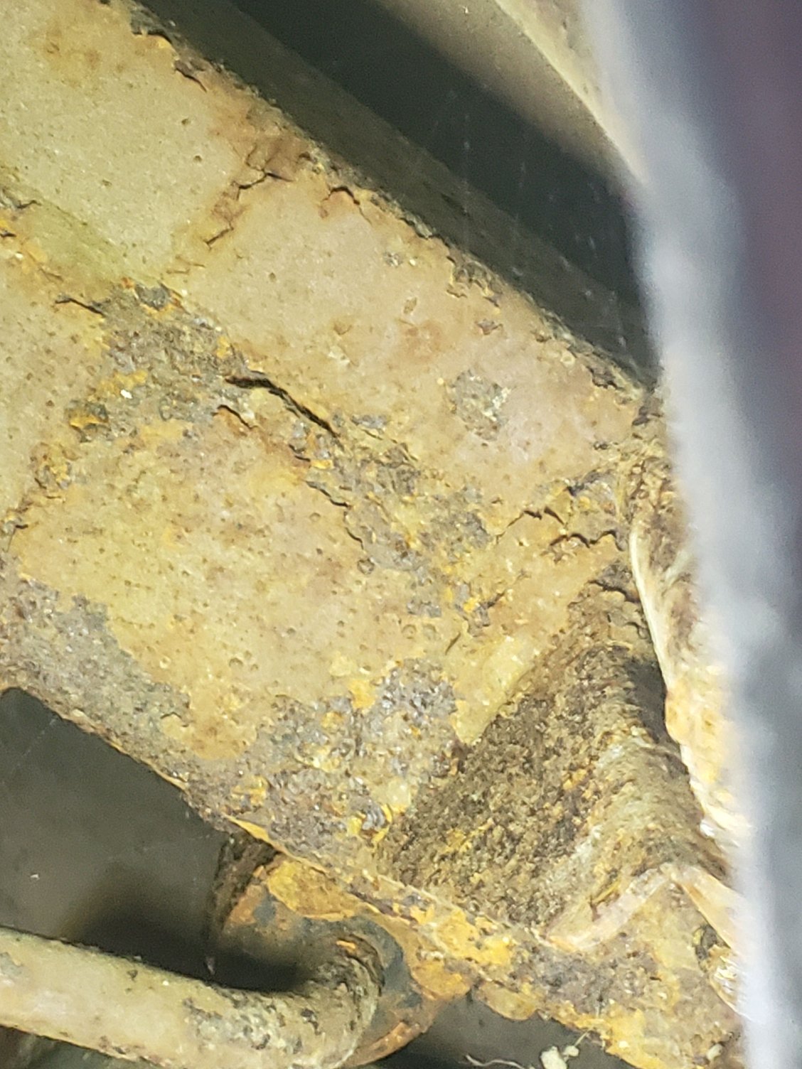

Just a few more pictures I took. I know the car is gonna need a lot of work either sand blasting all the parts or buying new ones, whichever I decide. But for 2k I honestly feel like it's worth it. Frame is pretty solid. Didn't see any thing rusted through. Just alot of flaking and surface rust. Birdcage is my biggest concern but I checked around the windshield and it all looked fine. Car hasn't run in a while. The guy I'm buying it from hasn't started it in the year or so he's had it. The oil was pretty black but not sluggish. Radiator hoses felt like there were chunks of something in them. Large chunks. So I know starting it won't happen any time soon. Would've been nice to hear it run before I get it and dismantle it but eh. If you guys see anything alarming please let me know. He's in no rush to sell it so I've got time to do more research.

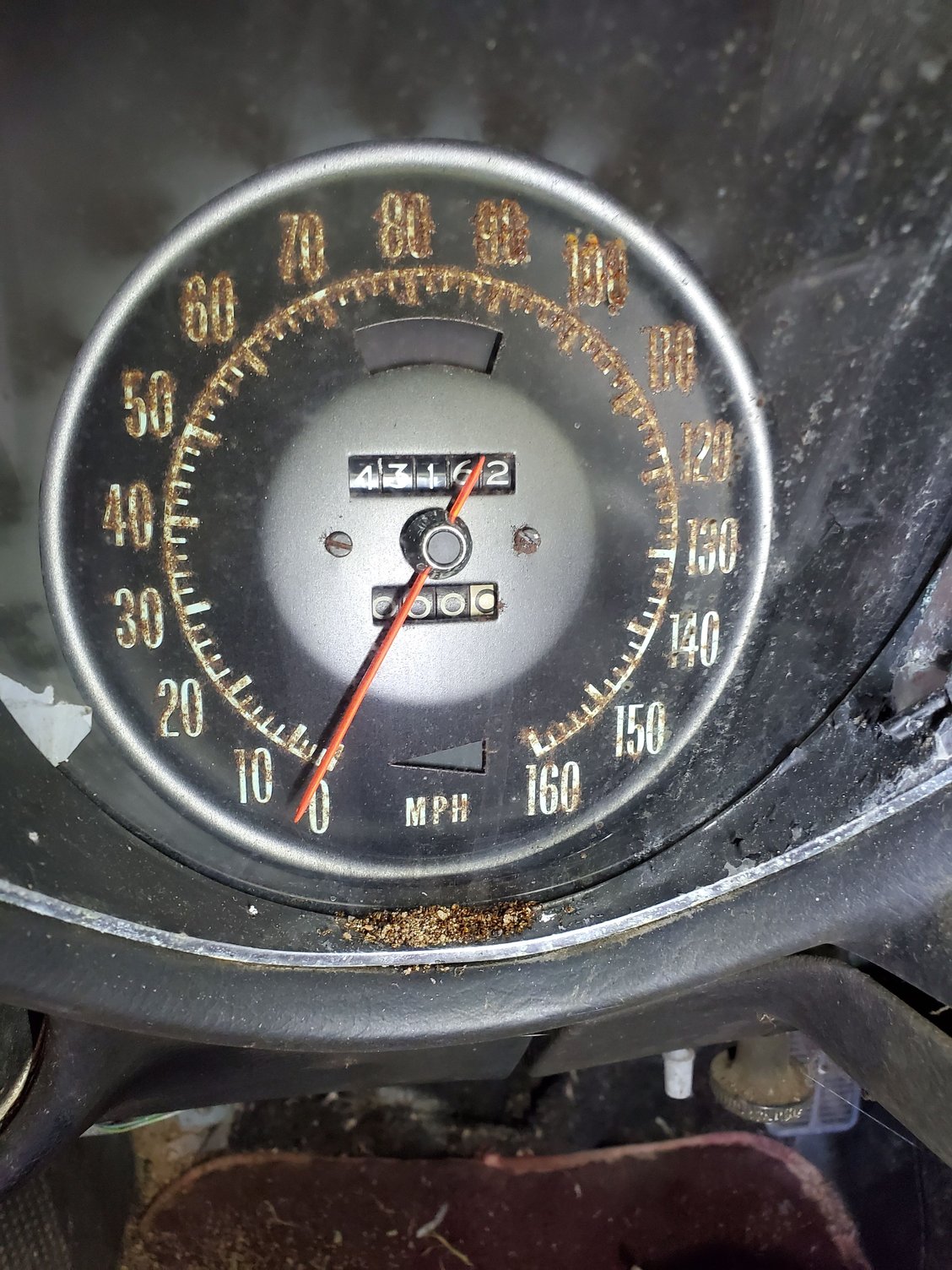

The rusting speedometer face would have me concerned. To me that would point to likely moisture-possible rusted birdcage.
Yea I was wondering why that could've been rusty. Birdcage is still one of my biggest concerns cause I can't really check it without taking things apart. I could probably get to the kick panels but that only covers the bottom corners

Take a good torch and camera with you next time you visit and get some pics of the birdcage windshield surround from under the dash. Also getting pics of the area behind the feet kick panels is a very good idea. Open both doors and get the area where the trim plate is on both sides.
I would say that car has rust in birdcage for sure, just need to see how much to determine if it's manageable .
Trust me , you don't want to do a birdcage rust removal project for your first C3 experience.

That would be my biggest fear, that the birdcage is ruined which would make it something I wouldn't want to touch. I can replacea frame and everytihng esle attached to it, but I dont want to do a birdcage or a windshield frame

I researched that 14010207 block number. Appears to be an 82-85 truck block. BUT.... I would not want this car even if it was given to me.... the only reason I would even consider taking it is for parts, and then only if I had somewhere to tear it apart.
I am not trying to discourage you, but you really should keep looking; this one needs too much work.
