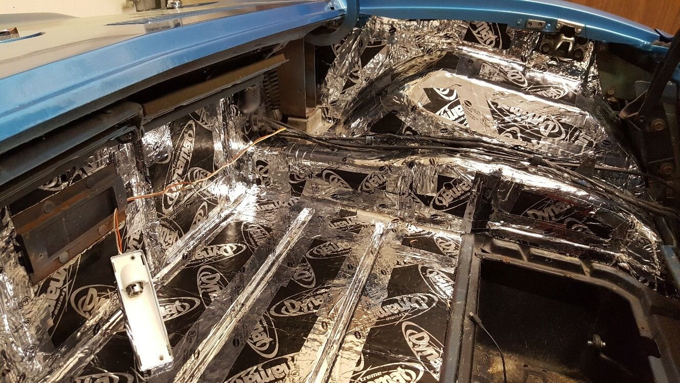

So I am done installing the Dynamat Extreme in the back of my ‘69... I am wondering if I am overdoing it (or underdoing it)! I have been cutting out sections so I can squeeze the stuff into each nook and cranny, then using metal tape (the kind used with flexible ducts) to keep the pieces from curling.
Here’s where I am. My first time doing this and yes, I’m pretty **** about details so this much took me several hours (like 8 total)...
Thoughts?
thanks guys!
Michael

That's how I do it, but I hear you don't actually need that much coverage. Not hurting anything but a couple more pounds.

i thought about that but other than impacting mph, shouldn’t hurt me...I’m not racing it (and I generally stay off the highways!)

You're not ****. You want to do a good job. Looks like you have done an excellent job.
I haven't done the back of my '81 yet. The front half I did just like you. I covered mine with Dynaliner on top of the Dynamat. The car is insulated and quiet now! Oh yeah I put it on the door panels also.
Craig

Thanks for the kind words. One bad thing about doing every nook and cranny means the two boxes I bought won't be enough.
When you did the doors, how much coverage did you get and were the doors affected (how they sit and / or close etc)?
Thank you again.
When you did the doors, how much coverage did you get and were the doors affected (how they sit, close etc)?
Thank you again.
I purchased a Dynamat pre cut door panel set from Summit Racing.
They definitely needed trimming to hide behind the door panel.
Stops all kinds of noises.

Looks great! I spent the extra time covering my cabin like you did as well.
Attachment 48348721
Attachment 48348722
Attachment 48348723
I still need to dynamat the doors. But one large box covered the whole cabin and left 2 sheets available for the door panels. I will likely cover the rear storage compartments if I have enough extra left.

One question I do have is whether or not you used the Dynamat on the area where the sills mount? I didn't yet because I figured that might mess up the height the sills sit at...I know the Dynamat is only 1/16" but still...

I did not put any dynamat on the sill mount surface for that same reason. .

Installing the Dynamat on the doors made a huge difference.
It quieted down the outside noise and temperature as well as the squeaks and rattles of the door.
I cut openings for all of the adjustment screws and around the power window motor cover for easy access.
I also placed Dynamat inside of the door on the outer panel.
I am extremely happy and have only done the doors and front of the cabin.
I just installed some louder mufflers and need to do the rear now.

I agree, doing the doors made the biggest difference for me. Huge noise reduction and I just cut little strips and put them in all the easy places so I would say i got about 40-50% coverage.

So, I'll ask you the same question...did the addition of the Dynamat make any difference to the doors (did you have to adjust them due to weight?) once installed?

I did not adjust my doors. Been several years since I did it without issues.
