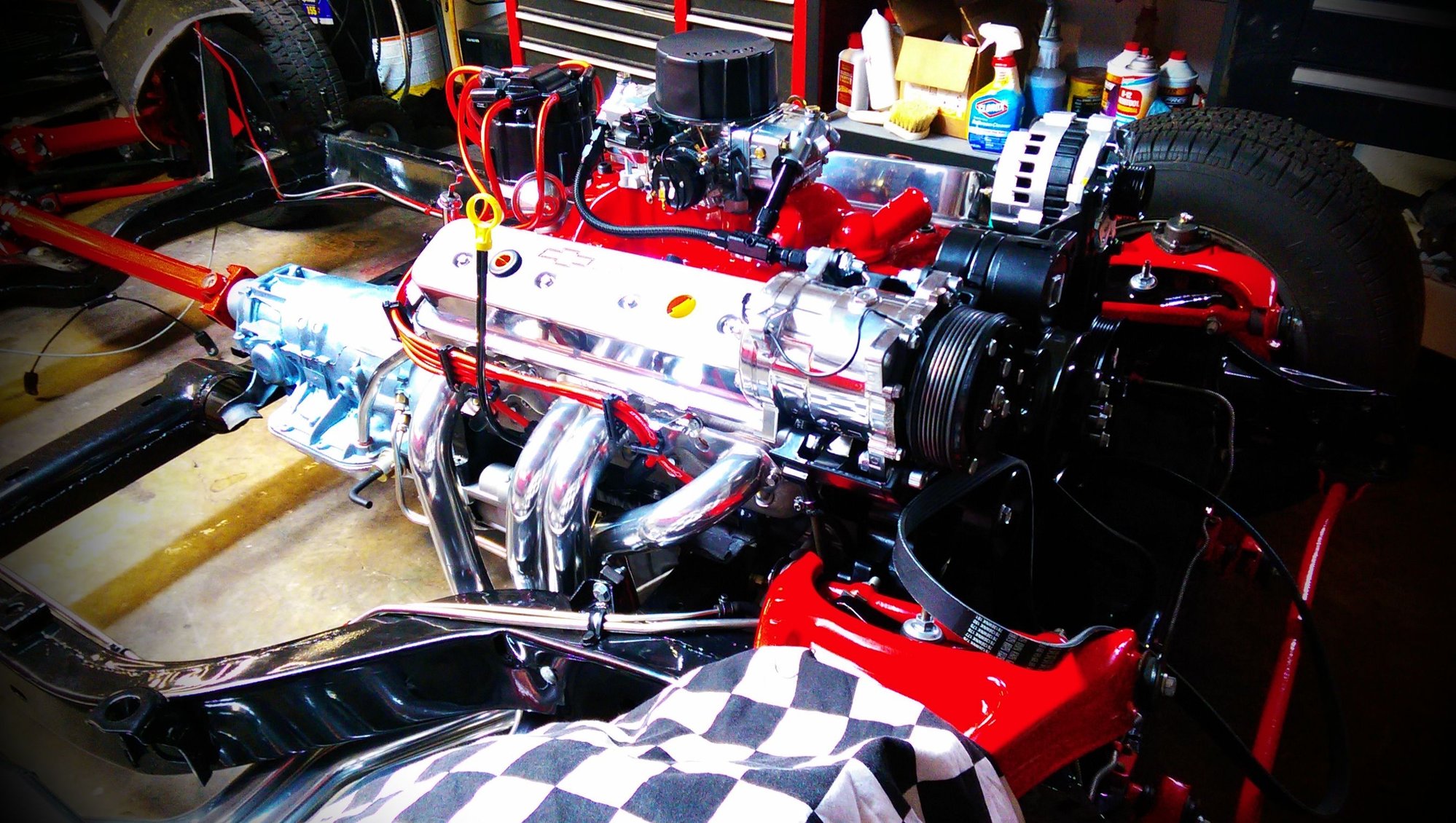

ZZ5 GM performance here with angled plugs too. I was told the same. No problem with hooker headers on my 74!!
