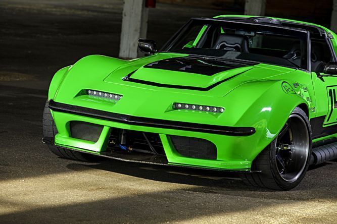

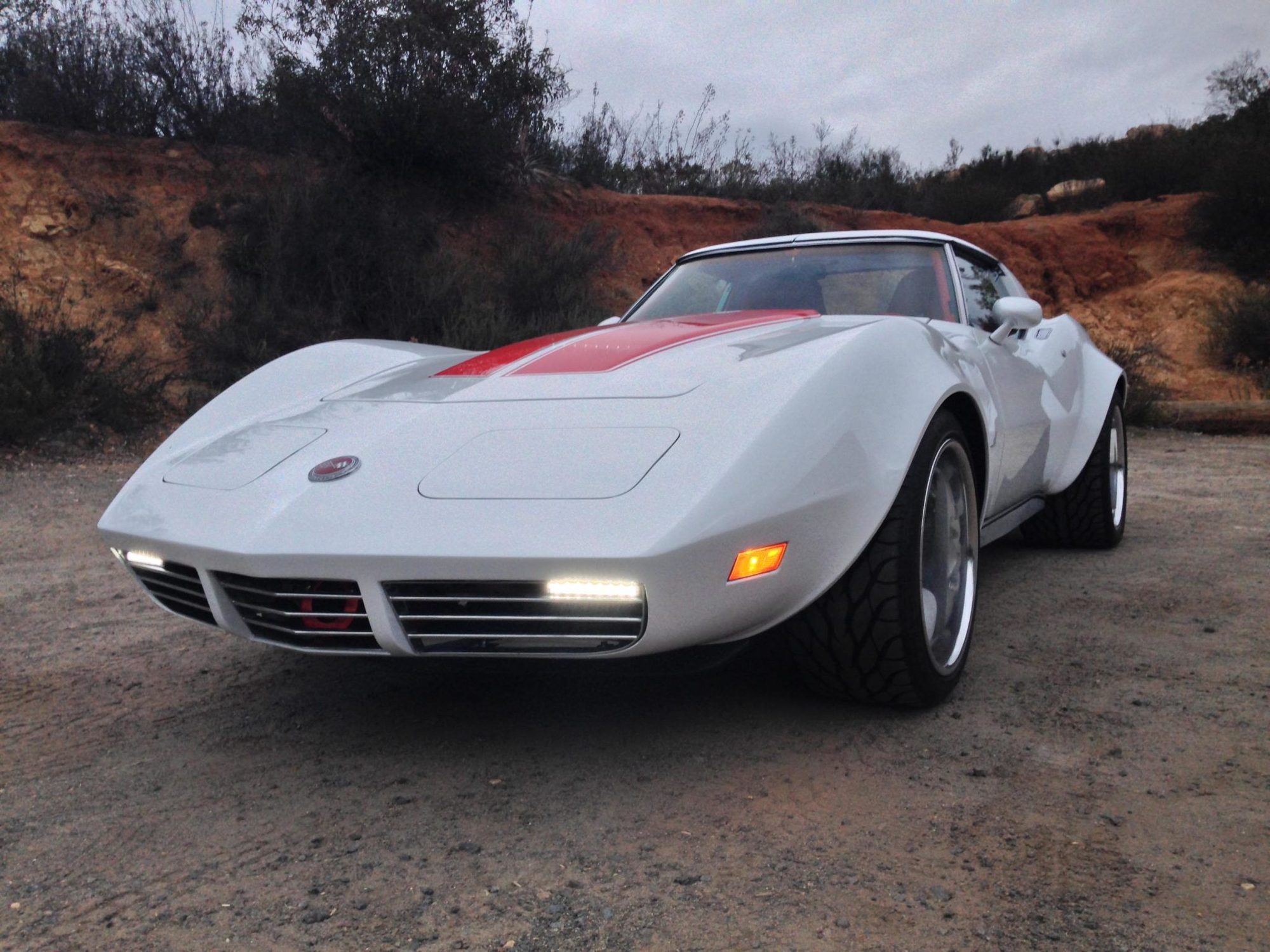

Here's some custom grills-
mesh look-
I like this one-
This is fellow member "The Punisher"

That yellow one is sort of what I’m thinking of doing. And then have a stealth marker light behind the grill.

Google "ridetch 48 hour corvette" for more pics-

It absolutely will. Large holes flow best, small holes add turbulence. At high enough speed, the air will "see" it as an obstacle, especially for a fine mesh. The stock slots direct the flow towards the radiator, and more air comes from under the bumper. Later cars (perhaps yours, too), have a spoiler well under the bumper to direct additional air over the radiator.
For the RideTech car, this may be intentional. At speed (for a road-racing car), you don't need to breathe all that air, and keeping it out from under the hood helps keep the nose down. There are several racers on this Forum that intentionally limit the amount of air that goes in the front of their car. The RideTech car also has the big C7-style hood vent to let the cooling air out of the engine compartment after it has been through the radiator.

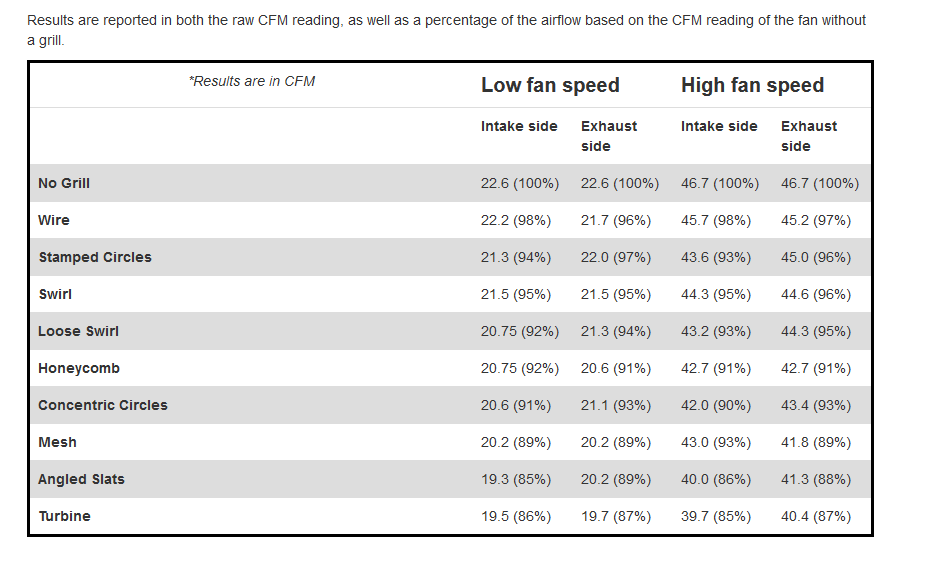

This is for computer fans but you get the idea - cfm with different type of grills-
Interesting read- https://www.pugetsystems.com/labs/ar...nce-Noise-107/
