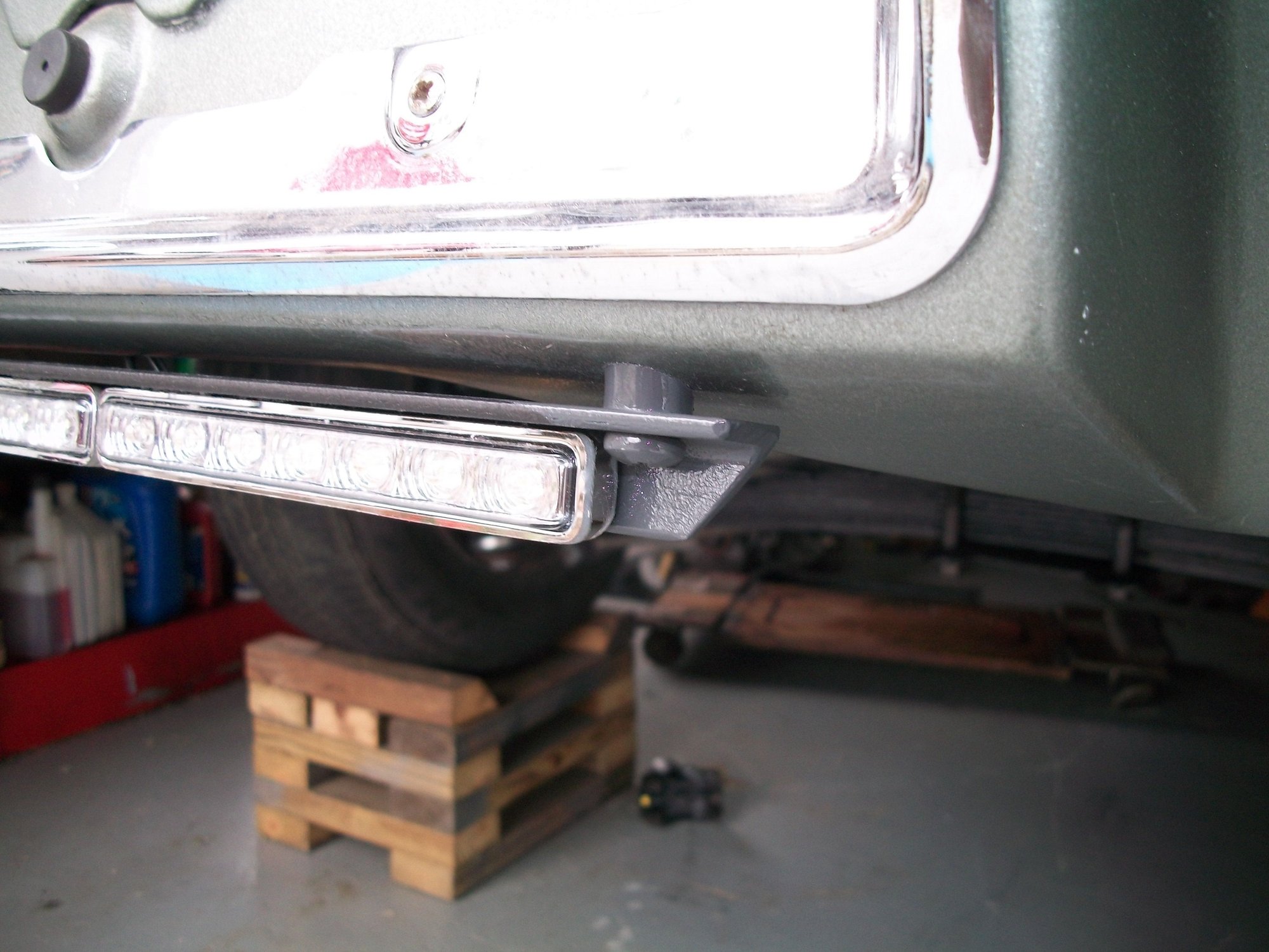

I bought one of the license plate brackets with the LEDs built in.... then found out it wouldn`t fit inside the chrome bezel. So I cut them off, and mounted them on a piece of 1/2" by 1/2" angle. Plastic spacers cut at an angle allow it to sit level, even though it`s mounted to the curved valence. Total cost (not including tail lights) about twenty bucks!

Really like the set up Old GTO! do you remember where and which frame it might have been?

Really like the stealth approach. Do the leds provide satisfactory illumination? Which leds did you use.
Thanks much
Off the shelf at AutoZone
