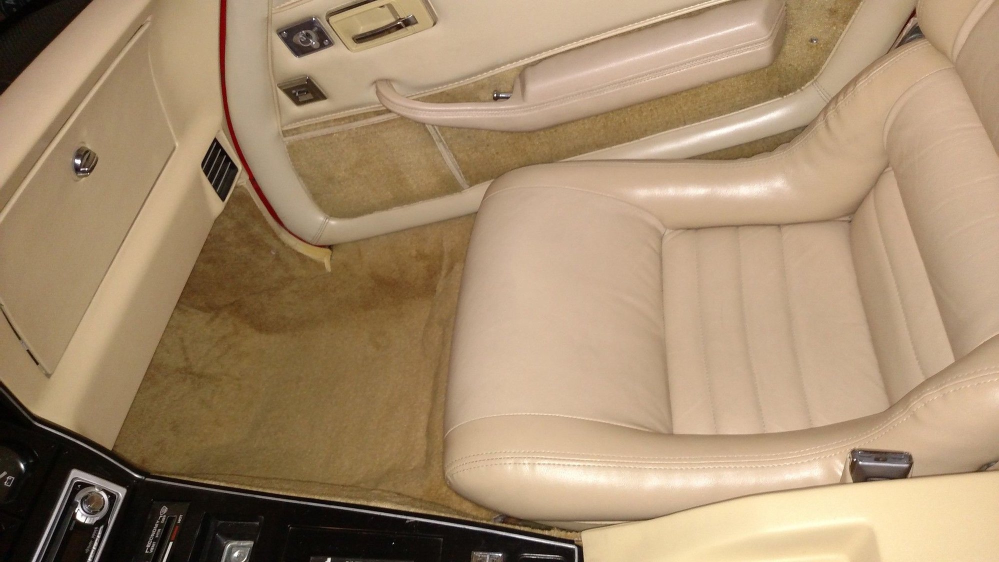

I resprayed my door panels and touched up my seats 3 years ago and they still look good

wow that looks great. Which brand dye did you use? Did you use any adhesion promoter?
