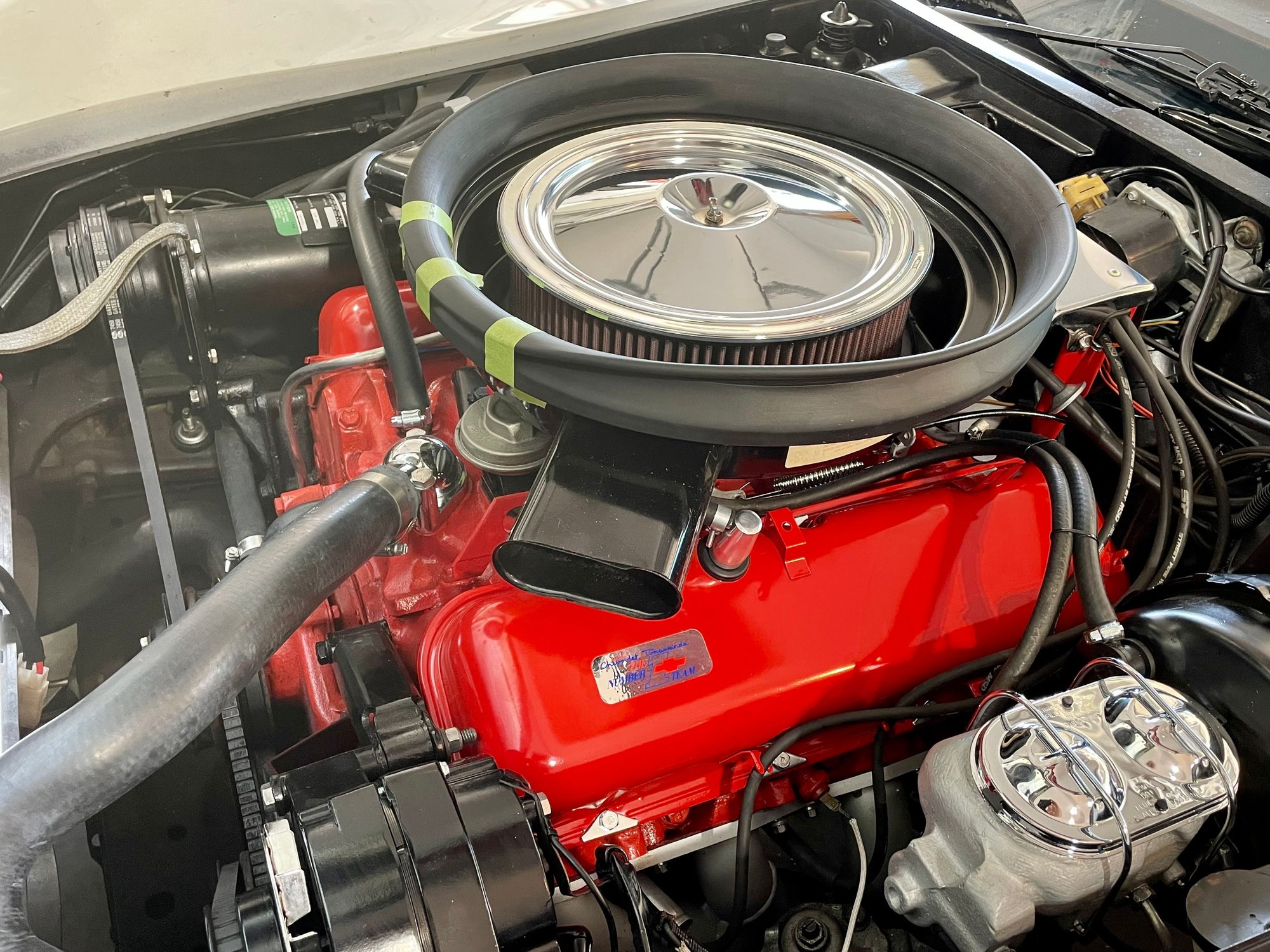

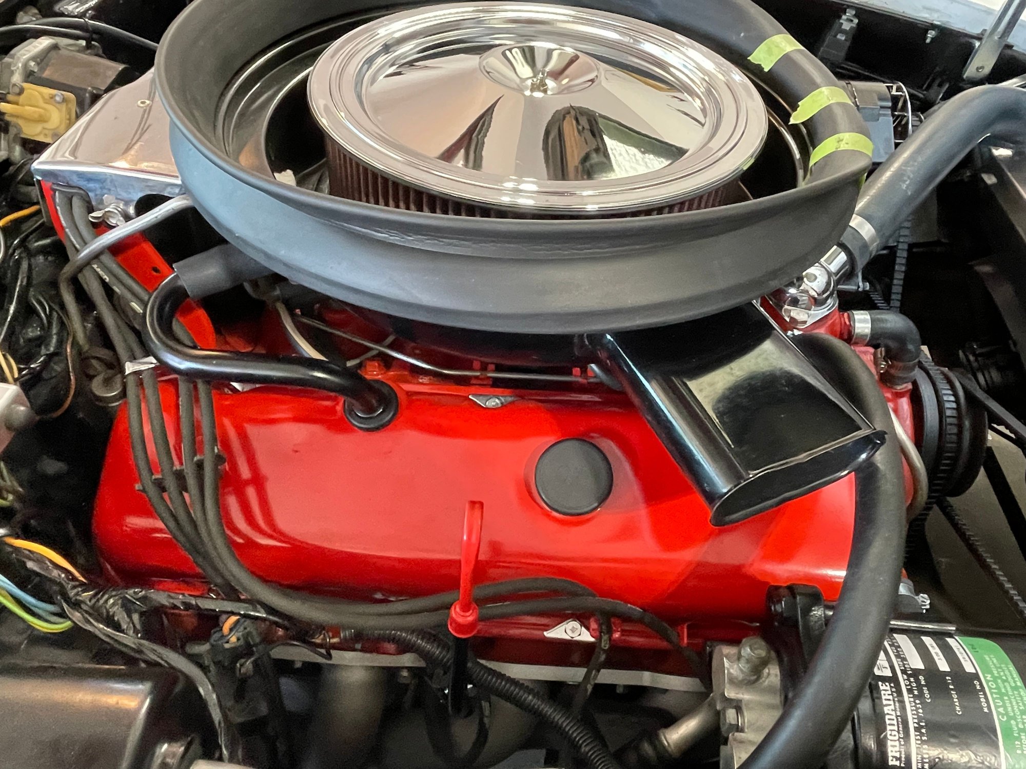

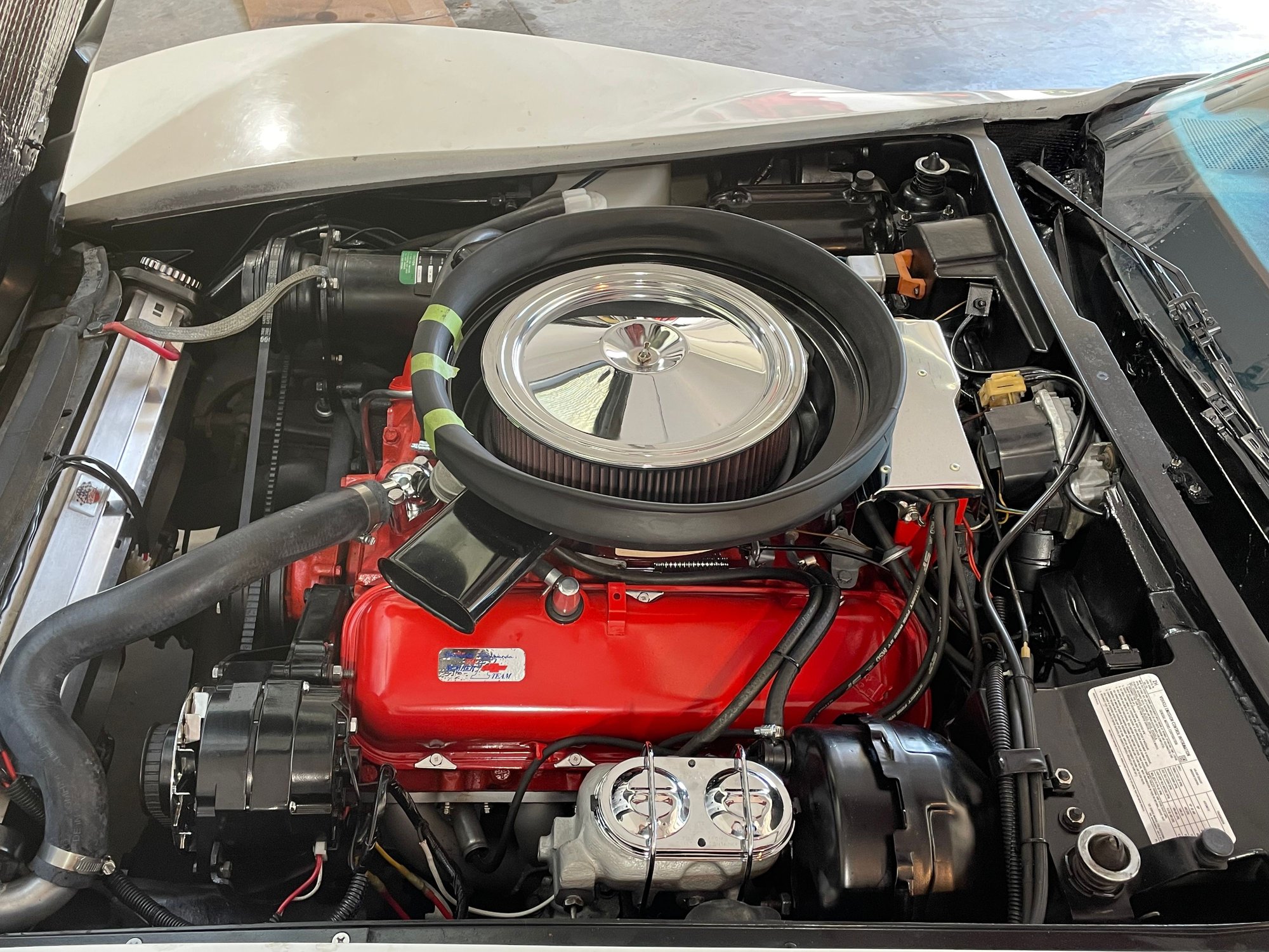

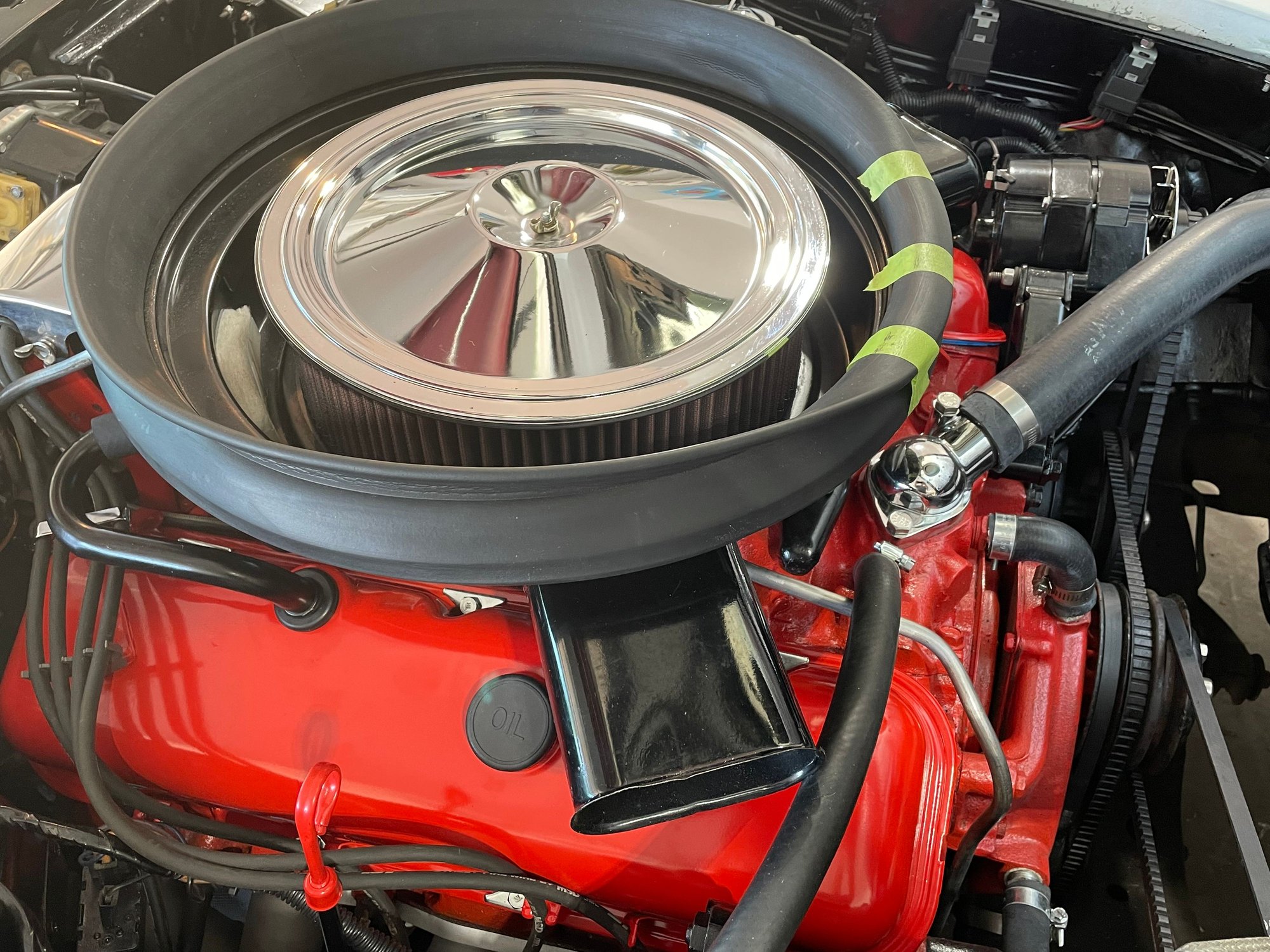

1974 454…. Before and after. The tape on rubber is to train the rubber to lay correctly…

Scuff any knuckles doing that, nice job. T

Just focused on 1 section at a time…took a few days

Awesome results Jetglow, looks fantastic!

Nicely done!

I love a nicely detailed compartment or undercarriage. You did a great job, not the sloppy rattle can hope it doesnt overspray too much deal.
What a difference!!

I did use a rattle can… but one section at a time… anything I did not want to get paint on was masked off or aluminum foiled…pulled the valve covers and stripped/painted them separate. Cleaned up and detailed the sloppy wiring/ hose job from the factory too…

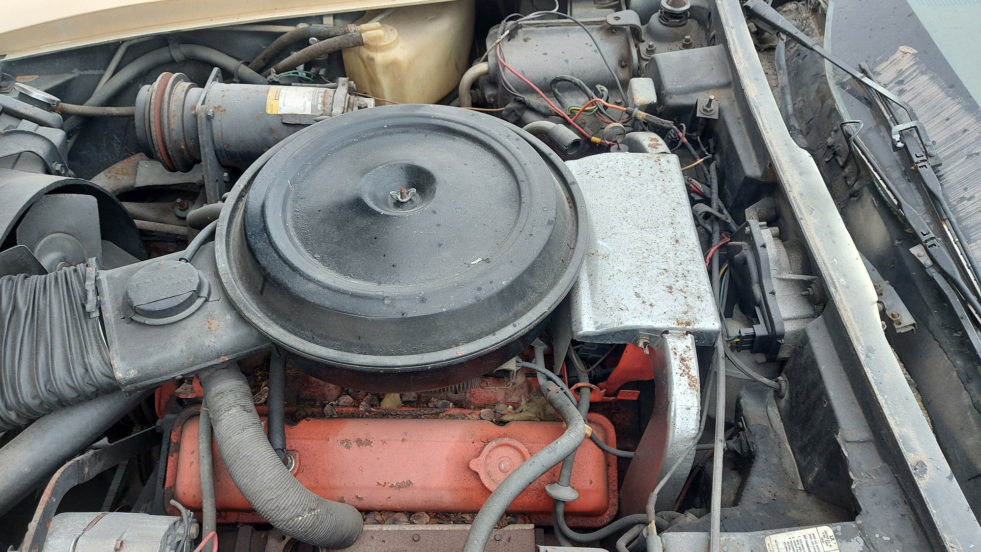

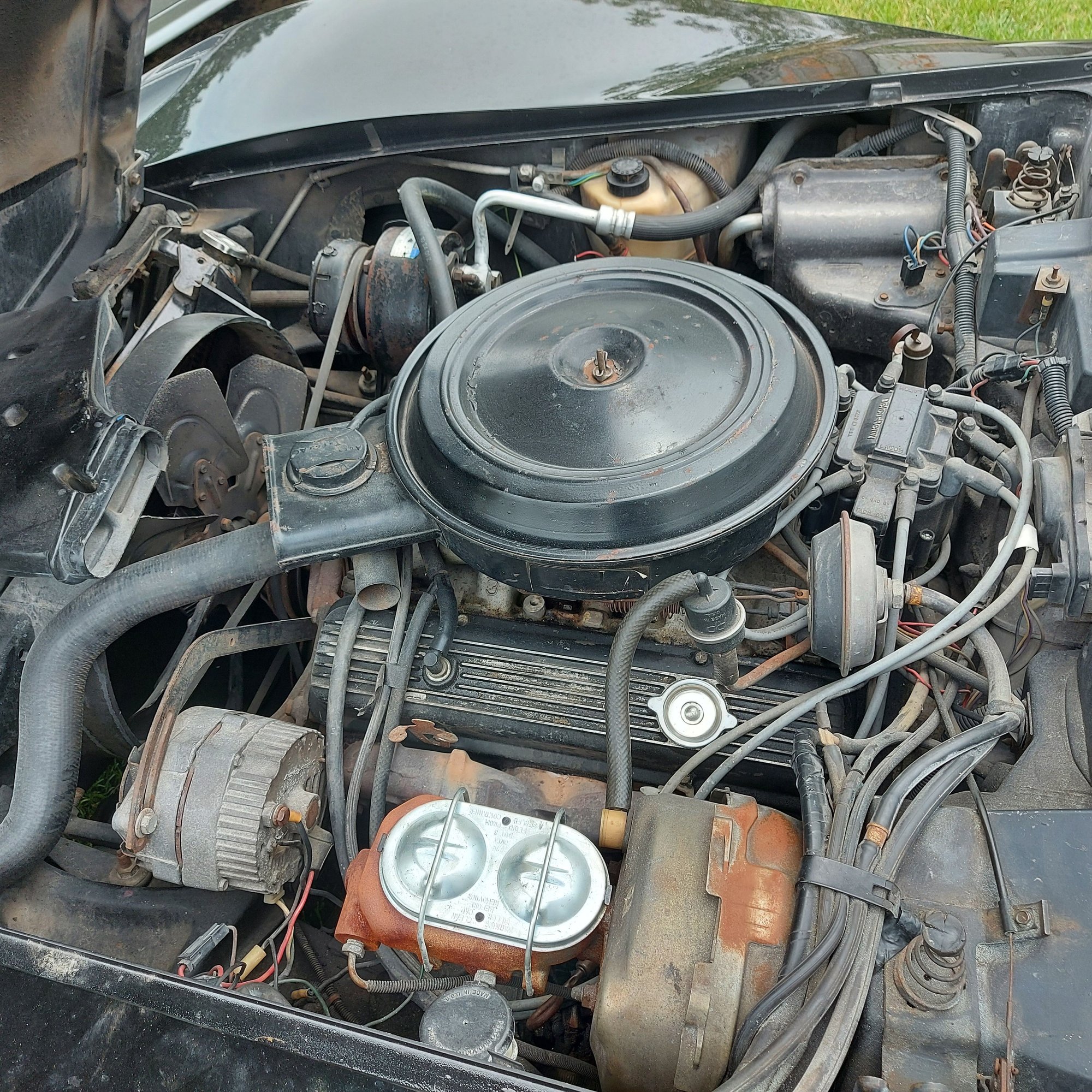

This is how my 76 looks after approx. 20 + years in storage. It's scruffy, but largely untouched. I'll be getting at it in the next few weeks and will repost how it looks after a bit of detailing and maintainence

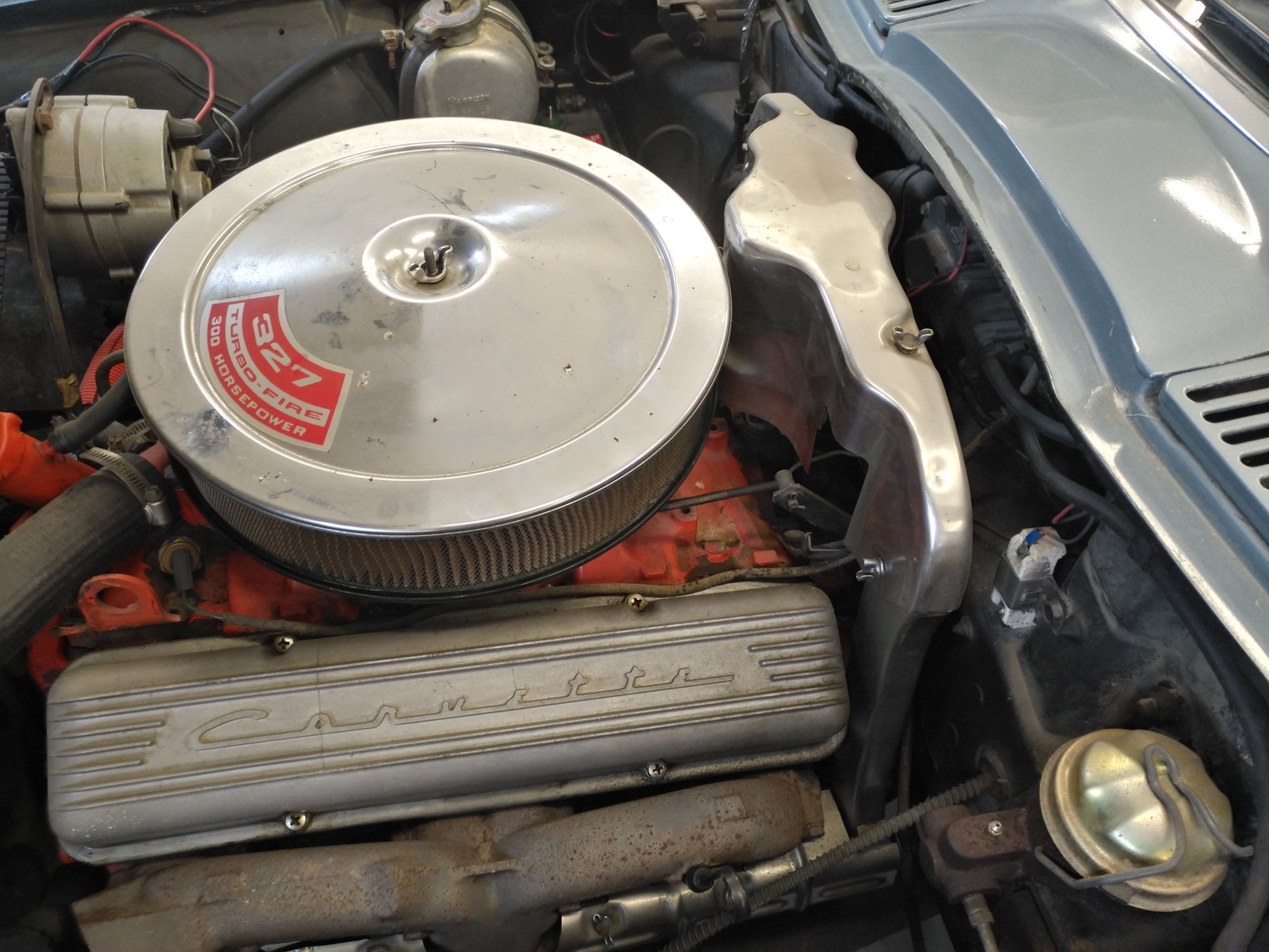

This is my old 1963 s-w coupe from a long time ago

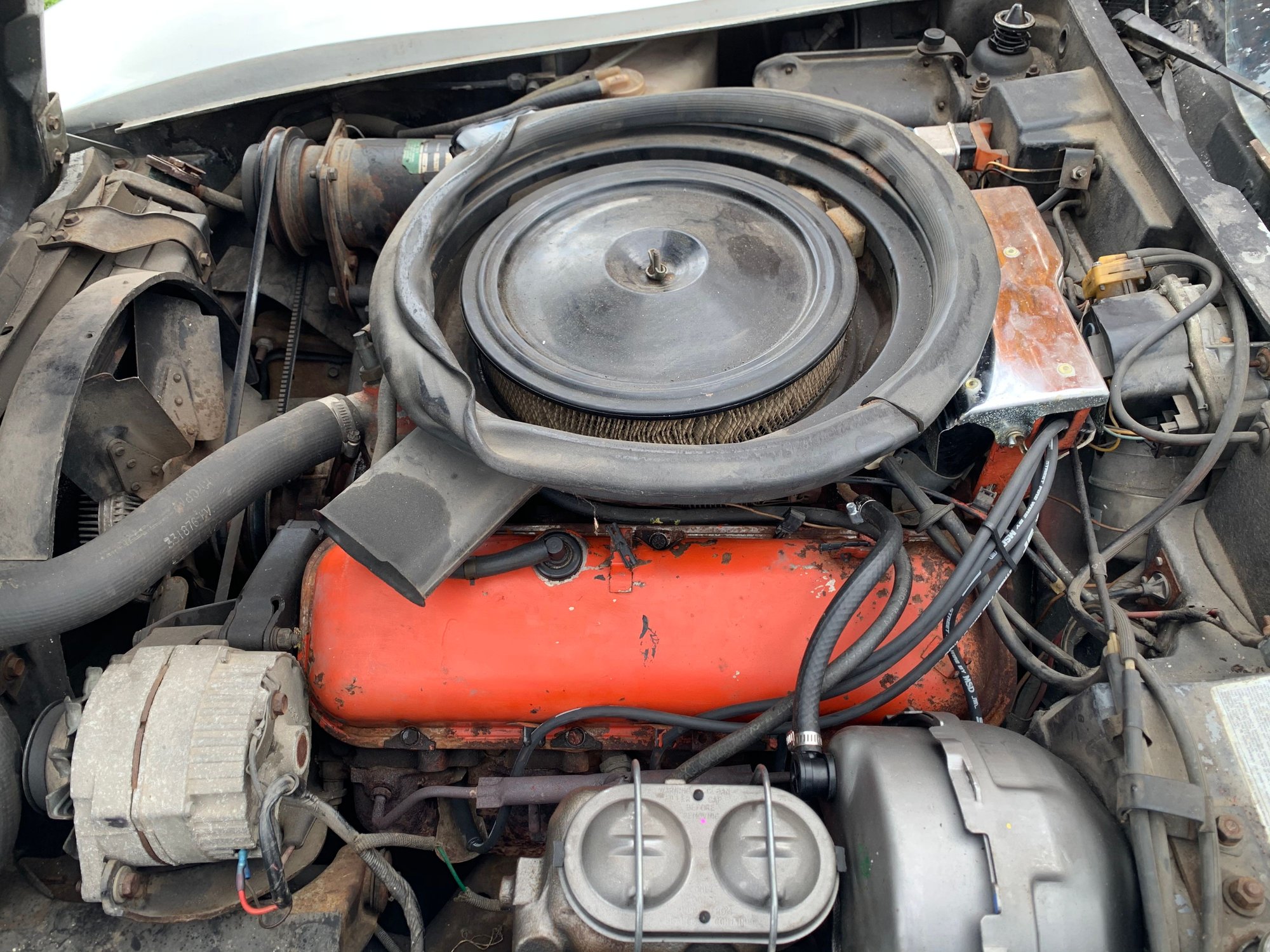

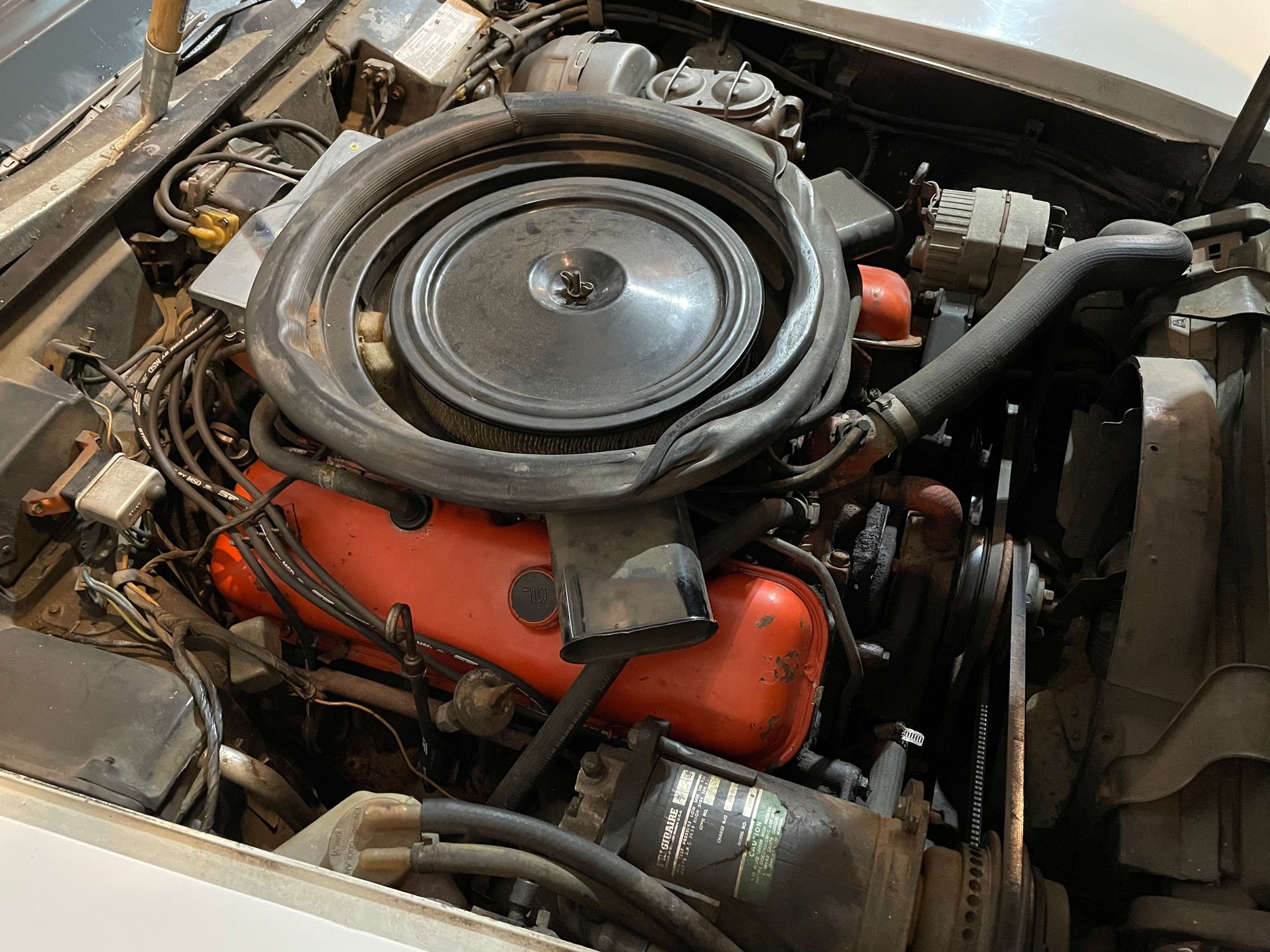

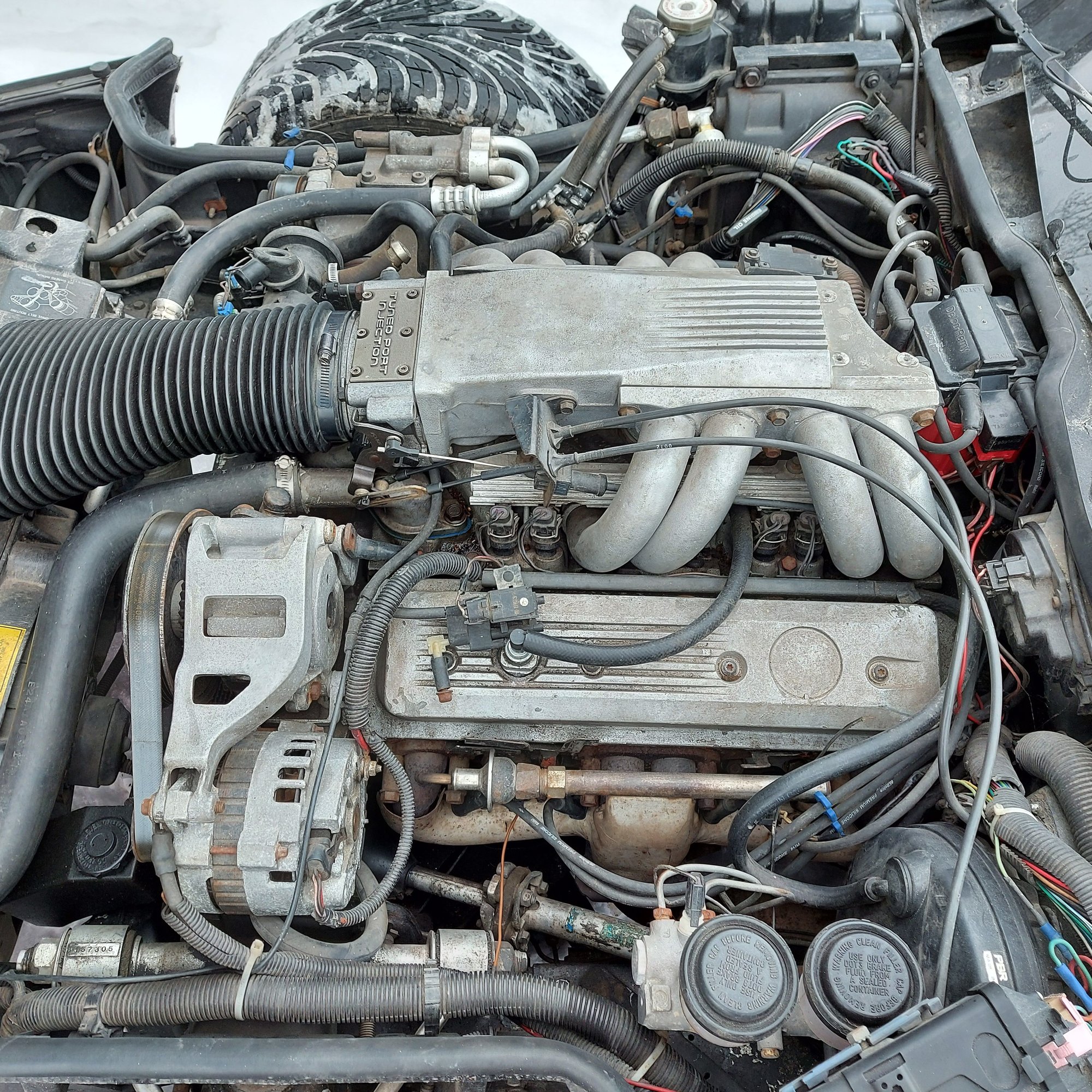

My ruff and tough 1987 convertible
Old Feb 26, 2022 | 04:20 PM
  #396
ustabevetteguy's Avatar
ustabevetteguy
Joined: Mar 2015
Posts: 65
Likes: 32
My 1978 Indy Pace. All of my Corvette's are grubby under the hood!

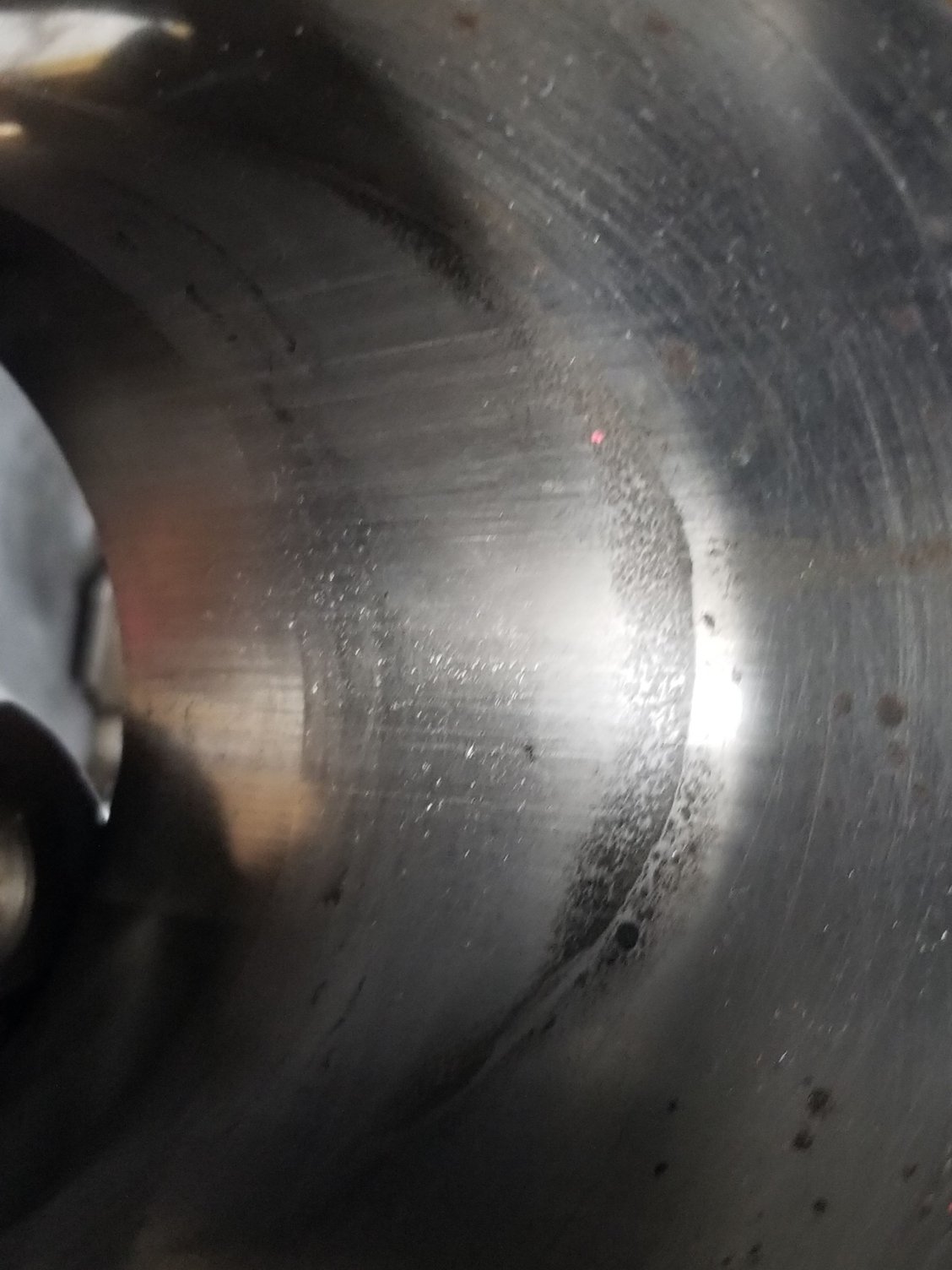

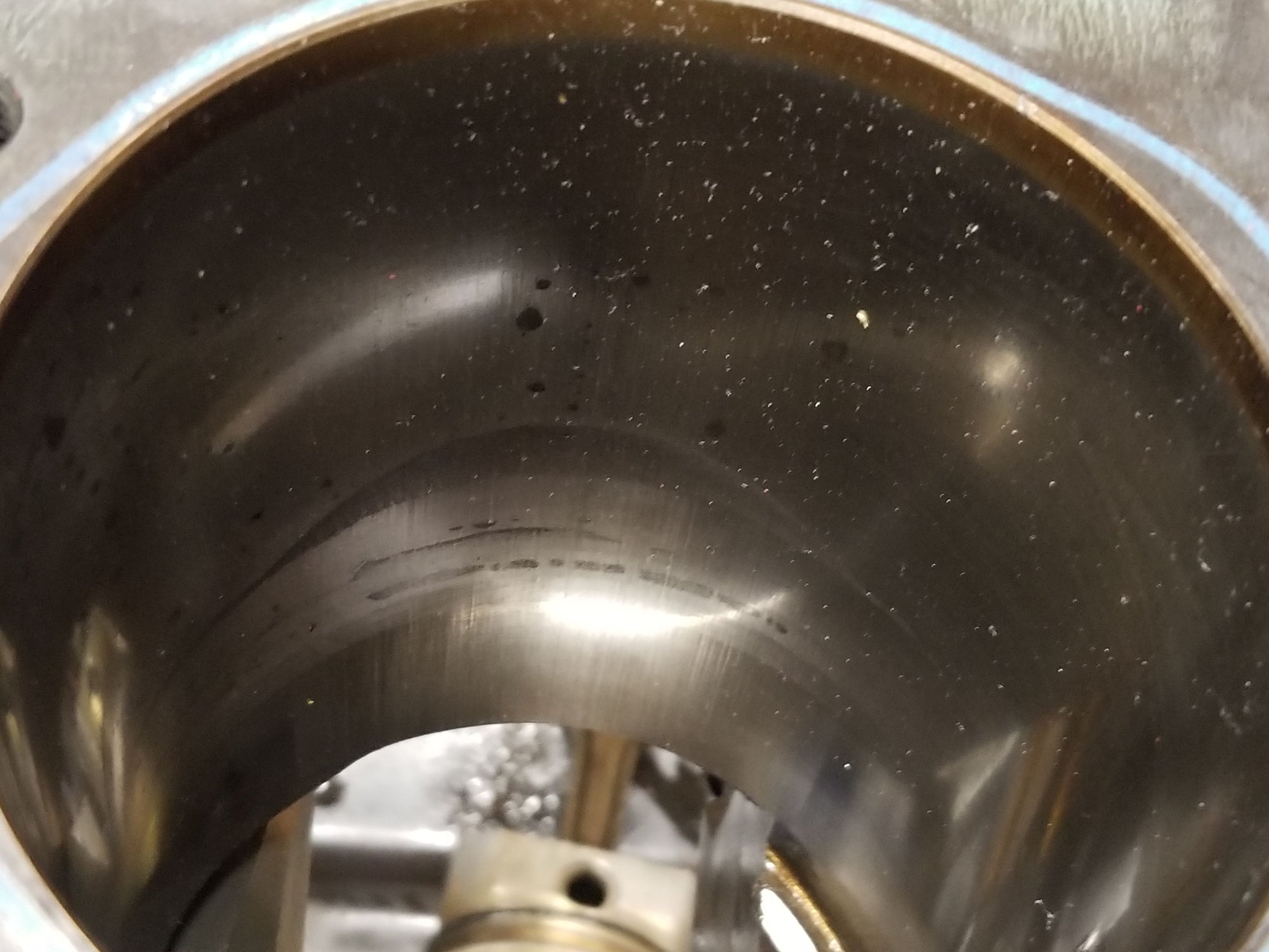

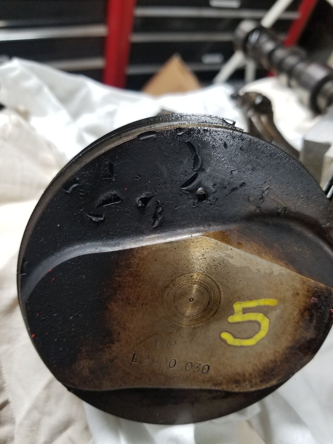

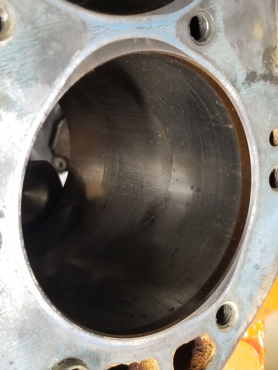

rust damage
same damage different cylinder
again

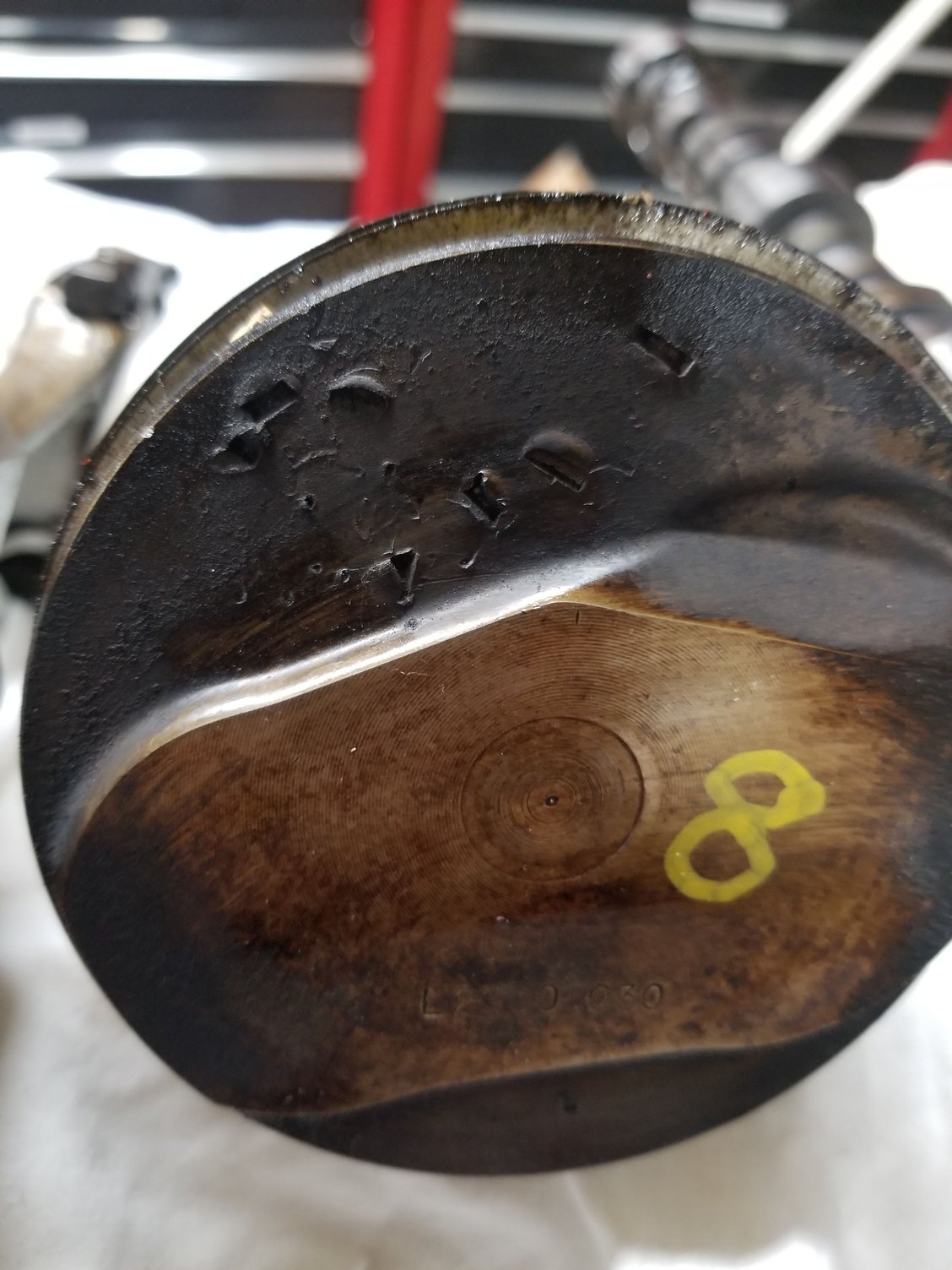

looks like a screwdriver was used to help free up this piston
this one too
its .030 over now...its at Golens awaiting a baking and inspection to see if those cylinders need a hone or a bore....Im guessing bore and a decking. Crank may survive a polishing and everything else is getting scraped except the heads and that intake.
Good news...Golens says the block will cleanup with just a .010 over hone for 4.290 total with -38 cc dome which leaves me some more block if there is a next time. With a 119 cc chamber I'll be just below 11:1. THey also say the crank will polish up nice and the rest should go smoothly. The pistons just left the manufacturer and should be there this week so they can final bore an hone and balance. I should have the block and parts back by April.
My tripower is at Holley and should be back by the end of this month as well
