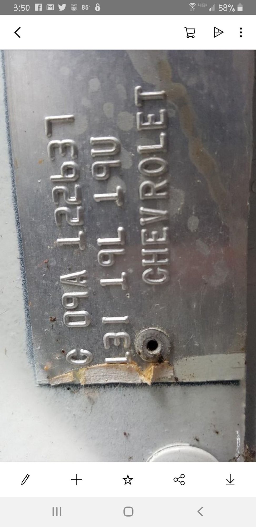

Can anyone tell me, based on the trim plate inside the driver door, what color the original interior is?
C 09A 122637
131 19L 19U
Chevrolet
I have had no luck getting an answer. From my research it has to be either silver green or silver grey.

are you sure about the 131?

I believe silver gray cloth is coded 13C, but Bowling Green used an I for some reason, so it could look like 131 . . .code 132 is silver gray leather. Should look nice with black!

I posted a picture of the plate. Seats are leather and I'm trying to replace carpeting. Want to get the correct color. Thanks for the reply

Looks like 13I to me rather than 131 as the ones are all the same in the other locations. There were a lot of special combinations in 1982 and it was possible to order non-standard colors also. Good luck in your search!

13I is the Silver Gray (also called Slate Gray) interior.
A trim tag marked 13I could be either leather or cloth, 81 and 82 Bowling Green trim tags didn't differentiate between leather or cloth. The 13C and 132 were strictly for ordering purposes. Order carpet for the silver gray interior, and you'll get the correct color carpet.

You already got the right answer a few times it seems, but I post this site whenever I can, it has never steered me wrong.
http://corvettec3.ca/interior.htm
Bowling Green car, 13l Silver Gray Leather.

...I believe silver gray cloth is coded 13C, but Bowling Green used an I for some reason, so it could look like 131 . . .code 132 is silver gray leather...
I agree. Silver gray.
