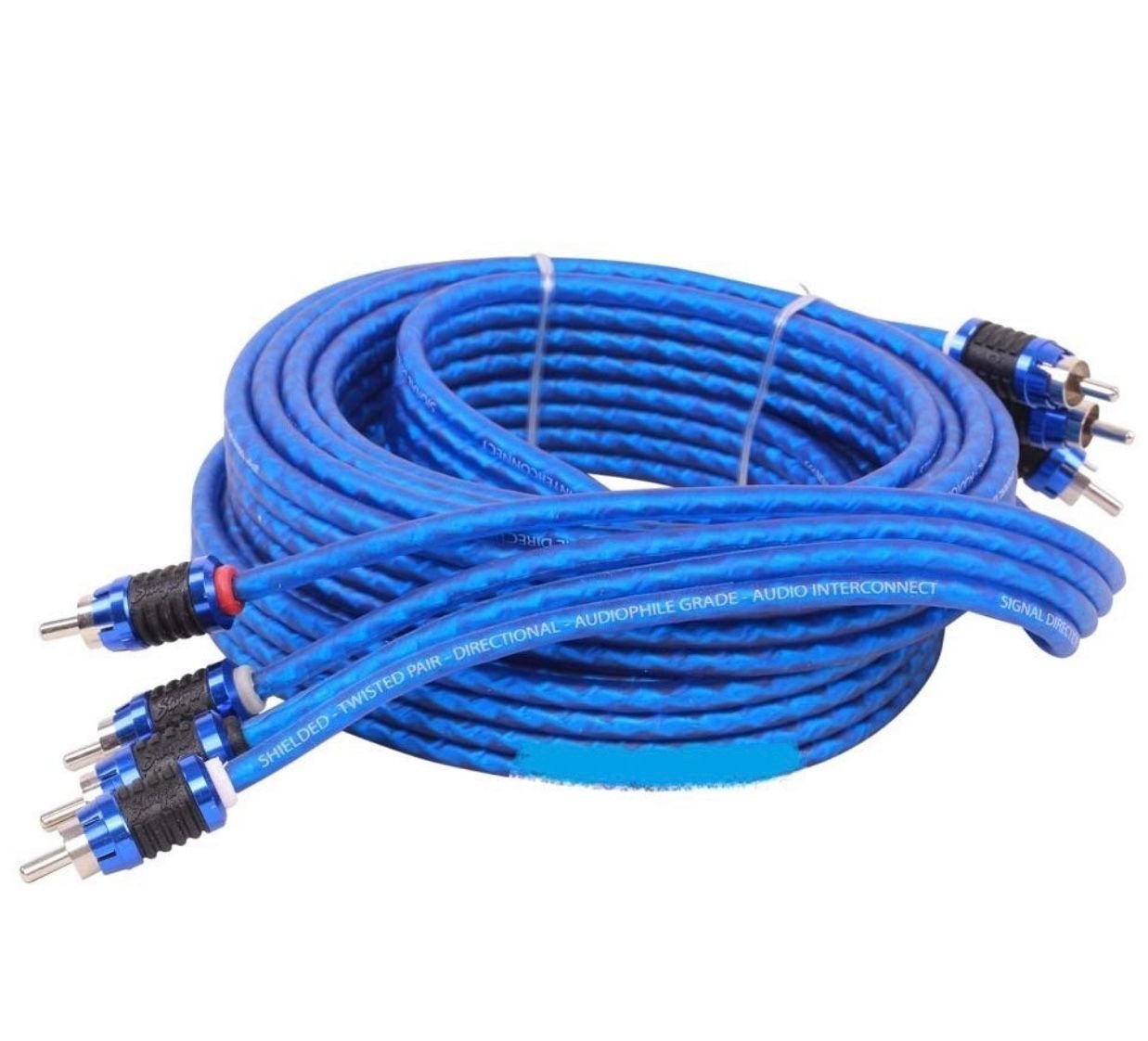

When you say (1) RCA- I would guess you mean one cable with two ends- probably colored red and white male ends. Like below?
It totally depends on how you are wiring the speakers- as there are several options and if the radio has front and rear RCA outs...
You can wire speakers in parallel- and bridge the amp....and only need one RCA
Or you could just use a RCA Y adapter at the amp- as the preamp signal wouldn't be affected by splitting it... each channel to each speaker...
Really need to know more about what you have...

I saw the 4 channel version of this cable online and it can be delivered by tomorrow which is great. I guess I can just sell the 2 channel rca and use this one instead to make it easier?
