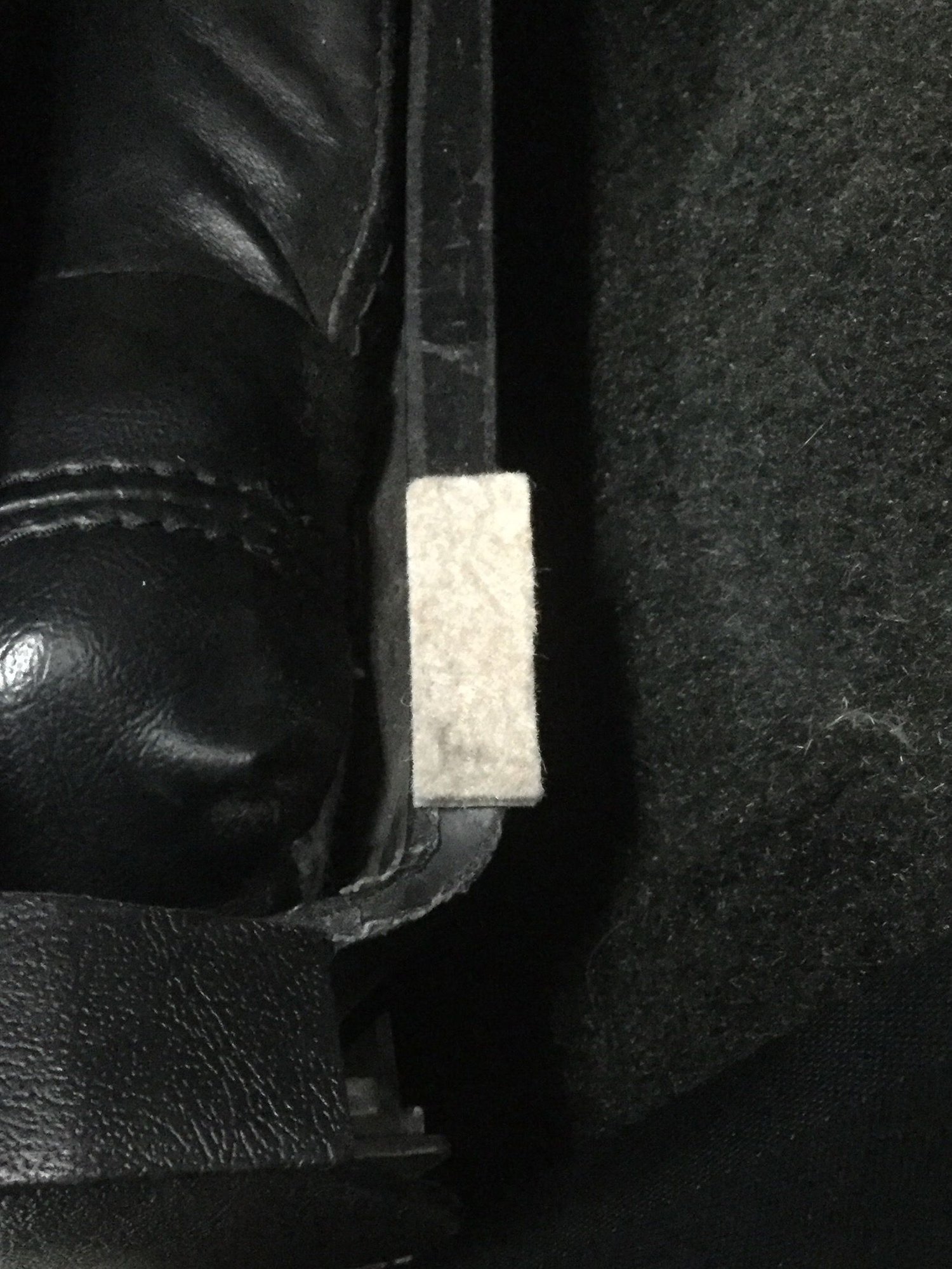

Old May 12, 2019 | 08:07 PM
Black4speed's Avatar
Black4speed
Joined: May 2017
Posts: 91
Likes: 14
From: Canada
Old May 12, 2019 | 08:18 PM
Black4speed
Joined: May 2017
Posts: 91
Likes: 14
From: Canada
I posted a pic above, I just used those sticky things that you put on the bottom of
your furniture so you don't scratch your floor. Just cut them to size and put one on either side.
Now your seat back will be in more of an upright position.
