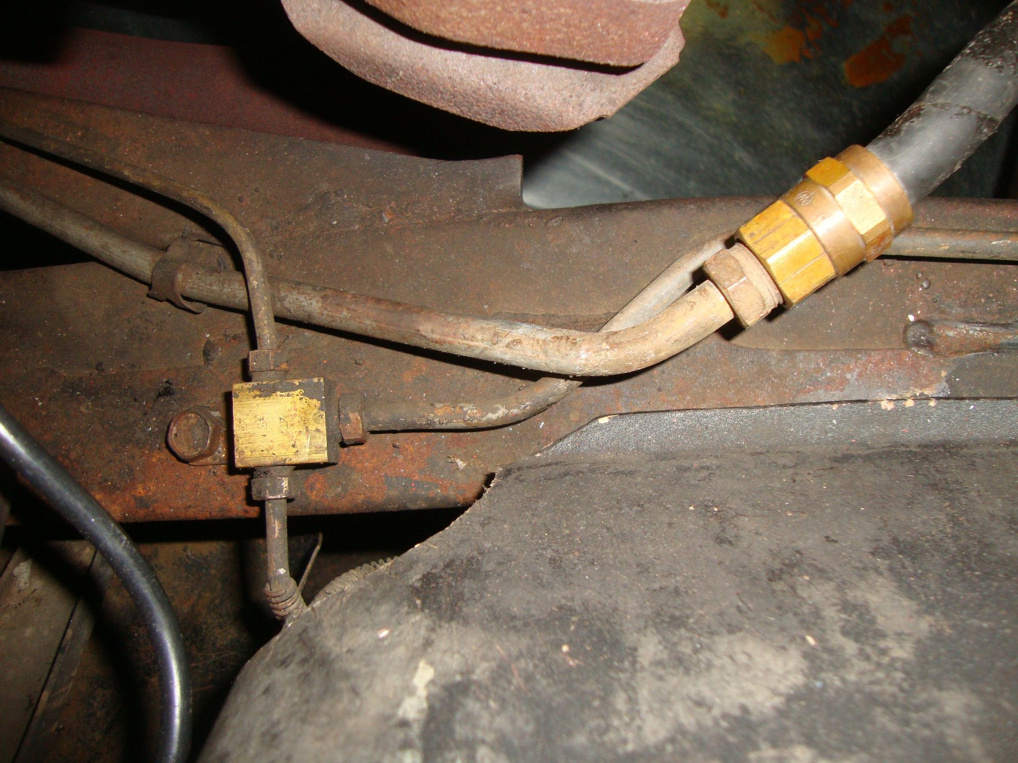

Default 1957 fuel line
Hi Jim
I have attached a few pictures from one of my unrestored 57
You look to be getting a little to close to the exhaust
Note the location of the last clip to the frame
Dave
