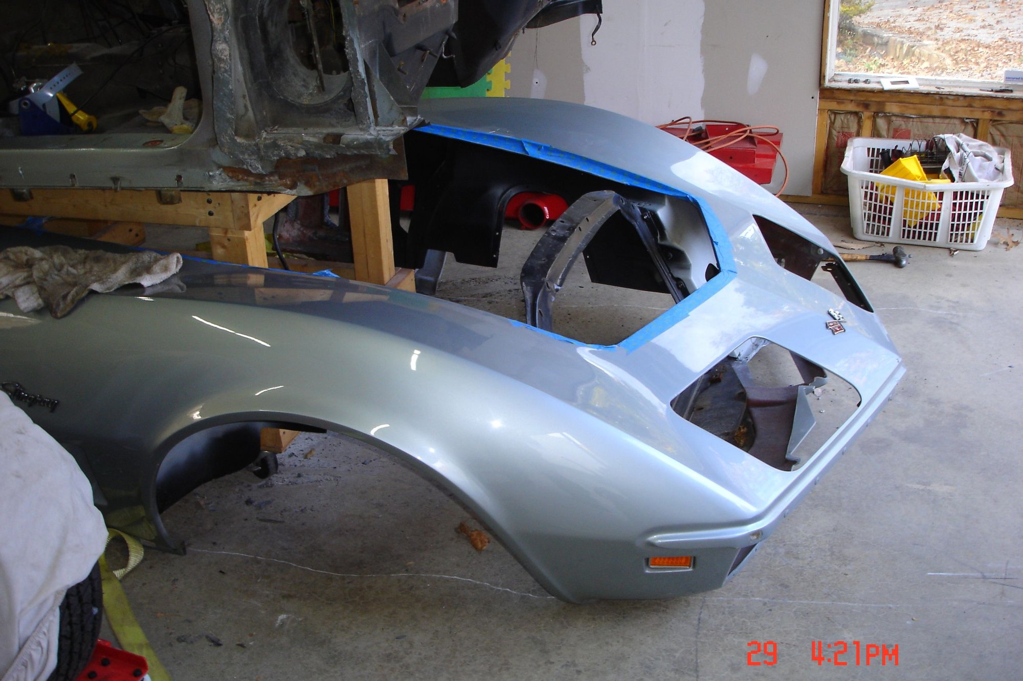

Not sure what you are asking. Installing a front clip or the one you are showing from CC. Anyway, is the damaged clip removed? maybe a picture so we can see. They do sell hood surrounds and side pieces also. Installing a front clip is pretty straight forward work. Prep the bonding areas from old adhesive, a good adhesive, and mocking up the fit to make sure of what things look like when you go to bond it. The one's I have done were by myself so I had to have everything in place first. Once you start the bonding process there's no turning back so mocking it up and checking the fit are paramount!
RVZIO
This was an Eckler front clip that I removed for an original GM clip.
Eckler clip removed.
GM clip being removed from a donor car.
GM clip removed and getting things removed for install.
Bonding areas prepped.
Other bonding areas to prep.
Mocking up the clip, which took me many tries to get right.
Completed car in a different color.
