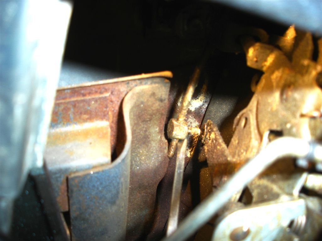

Originally Posted by Ilbtn18
if you are talking about the latch mechanism located on end of the door which basically clamps around a stud to keep door closed, im not sure how i would be able to get a pry bar in that area. only way to that mechanism would be between door and door jam, which is only small space around door.

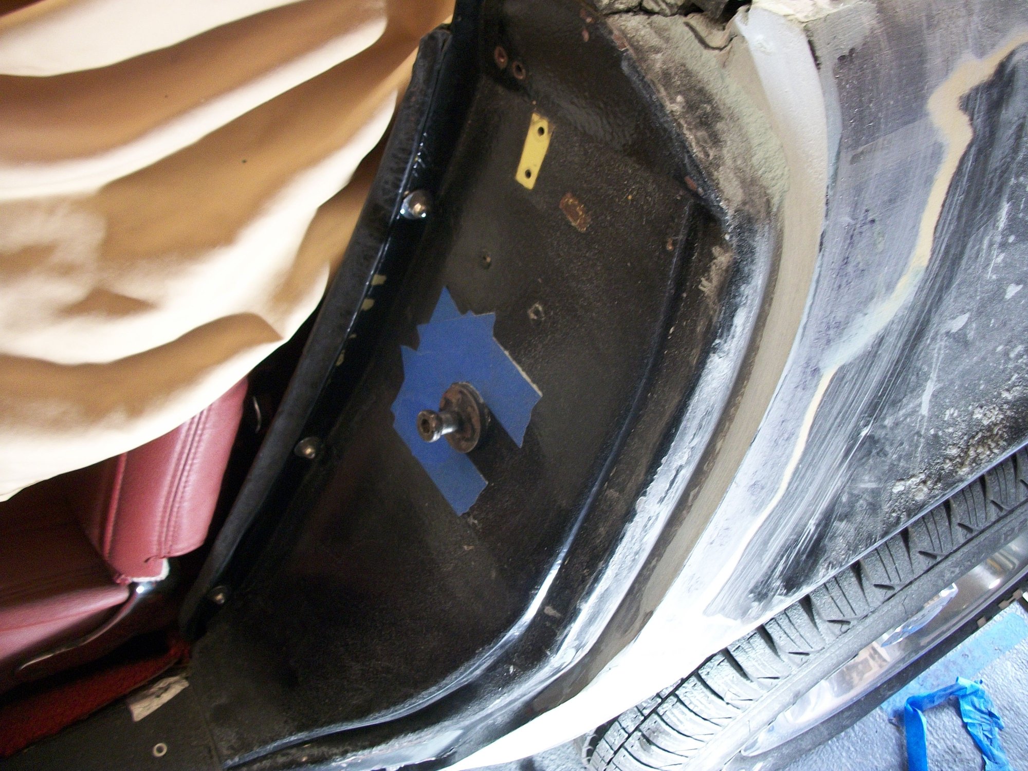

Your car probably doesn't have the small wedges.....and if it did you would have to be very careful when separating the two halves....the yellow area in the pic below shows where the wedge is located above the striker.....they may be for convertibles-only...….

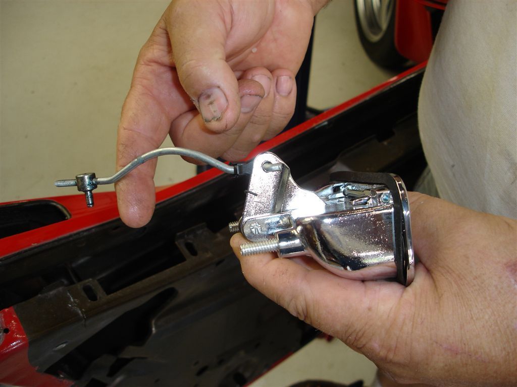

Old May 18, 2019 | 07:02 PM
Peterbuilt's Avatar
Peterbuilt
Joined: Aug 2006
Posts: 7,419
Likes: 1,555
From: mount holly NC
Default Hi and welcome!
If your door gets stuck again here is the part to push down on:
While the door panel is off make sure this is adjusted correctly:

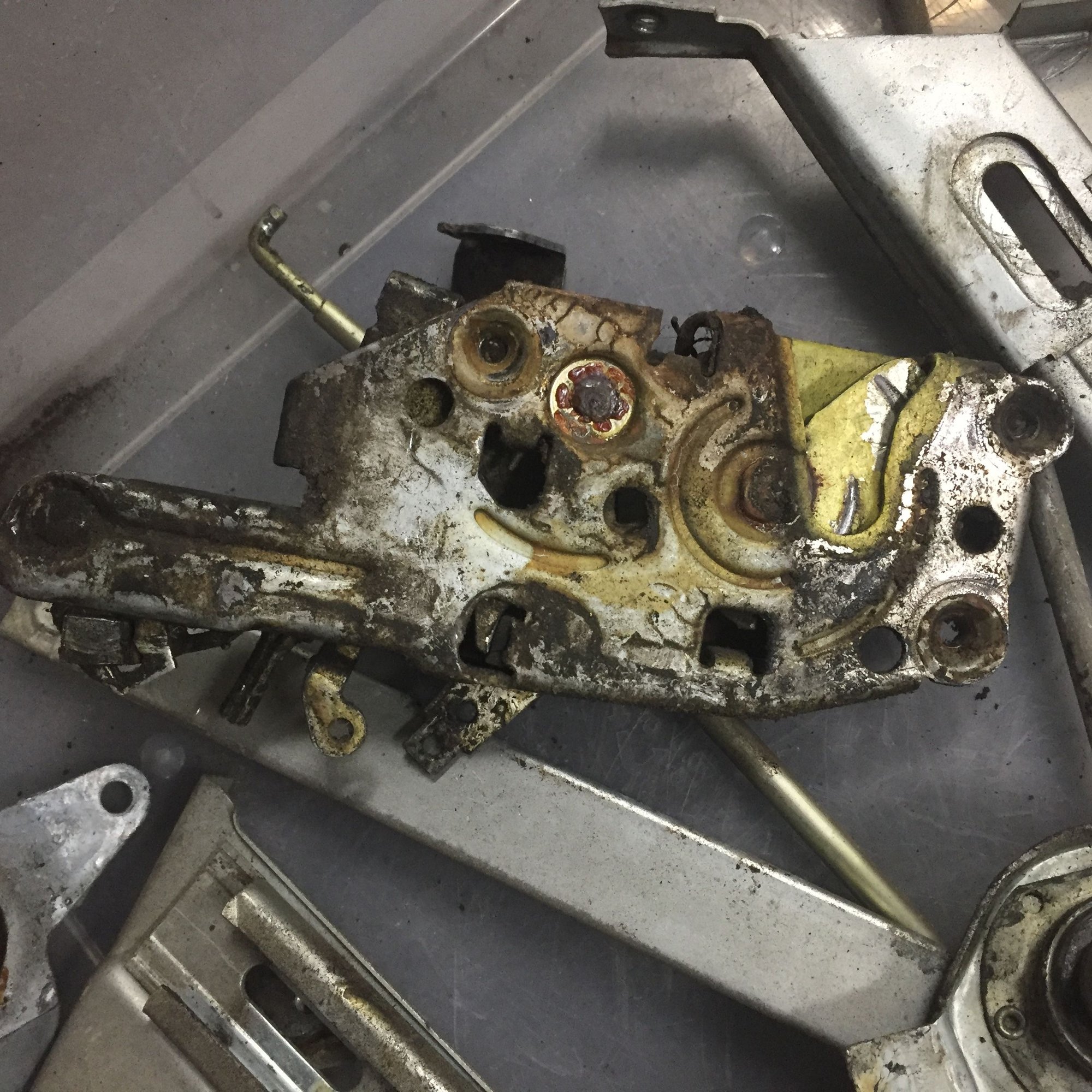

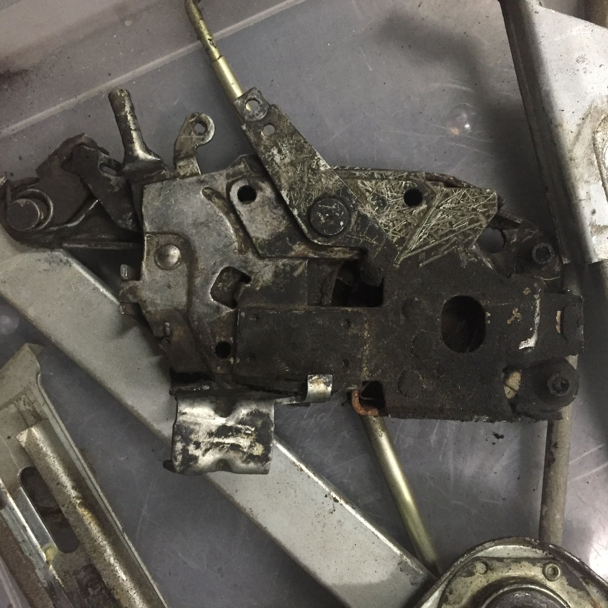

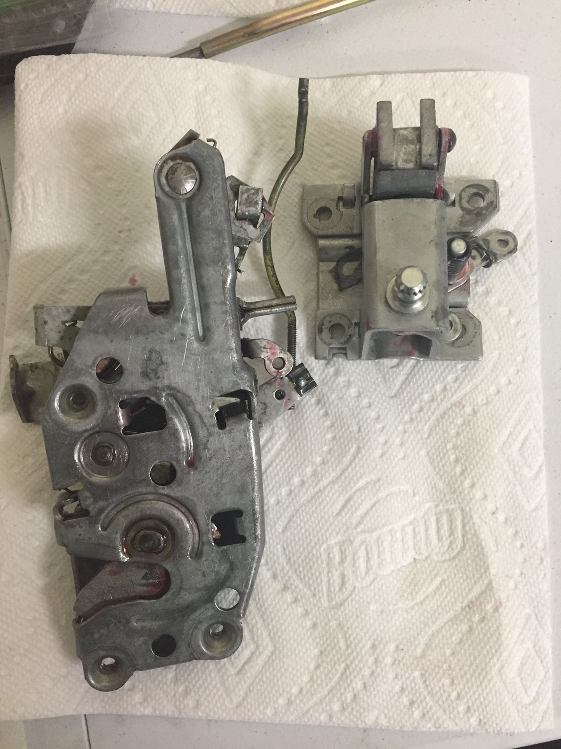

Old May 18, 2019 | 10:53 PM
Al.'s Avatar
Al.
Joined: Nov 2018
Posts: 107
Likes: 33
I highly suggest you take it apart and clean and adjust the entire locking mechanisms.
After 50 years the original grease has probably solidified and there is most likely dirt and grime that will just turn to mud with oiling it.
I just rebuilt locking and window mechanisms in my 69.
Im suprisee it even worked all as it was.
This is how my drivers side was
After cleaned and oiled.
