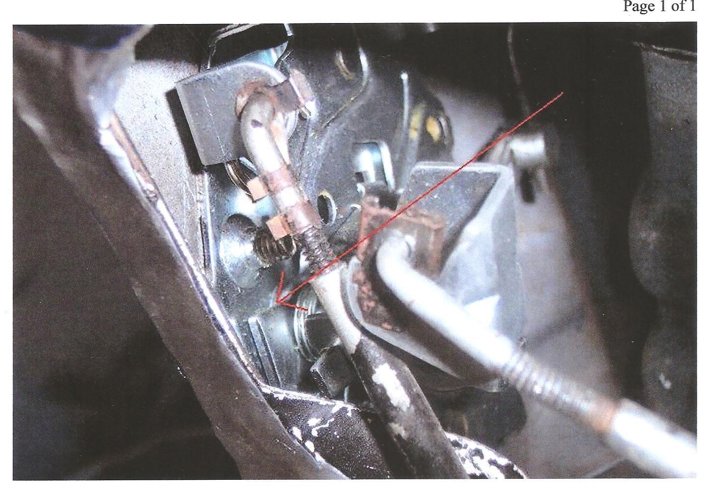

First read the discussion on “72 car door issues”, 5/18/2019. It talks about spraying WD 40 or some type of lubricant into the lock /strike mechanism from the top of the door with window rolled down. Use the small tube and a good light. Wait a day and stay again if you still can’t get the door open. The small inside **** & the key are connected to the lock/strike mechanism. Look very closely at the lock/strike mechanism on your passenger door, so that you will know where to spray. If the door fails to open, there are some instructions to push a lever on the lock/strike through the top of the door, utilizing a very long thin screw driver. Good Luck.

If your key does not work because the door is LOCKED then with the window down press down on this part:
To Lock is stuck
