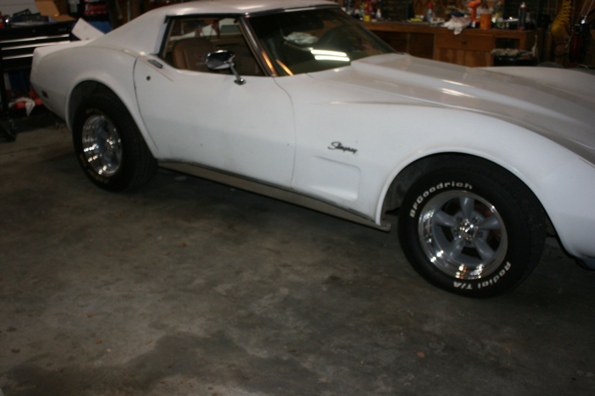

Not the greatest picture, but this is my 76 with American Torque Thrusts 225/60 15 on 15x7's in the front and 255/60 15's on 15x8's in the rear.
