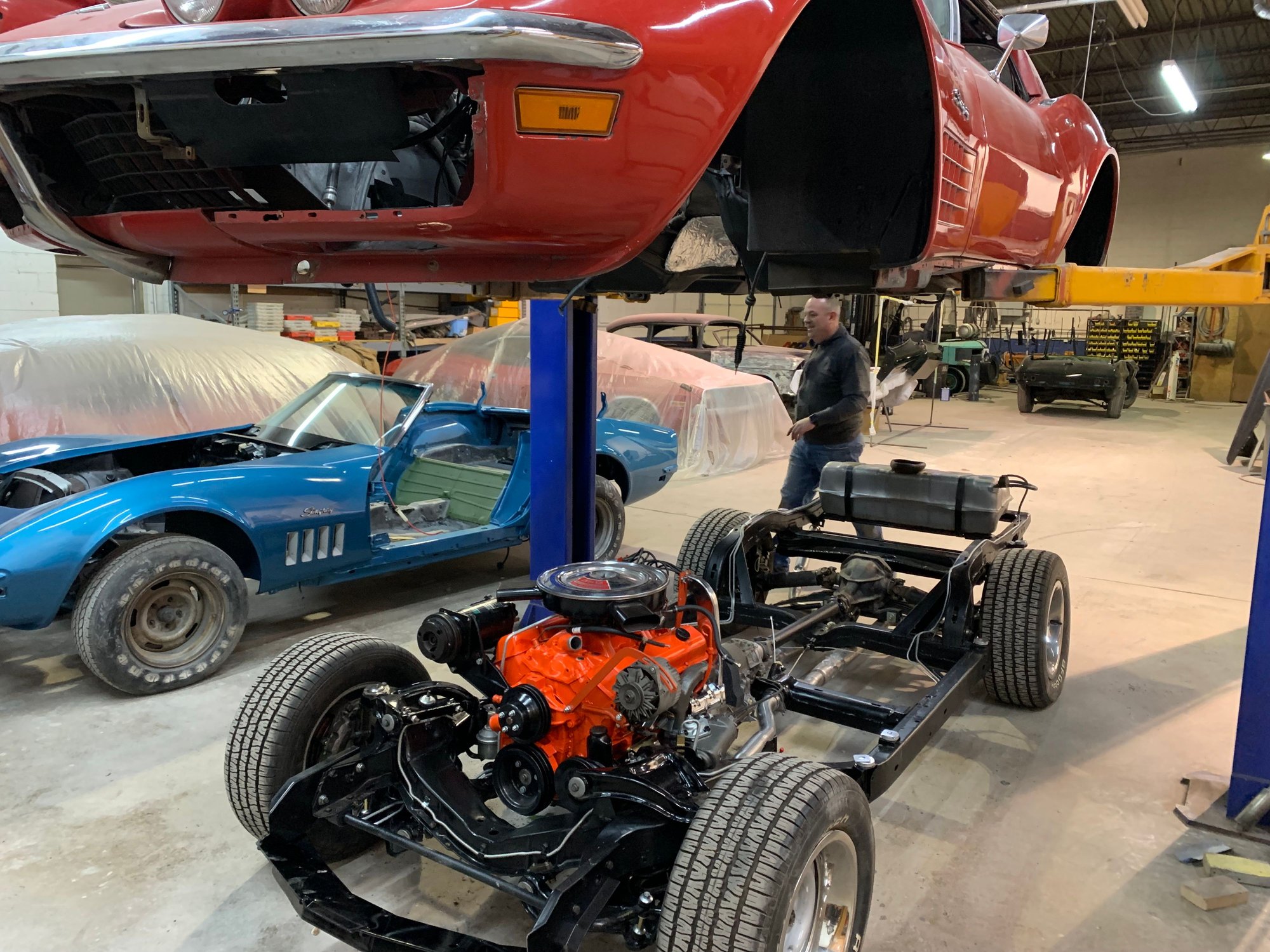

Below is some pictures of the build

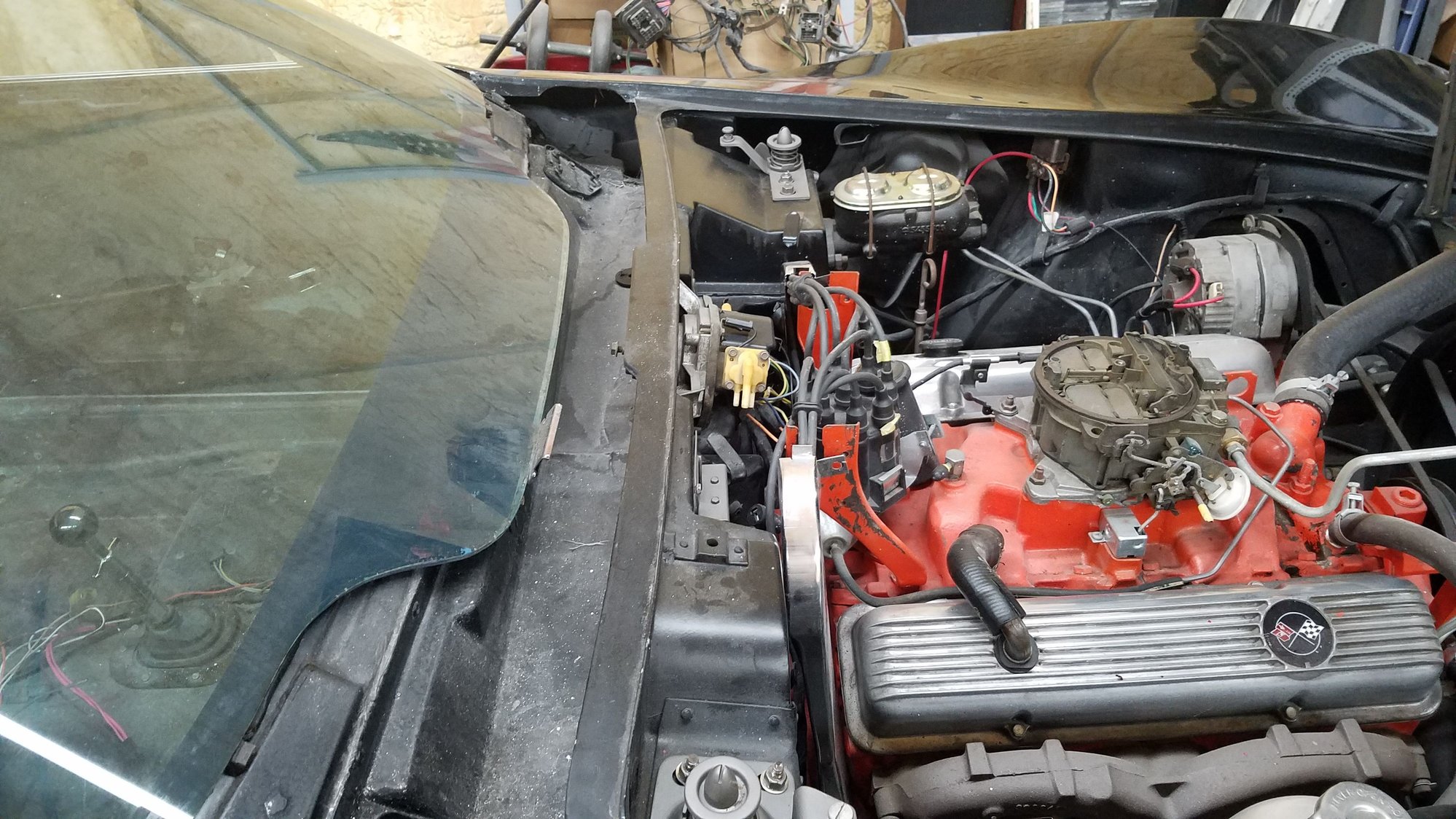

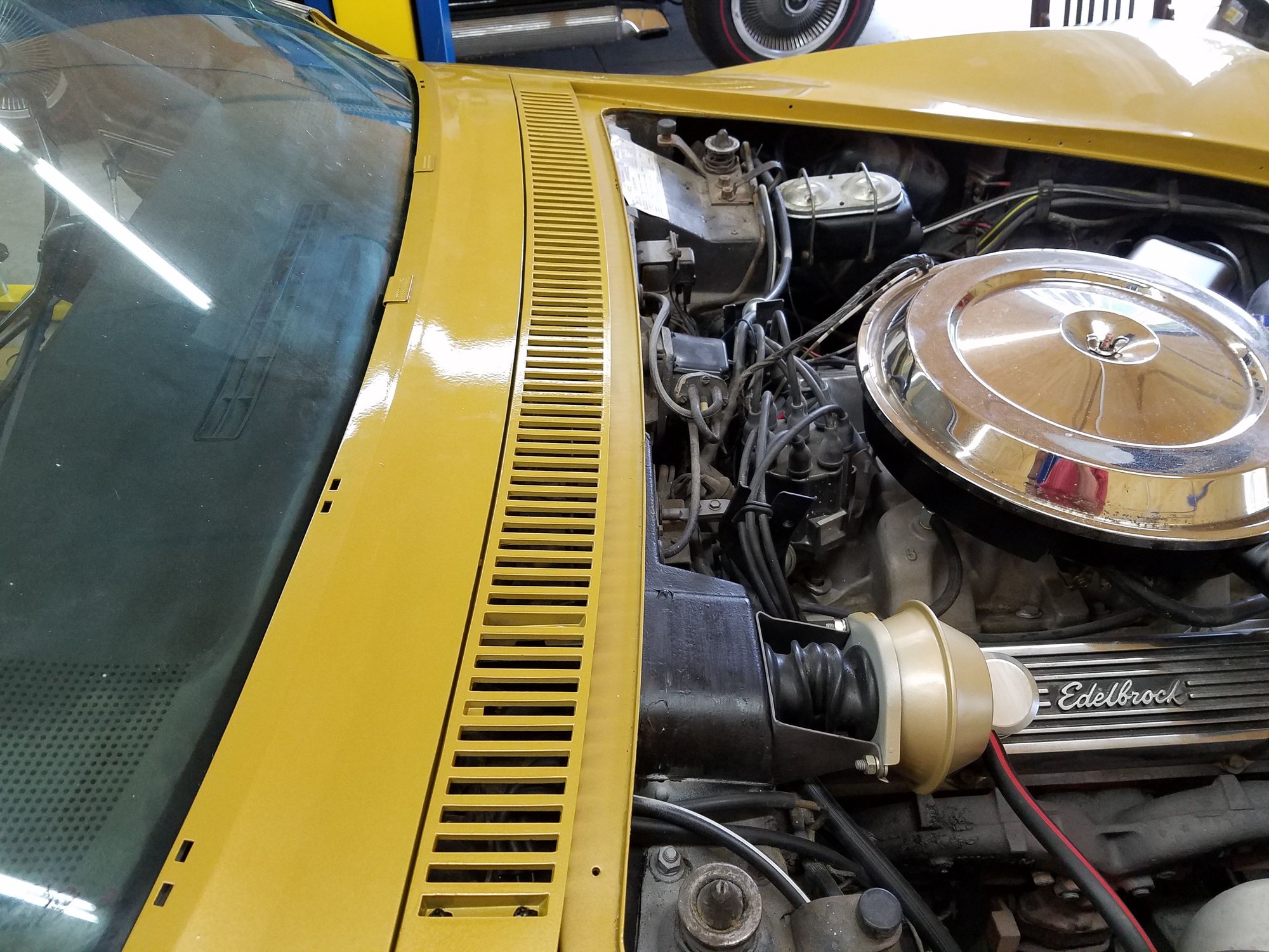

Looking at your picture I noticed the vac line on your distributor is before the bracket. I know GM made this adjustment in the AIM. So on my SB 69 I had to adjust it behind the orange bracket and move my plug wires over one. Not sure if that was still the case in 71.I'll check my pictures!
RVZIO
Vac line to distributor is behind bracket
71 Not sure it looks pretty even with bracket but line ran behind bracket.
