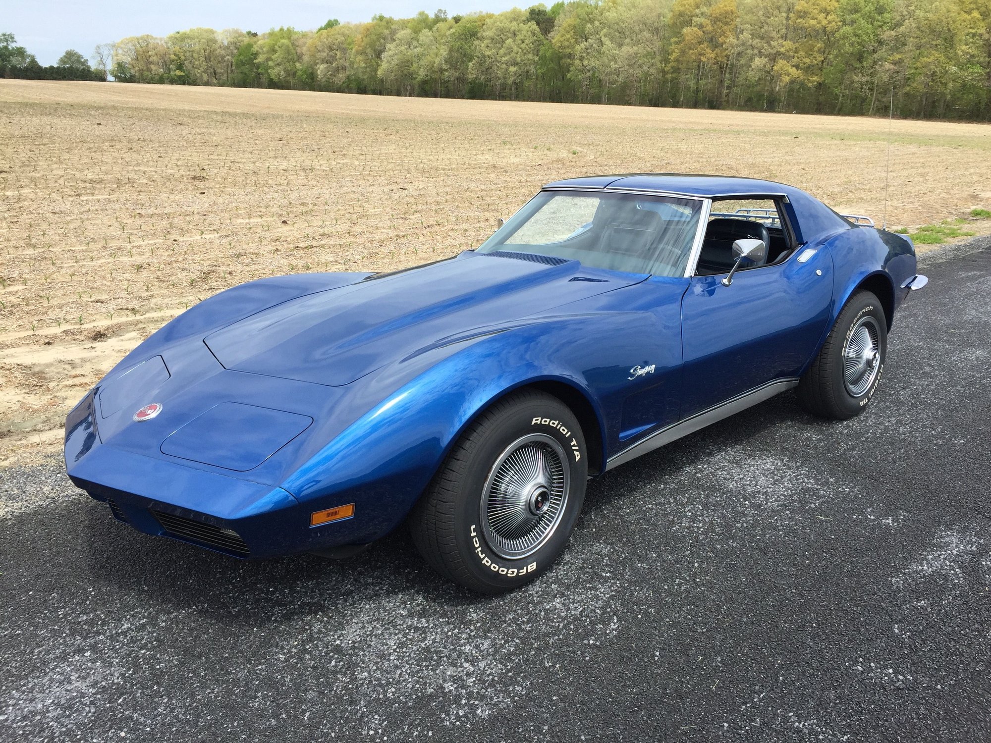

I agree with the 3 previous posters. I replaced the original bumper on my 73 with a fiberglass one from Willcox. I did the removal of the old one and and had a body shop paint and install the new one.

Did shop have to do any work to bumper or car to fit that well? Any close-ups of the line where bumper meets car?
I assume you are asking me. Very little work (just a little sanding) before installation. I guess I was lucky. The line is pretty tight; blow up the attached pic. Let me know if you need closeups.

Car looks good Fran!

the GM cover is still available,runs about 750,you have to search a lot of places,but you can still find them new in the box.Fran's car looks great with the fiberglass one though.i guess the dilemma is do you go with the GM original urethane which will do ok with a slight tap but have the wavy look after being on the car for a few years or go with the fiberglass for the perfect finished look and pray it does not get tapped.
