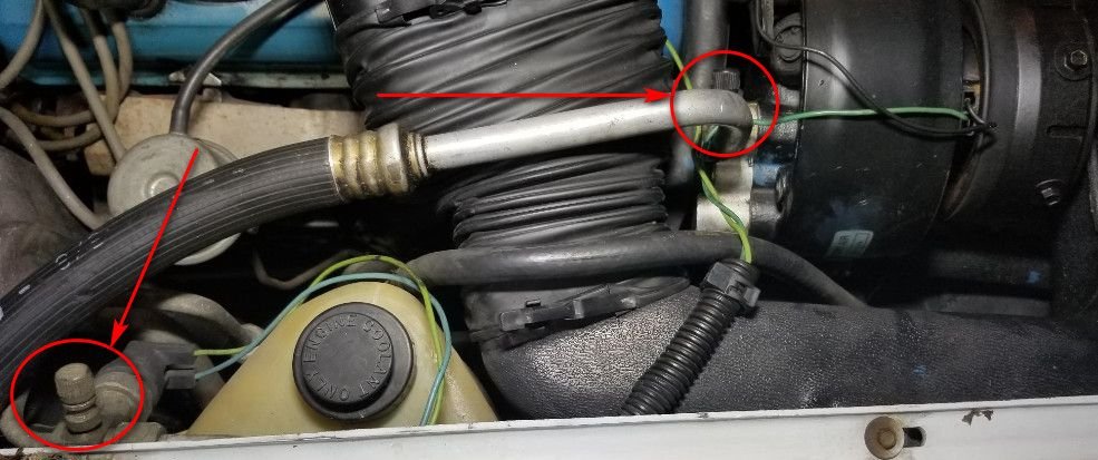

OK.. So my C3 may need some Freon. but I'm not sure what type to get. No stickers or id. The air is working but no longer cold, If anyone can help.... Not sure this picture will help...... Guess I'll be driving my C7 if I want air for now.

The fitting on the compressor is for R-12, check the fitting on the accumulator and high pressure line and see if they are the same screw on type. The R124 fittings are the push on quick connect type with no threads.

Bruiser... THANKS for the quick response...... Both connectors look to be the same... SO I'm assuming R-12.
Can I still by R-12? or what else can I uses?
