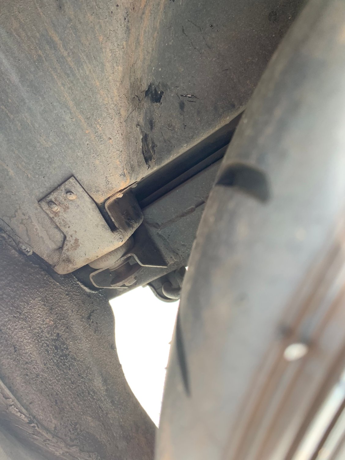

It’s behind the rear tire, which bushing is it? It looks like it needs replacing. Thanks.

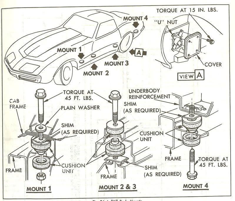

#4 body mounts.

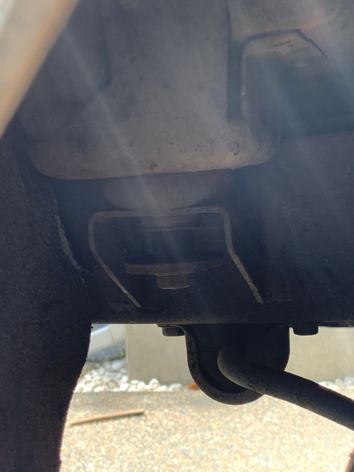

Ya you seem to be missing the lower rubber cushions.

Yup, number 4 body mount support bracket. They are kind of hard to replace because of the riveting process. Many will use screws or other means. Yours appear to be in great shape minus the lower bushing being gone.

I guess I overlooked those, i'll try to source the upper and lower bushings and replace them since most of the other ones were already done.
