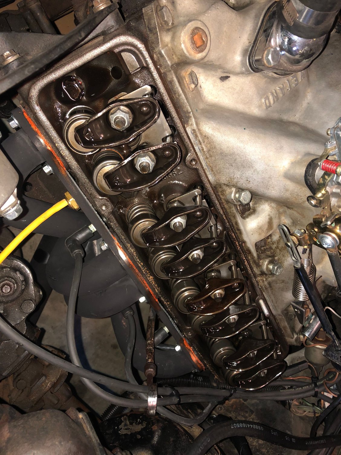

Pulled the covers. Everything looks and feels fine to me.

Does this look normal? I really don’t know much about valves and rockets but see on the left how that washer/retainer on the spring is sitting certain and flush? The one on the right almost looks like it’s sitting on top of where it needs to be.

the exhausts have rotators on top of the valves. intake do not.
