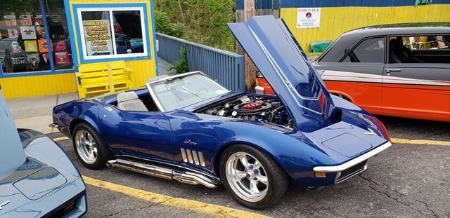

Has anyone run different size wheels (front and back) on their c3? I recently updated suspension with RideTech and can now fit a 10" wide 18" Torque Thrust II wheel on the rear. Appears that there is a much larger tire selection available for 18's. Any advise?

I have 17s up front and 18s in the rear. Run a 275 40 18 tire in the rear

Like Gordo, I need the added traction of a wider tire in the rear. Which is why I am considering the 18" diameter 10" wide TT2 in addition to better tire selection. Looking at the Nitto NT05, It sounds like a drag tire. I would like a tires more for track use like Michelin Pilot SS on my 2015 Z06, but they aren't made for the C3 wheel sizes that I am looking for. As you guys probably know, the RideTech suspension has offset trailing arms that allow an additional 2" rear wheel size. TT2's come in 17"x9.5"wide or 18"x10"wide configurations. So there is my dilemma, What's the best course of action to take advantage of the 750 hp Dart engine and the RideTech suspension now in the Blue 69.
