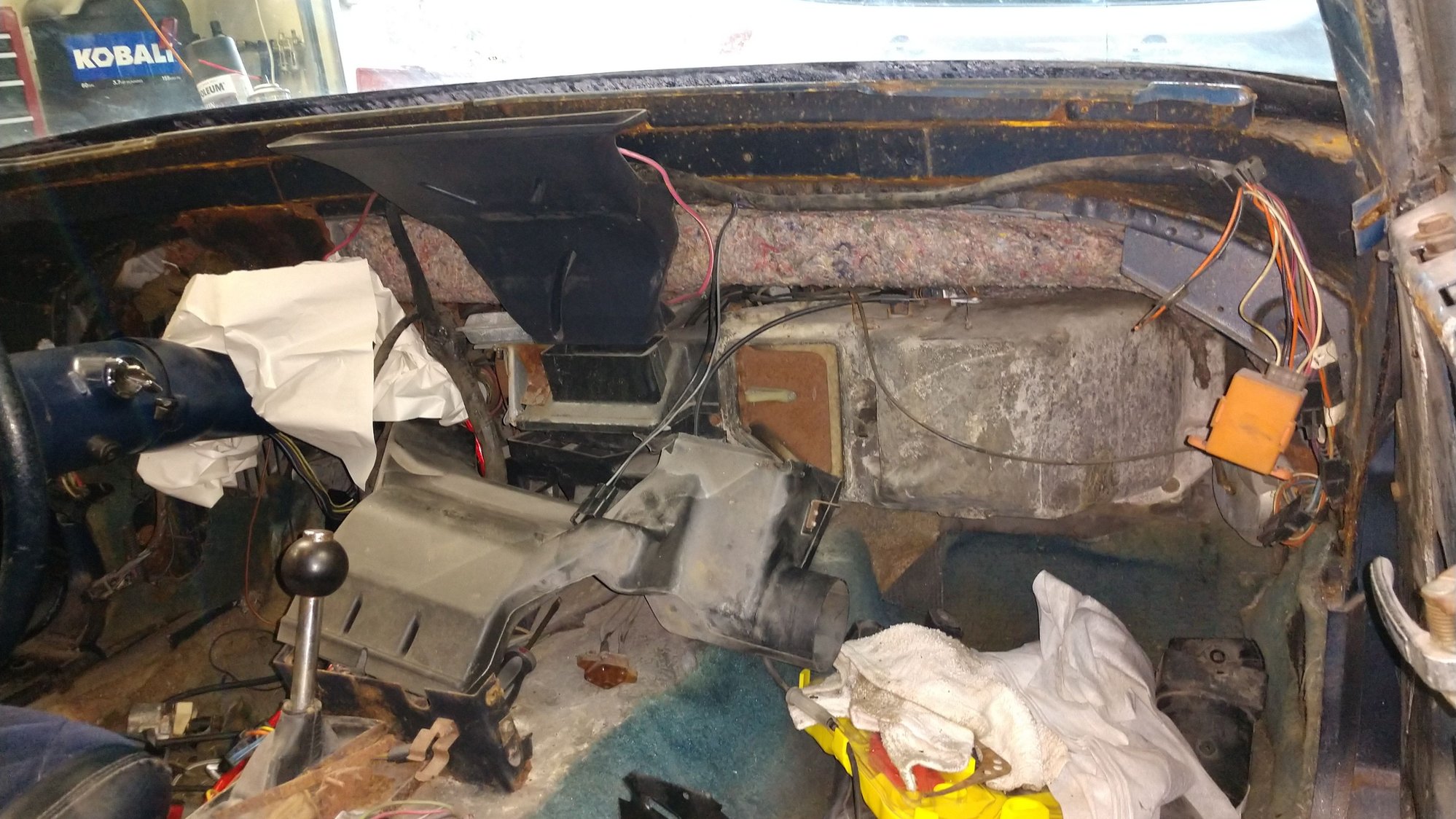

There are two retainer clips that hold the dash in place, remove the screws for the clips. Hopefully the following pic will help, see item #5.
I did have my steering column removed when I pulled my dash.

Thanks for the tips. Got the dash out. Driver's side had a bad crack already so hopefully I can repair it decently. Plan to fix cracks and recover with vinyl and dye to match and maybe some year down the road replace with a new one when the windshield comes out, but for now this will have to do.
