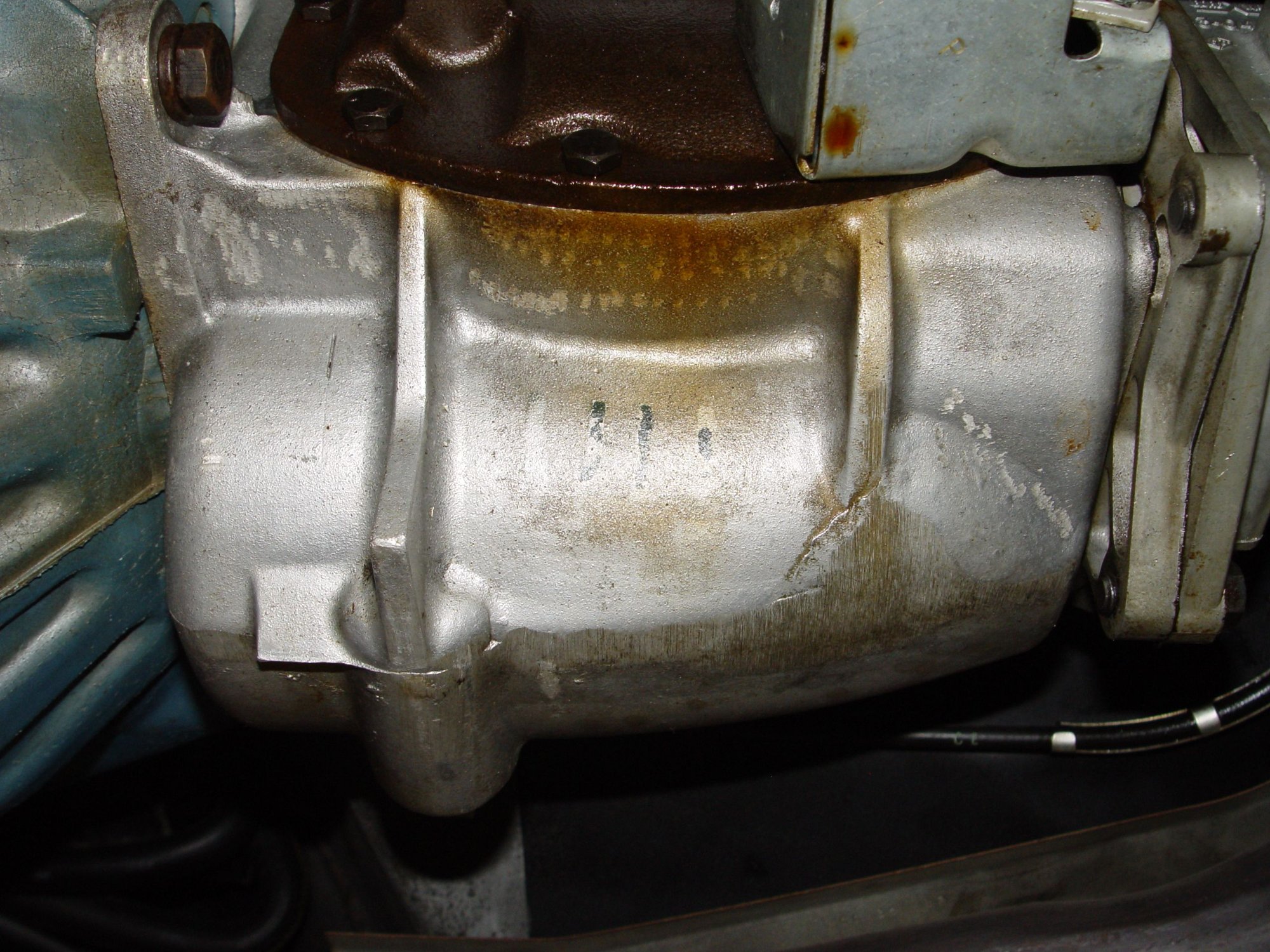

Here's a photo of what to look for. This is from a 1979 March/April car. This 79 has an L82 M20 and you can see part of the green stamp and outline of the UH code
Just checked the 1973-74 NCRS technical manual and the Muncies did use the A,B in the assembly/date code while B/W used digits. 1973-74 last year for Muncie and first year for B/W.
Last edited by hunt4cleanair; Jul 5, 2019 at 12:02 PM. Reason: clarify letters/digits on assembly date code

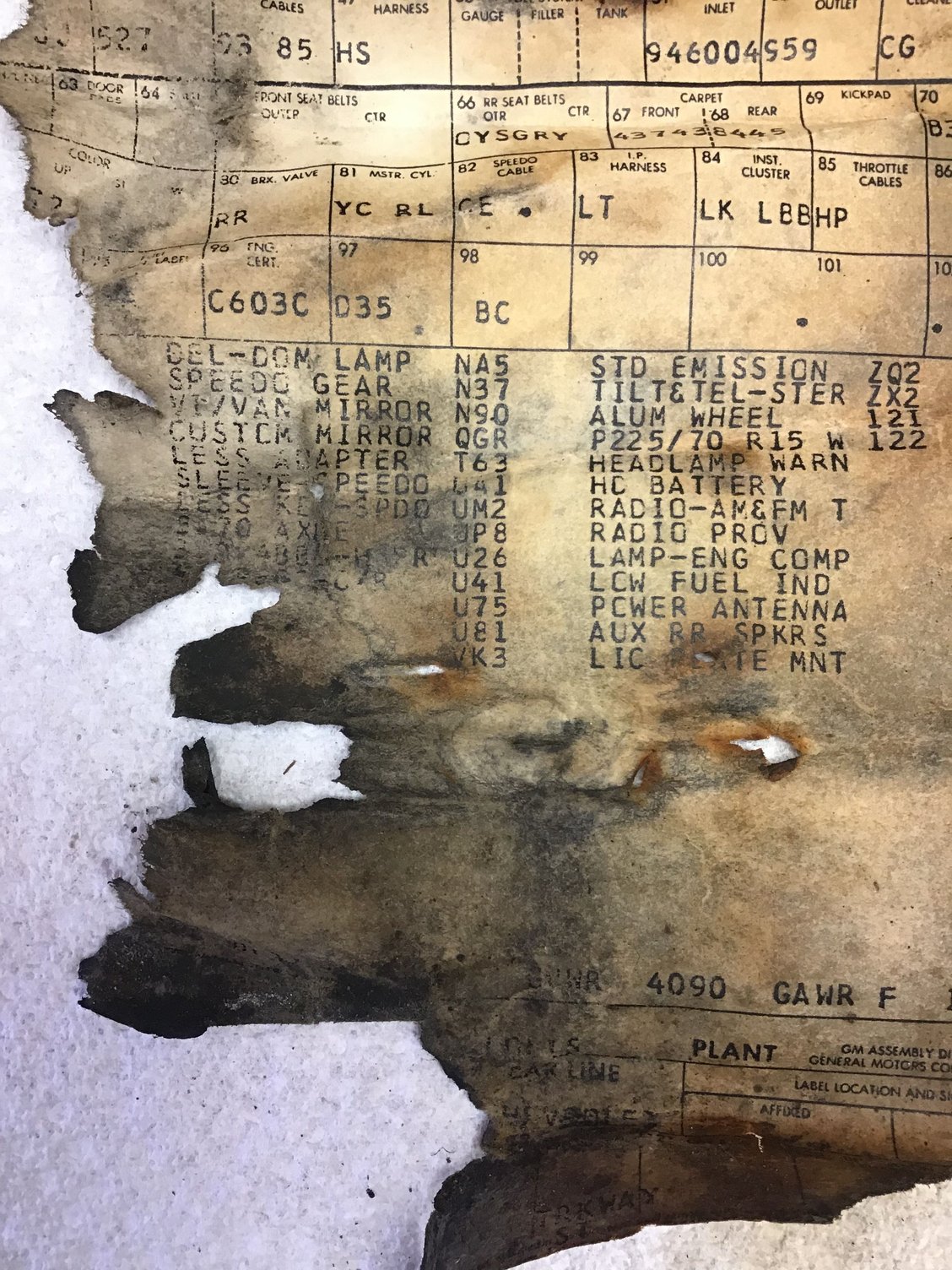

any thoughts what mine is?
cannot find ant codes above, 79 L82

Let us try to determine which you have; close-ratio or wide-ratio 4-speed?
We really need to see the column to the left of your tank sticker remnant, shown in your pic above (post #12), which would show the transmission installed. Unfortunately, nature has long ago destroyed that portion of your sticker.
Significantly, though, I can barely see that your car had the 3.70 rear axle installed, as most L82 cars did. That doesn't answer your question, but if your sticker showed 3.36 rear axle, we could conclude your car had the wide-ratio 4-speed installed at the factory.
Noteworthy, according to Chevrolet records, 428 of the L82 buyers opted for both the wide-ratio 4-speed AND the 3.36 rear axle. In your case, we must continue our effort to answer your question.
Looking at your undercarriage pics, your transmission case no longer has the ink stamp (broadcast code) showing close or wide-ratio, as is explained, with an example shown, in post #8 above. With the gearbox installed, that is the only visible marking GM utilized to indicate close- or wide-ratio. That code was very helpful for assembly workers at the time, but my ink stamp is long gone as well. Thank you, hunt4cleanair for that pic. I wondered what that stamp might have looked like.
If you ever remove your 4-speed, the input spline would, I believe, have 2 rings around it to indicate a close-ratio unit.
Arguably, the most practical way to answer your question is by testing its function by following a simple procedure like the one I provide below. Such a test does require you to have a reasonably accurate speedometer and tachometer. I am also assuming you still have your 3.70 rear axle and still running about a 27.5 inch diameter (225/70-15) tire. Both are indicated on your tank sticker.
Drive out onto a highway, preferably with little traffic, and bring the car up to 70 mph, shift into fourth gear, and hold that speed while noting your RPM. Your tachometer should be reading about 3100-3200. This is true for either close- or wide-ratio boxes because fourth gear is the same for both; direct drive (1:1).
Note: If you are running at, say, 2900 RPM, then something is a bit off—but that's no problem—just adjust all numbers below down by about 200 RPM. It is the relative difference that is important here, as we shall see.
While holding that 70 mph speed, downshift to third gear, and note the increase in RPM. If you are now at about 3900-4000 RPM, then you have the close-ratio M21 transmission (due to the 1.23 third gear). If, instead, your engine is now running about 4200-4300 RPM, then you have the wide-ratio gearbox (due to the 1.34 third gear).

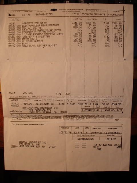

For $50 you can find out what was in there when it was made. I assume your partial vin is on your Borg Warner? since you are not the original owner it could have been changed but the odds I think are in your favor of being unmolested.
Contact GM Heritage for a copy of the invoice. It will look similar to mine:

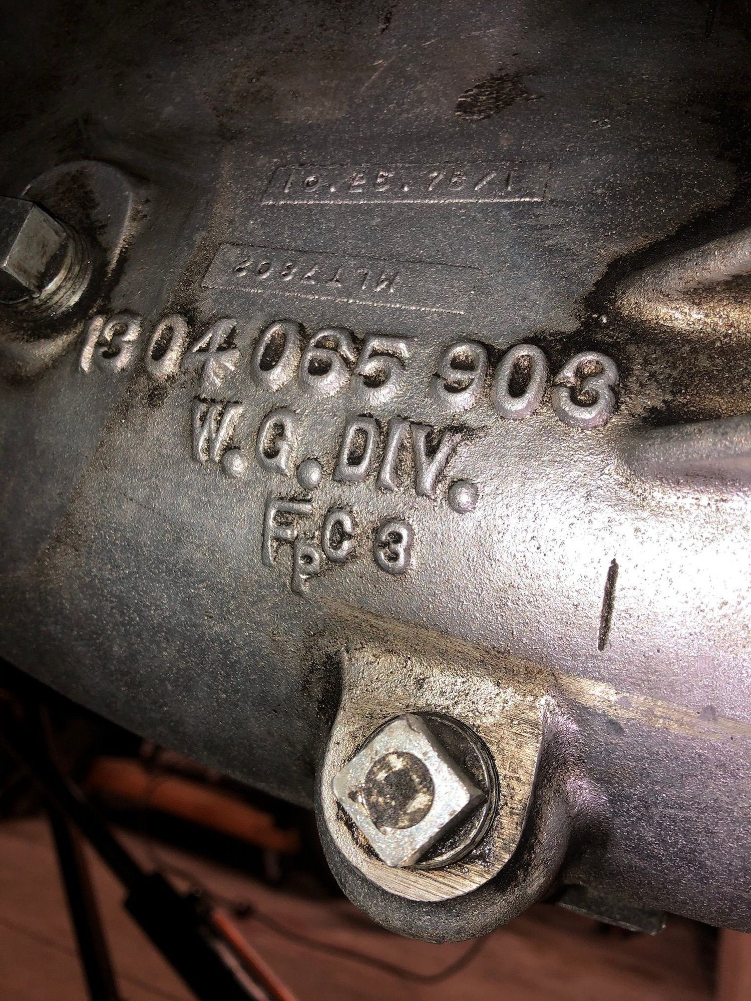

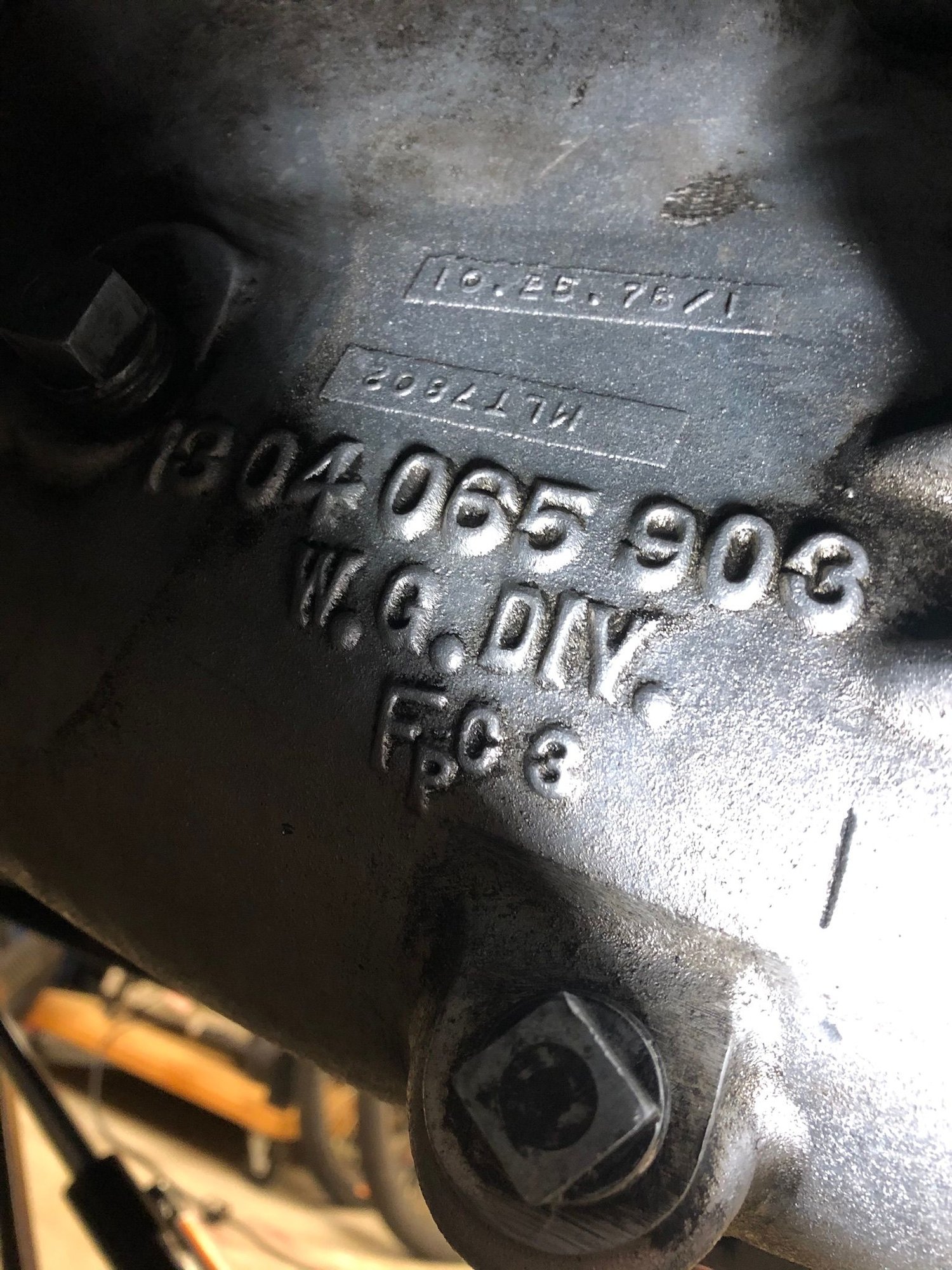

And here is where the build date of the transmission is and the partial vin:

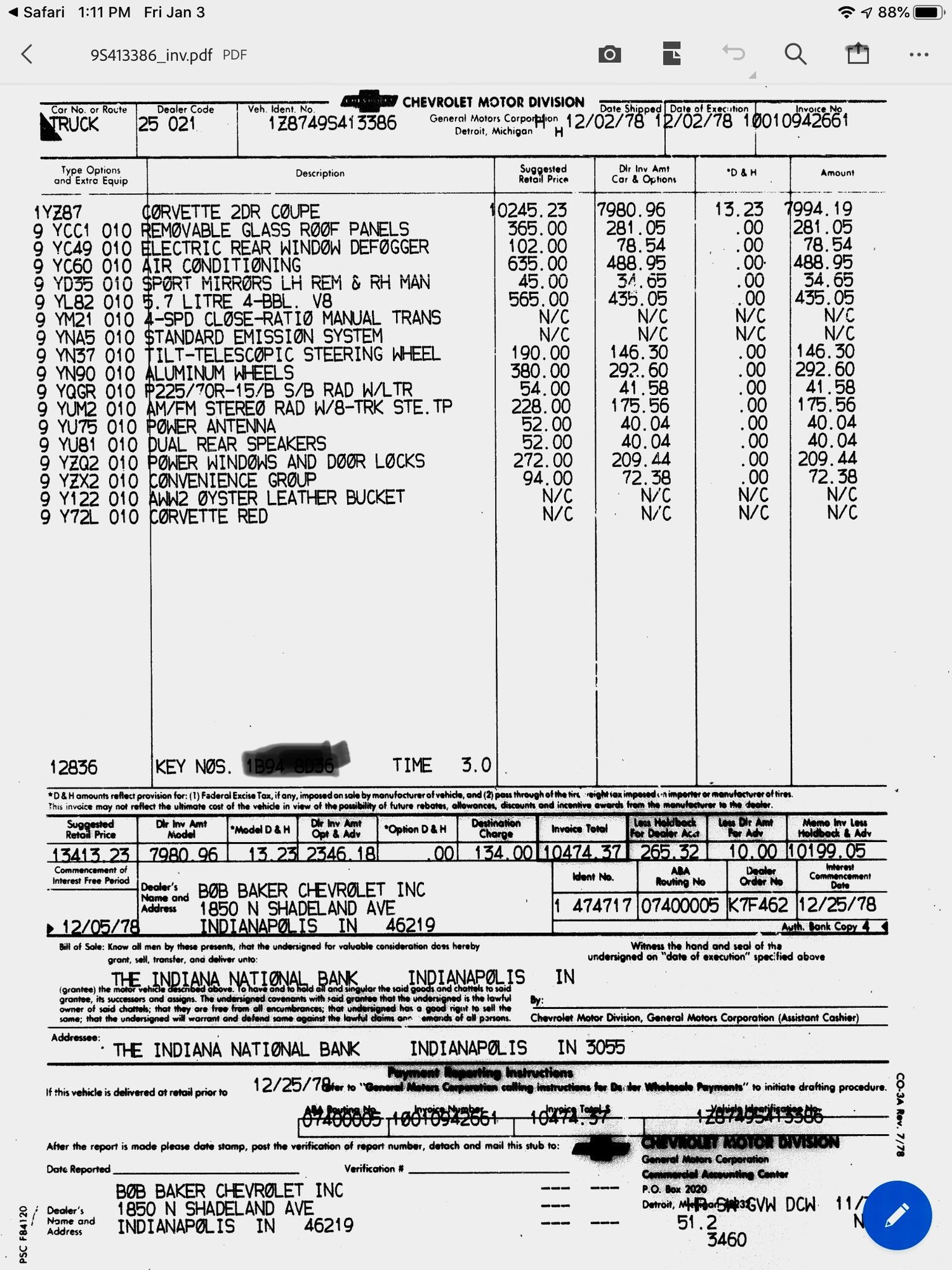

Default I got my invoice! Close ratio and confirm history
Originally Posted by karol
You want the invoice.
Can't get the build sheet that I know of.
thank you for this resource..it took about 24 hours for them to take my fifty bucks..
it confirmed all my options..confirmed i have close ratio transmission...confirmed me as second owner story from original owner indianapolis and i have about 30600 miles from summer purchase at 28900 original miles..it adds up..happy camper, ..
here it is!
also makes sense why i have 78 interior color for a 79..very early build
