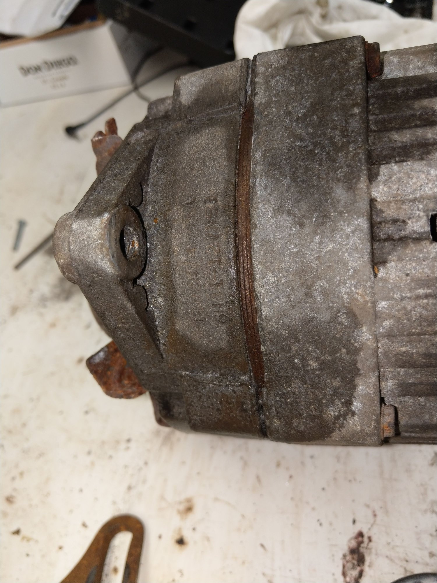

This alternator says 1102474 61 A 6H31-12V NEO. Does that make it an August of 76 61A alternator?

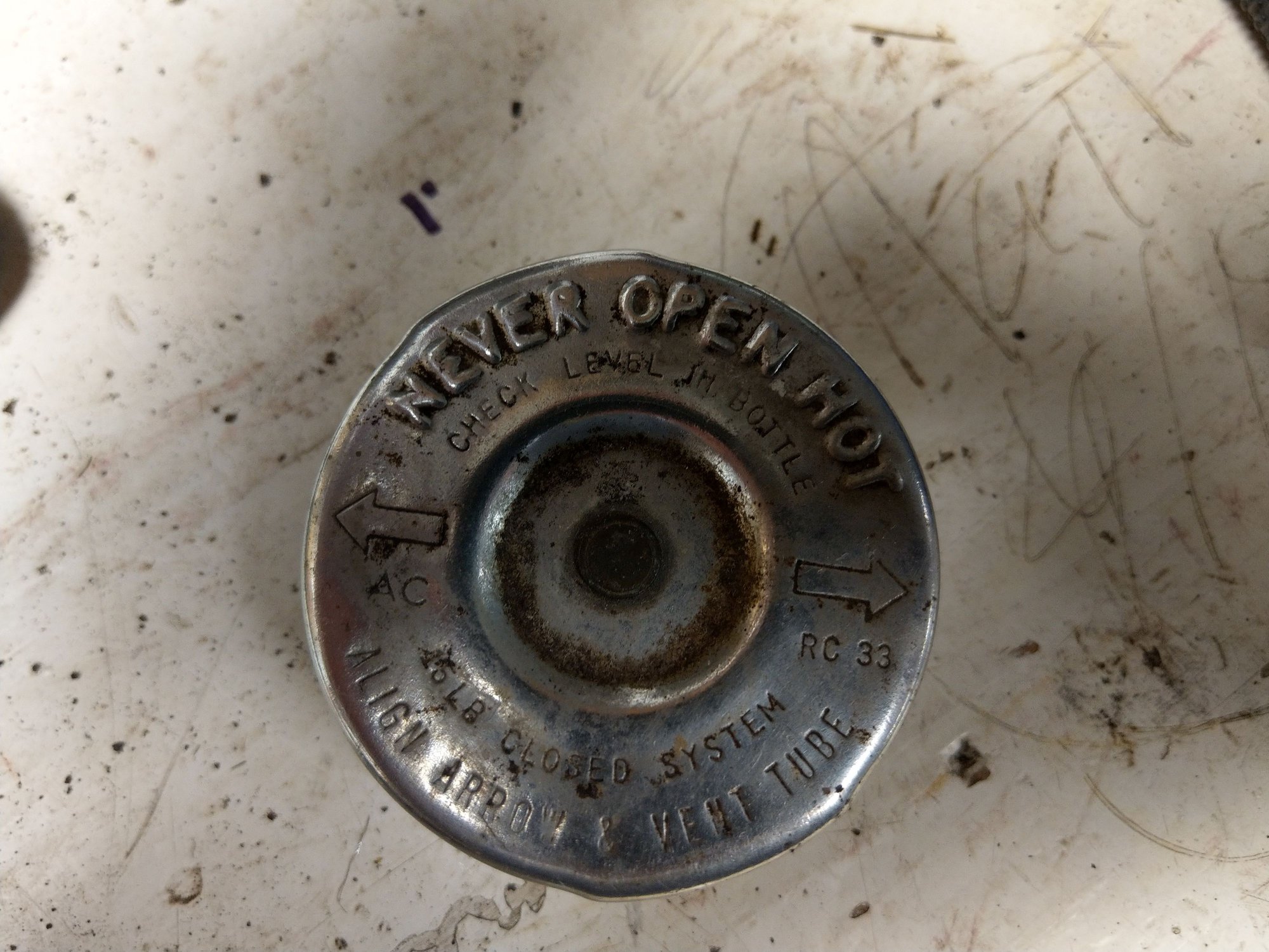

IS the a 73-82 radiator cap for an AC car? It does say rc33 on it. Wondering if it has any value for anyone if it is?

Alternator is a 76 build - August 31st, 1976. The 1102474 was used for several years - 1975, 1976, 1977, 1979 and 1980. That date could be for an early build 77 Corvette.
