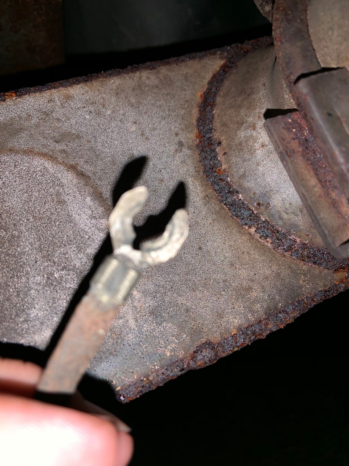

Lots of info to read, I pulled the car out and like under the rear by the antenna I noticed a ground strap not connected to anything. The wiring harness is connected to the frame, grounding strap from the antenna is connected at the same point and another strap connected at the same frame point but doesn’t go anywhere.

Ohm's, Relay's you guys are speaking German to me. Am I going to have to buy an electricity for dummies book ? If I remember correctly I do believe the headlight switch connector might have had a slight melted plastic but I can't remember exactly.
I will start by cleaning the back connector, I would love to know where that second strap goes, I'm guessing the exhaust clamp? does that even make sense?
The exhaust clamp, no, any other metal yes.
You might want to look into something like this https://www.corvettemods.com/C3-Corv...s_p_16146.html
Thanks for the reply, that strap in the picture is connected at the frame ground in the rear, there are two straps back there, One strap goes from the frame to the antenna this one goes no where, but it appears that it was connected somewhere.the only other connection back there is the wiring harness for the lights connected at the same point on the frame.

If you have an alarm horn mount it there.
Old Jul 21, 2019 | 09:30 PM
Tooonz's Avatar
Tooonz
Joined: Oct 2013
Posts: 992
Likes: 28
From: Sutton MA
This is in the rear by the antenna, I do not have an alarm horn.
Old Jul 21, 2019 | 09:35 PM
ntfday's Avatar
ntfday
Veteran: Marine Corps
Joined: Mar 2013
Posts: 750
Likes: 180
From: Springfield Missouri
It could be an extra put on at the factory, but I would try to find an attachment point on something metal. You can't have too many grounds especially on a Corvette
