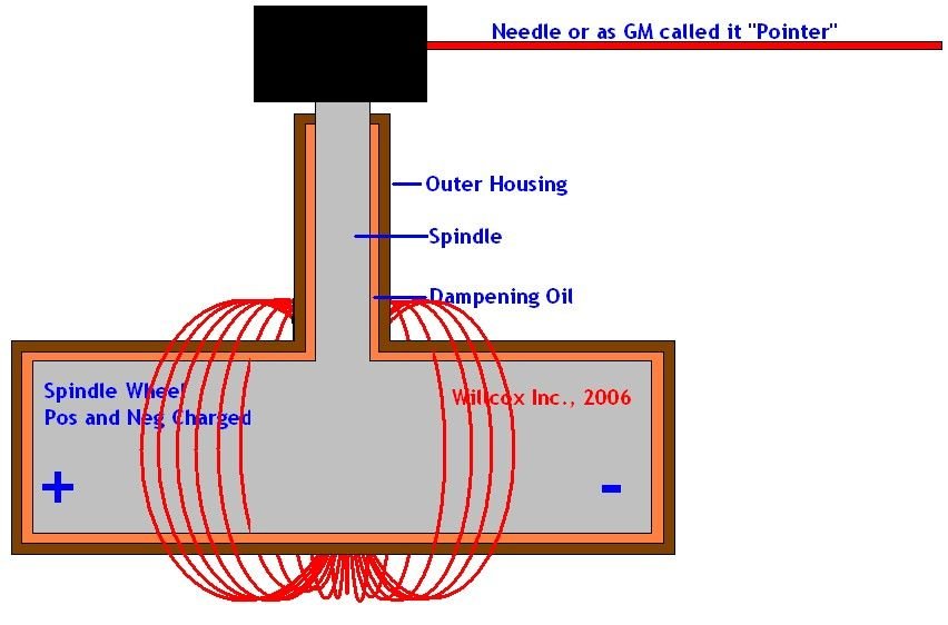

I went through this same issue a couple years ago. There is a dampening fluid in the gauge that slows the movement of the needle, (According to Wilcox)and over time this fluid dries out, leaks out, whatever. When this happens the needle follows the sloshing in the tank as it happens. It is normal to see movement under cornering, acceleration, and braking but not rapid movement normally. You need a new gauge or have yours rebuilt.

The resistor isn't the issue, in most cases this issue is caused due to the fluid missing from the gauge. You can put a cap on the ohms wire on the gauge to slow down the reading but it's a royal pain to do this and it's probably cheaper to just replace the gauge.
