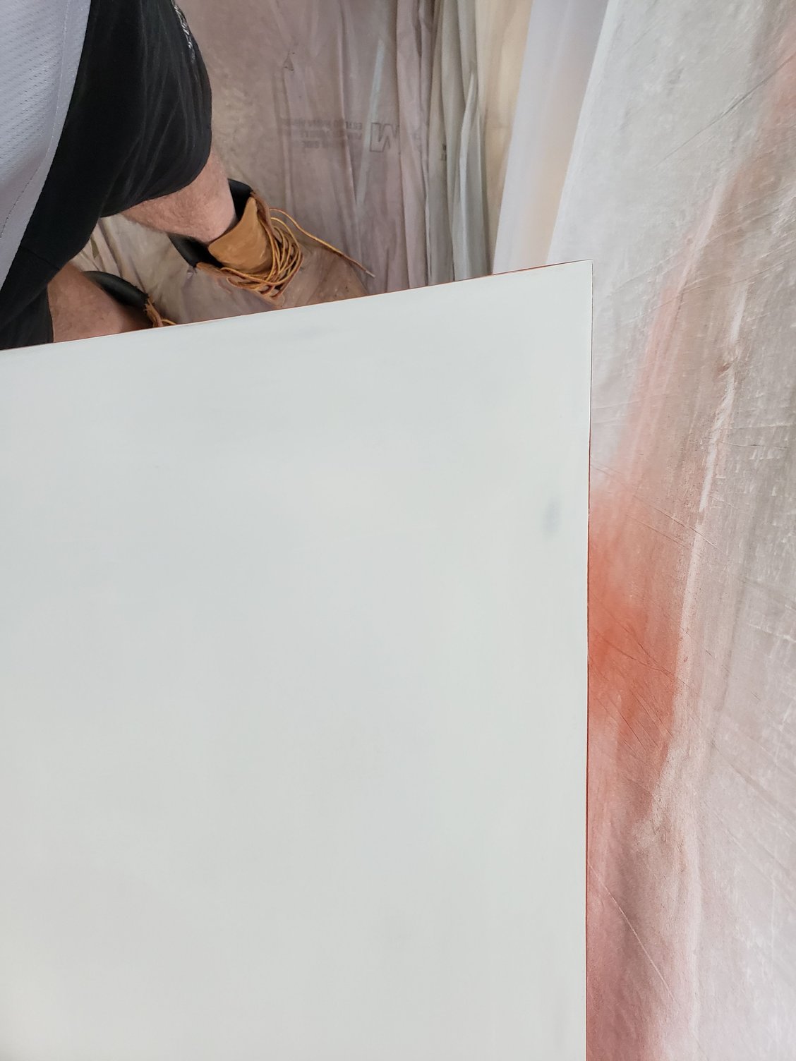

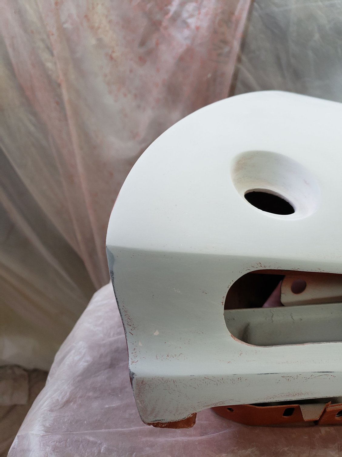

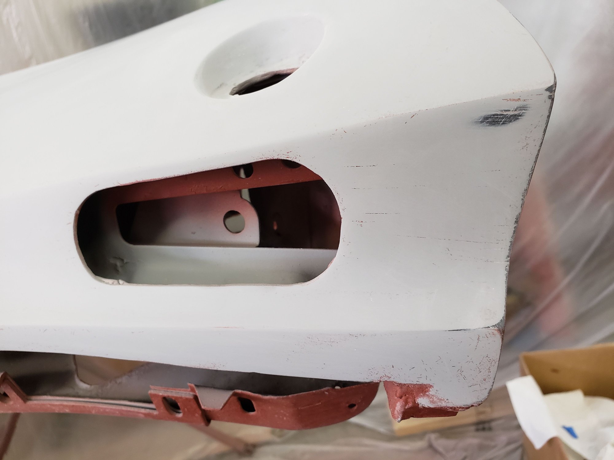

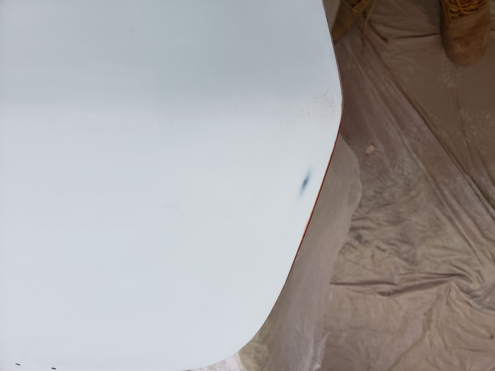

Here's a couple pictures of my sand through. I will reprime and sand with 400 grit and taper the edges. I'll seal the complete car and go to base, clear.
