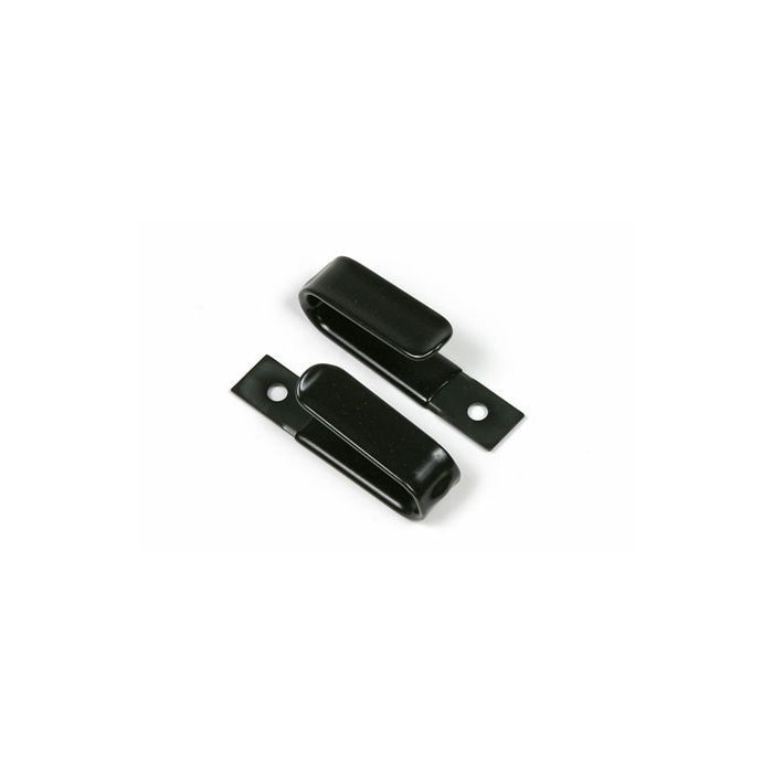

Are there two of these retainers on the dash harness? One on the speedo and one on the tach? I don't have a reference since our '77 was so butchered up and our AIM doesn't show this clearly.

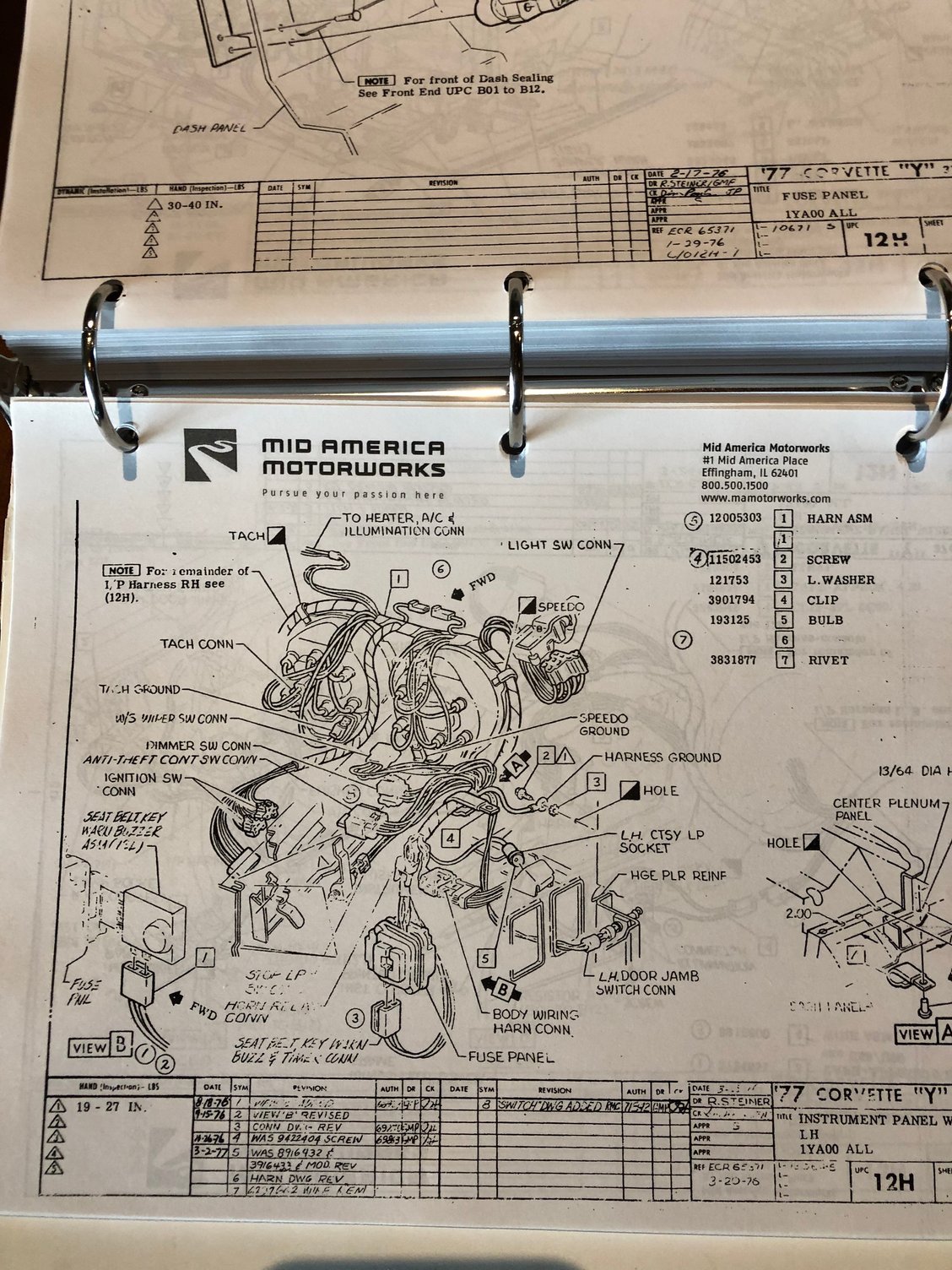

Old Aug 3, 2019 | 10:23 AM
sullyman56's Avatar
sullyman56
Joined: Nov 2013
Posts: 1,547
Likes: 282
From: Scottsdale Arizona
This is from my 77 AIM. It shows the location of the clips on the speedometer and tach.

Old Aug 3, 2019 | 12:15 PM
AdamMeh's Avatar
AdamMeh
Joined: Sep 2011
Posts: 3,372
Likes: 215
From: Peoria Arizona
Awesome - thanks for the replies! My AIM doesn't have a clean scan of that page, so I couldn't really see the tach side clip. Looks like it's a single clip on the top, outside screw on each side which makes sense to hold the harness in position over the gauges.
