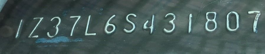

VIN #
Trim Tag
Hello All:
New to the Forum. I thought I would start small. I'm looking to buy some touch up paint for a 1976 C3 Corvette. From the Body paint, and Trim Tag & VIN # I believe the paint colour is Mahagony Metallic code. Would anyone know a good website for touch up Paint ?
Tks,
Myles

Isnt your car bright blue?
rivet shows blue and your paint code..
