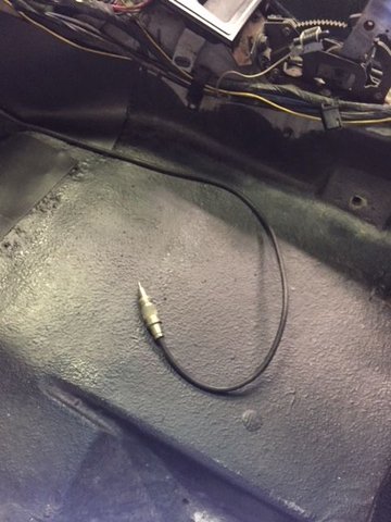

Could someone tell me where this cable goes, when I got the car all the interior was removed. I am getting ready to put carpet in and cannot find the other end of it. The car is a 1980 4 speed.

Looks like the antenna cable. That end should plug into the radio.

The one coming off the radio is running down pass side of the console.

Originally Posted by 1tazz
How about a better pic of the business end?

Mike I will get one later today when I get home .

Looks like a leftover CB radio connection maybe? Sometimes the antennas were mounted in the front hood edge area.

It's the CB antenna cable.
The single cable from the original CB/radio antenna runs to a signal splitter behind the driver side rear compartment trim panel. From there two cables run to the radio/CB head unit.

Guys you where right , I spoke with the Org owners son and he told me his mother was in a corvette club and they used CB when they where on cruises. No cell phones back in the day. So it is a CB lead.
That IS the FACTORY CB cable that came only with the very expensive CB option radios of the era. It came ONLY with a special power antenna that you can identify by a pale green node near the top of the antenna mast.

The car has a stock am/fm cassette radio.
interesting because that's in the same place and looks just like the factory cable. I guess the end connection for car CB antennae was standard.
