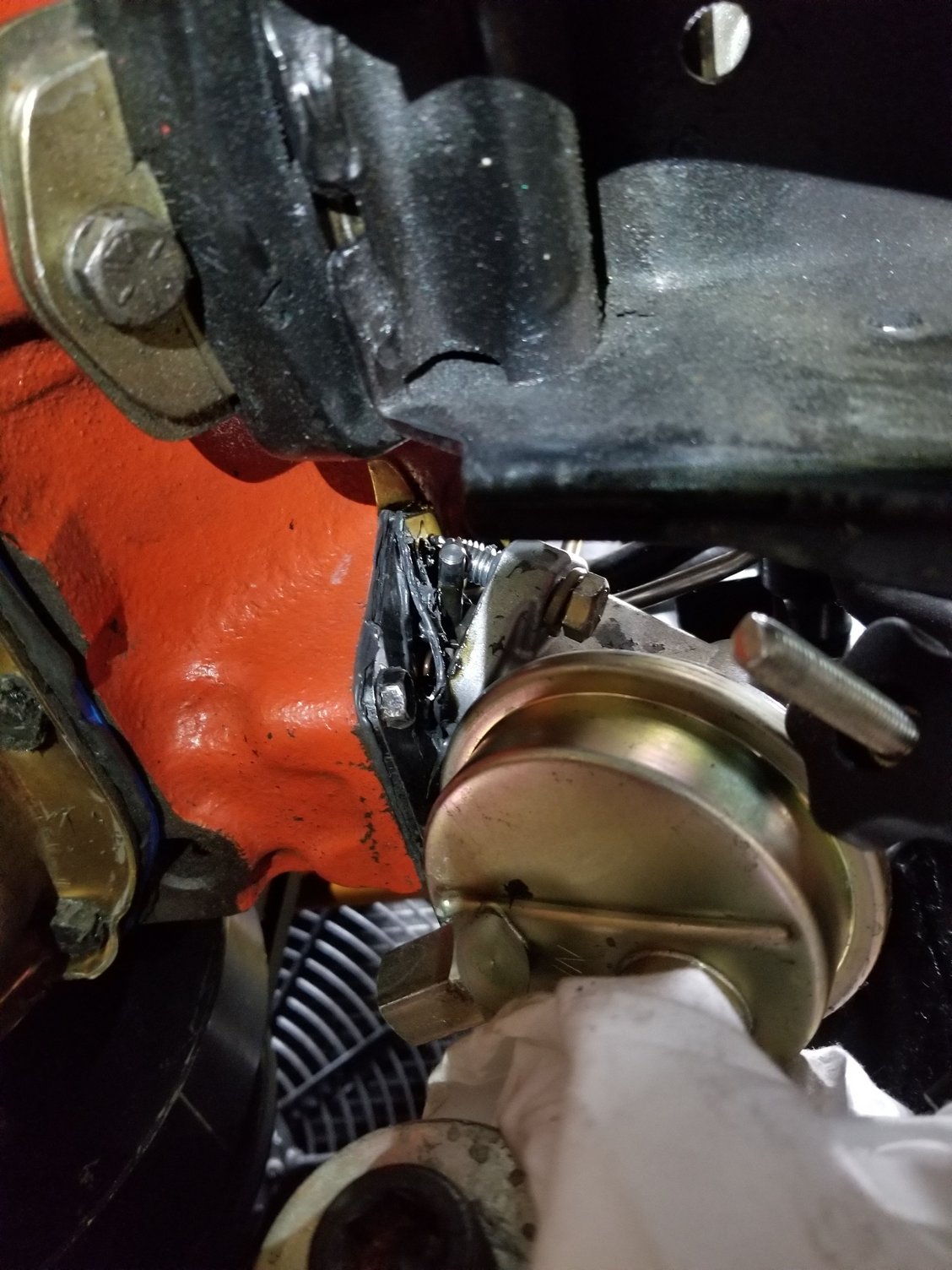

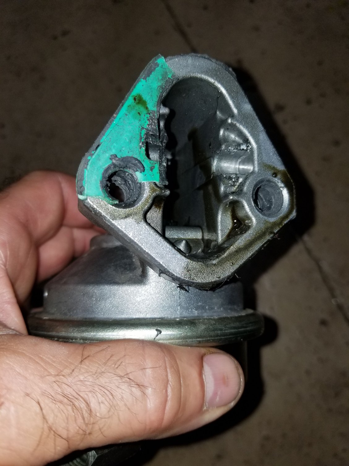

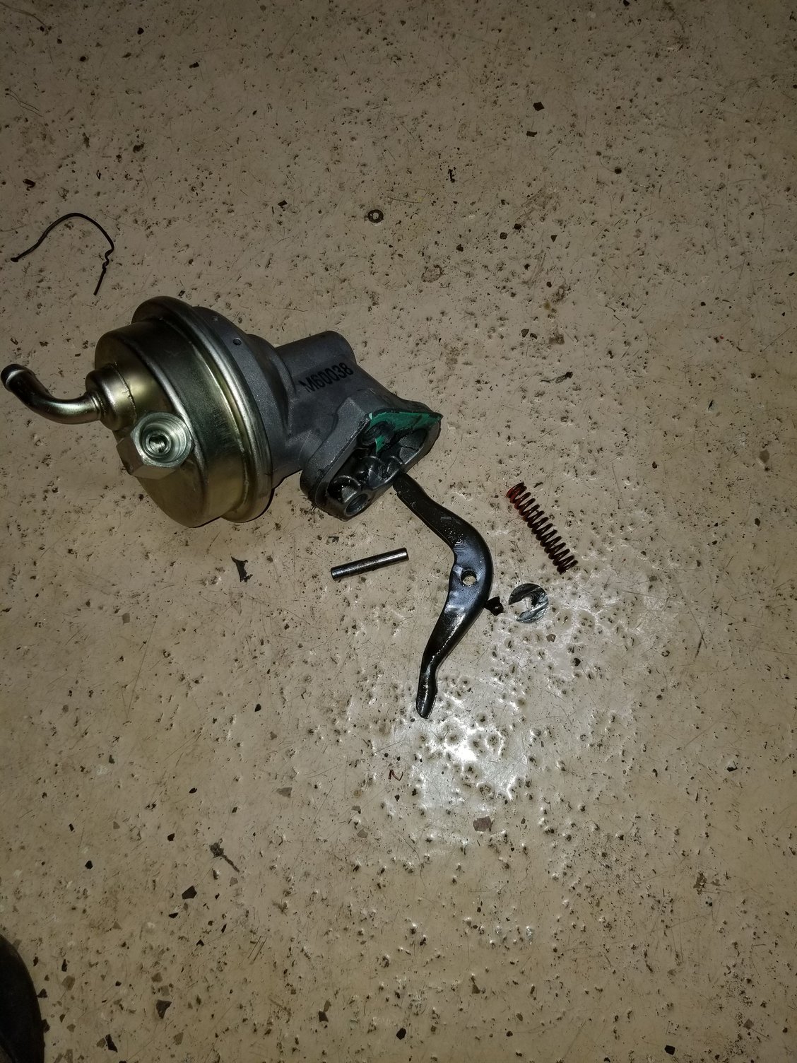

It will/ might flow a little but not freely or it wouldnt pump. There would be a check valve to prevent back flow. The pump is lower than the tank and fuel will flow to it, but not up to tthe carb. What did you order for a pump. Did you pull your pump yet? post pics of the inside when you do
you can see the parts starting to fall out
swaged fingers that hold the pin in
you should have this many parts
