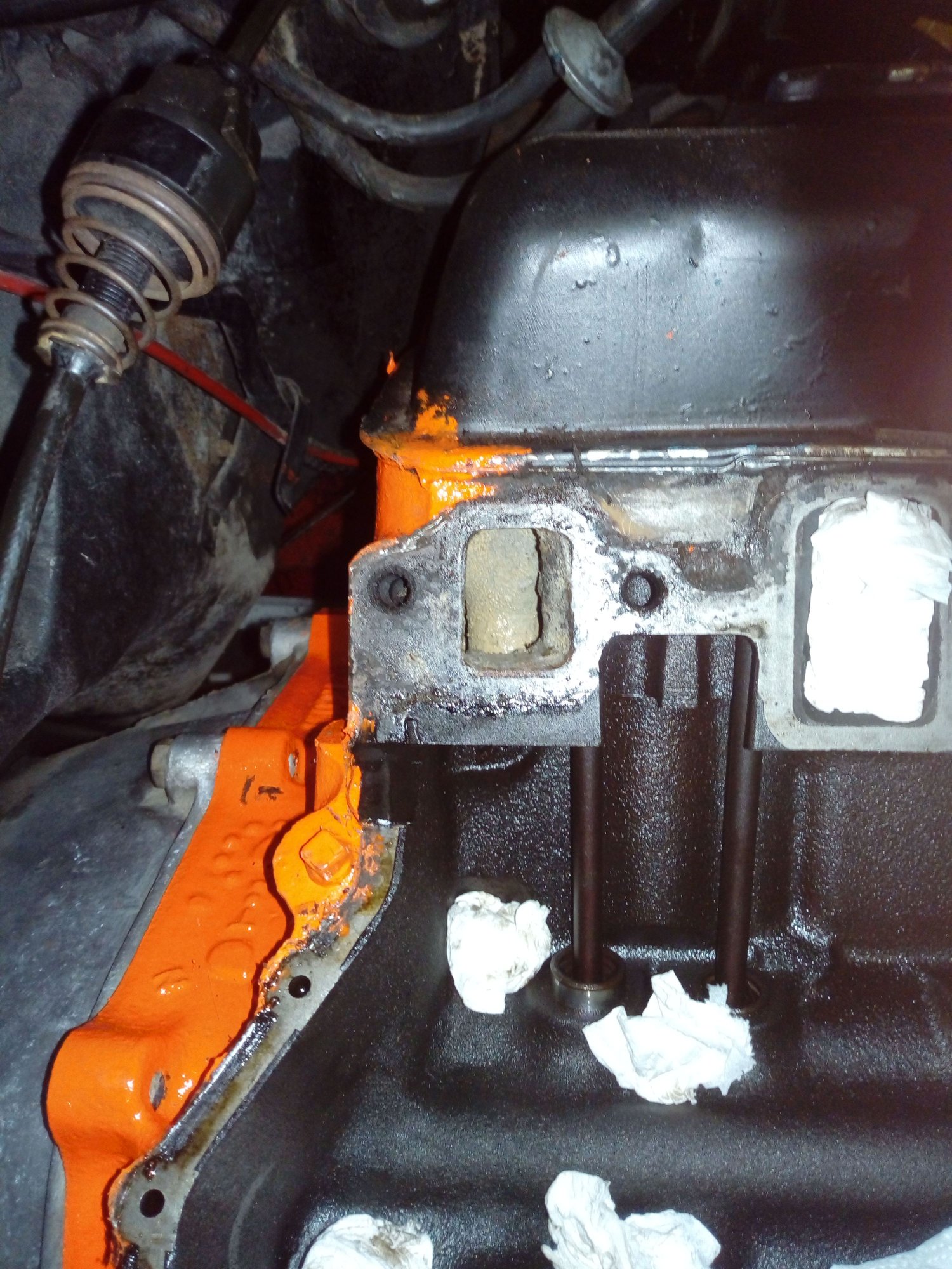

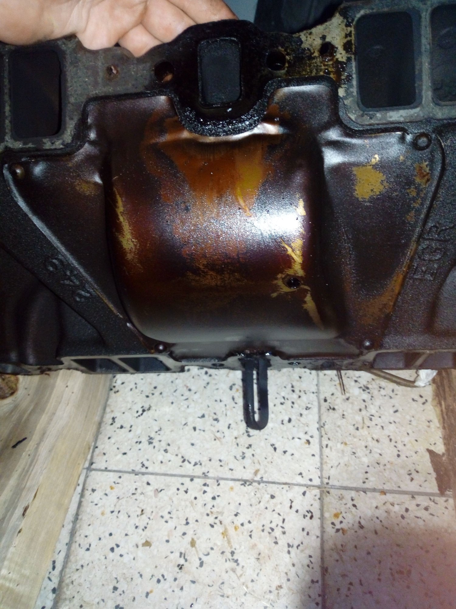

1. I looked at all the passages of my original intake and it seems that the two passages at the rear aren't used... There isn't a true passage on the manifold. (see picture 1 & 2). My new Performer intake doesn't have the rear passages either... What is the reason that the two passages aren't used?

Front passages are more than enough for street ... rear not needed for street.
shield not needed ... leave it where it is & install your new intake.

Omitting the passages allows the Intake to run cooler. Don't worry about that.
And the shield keeps the heat from the lifter valley away from the Intakes plenum and carb for a cooler fuel charge. Don't worry about that either.
What you should worry about is that thing sticking out of the cross-over passage. H-m-m-m-m-m-m-

One head fits both sides. The rear passages are the front passages when the heads are put on the other side. Some aftermarket manifolds have pipe plugs-essentially heater hose taps on the rear water ports.
