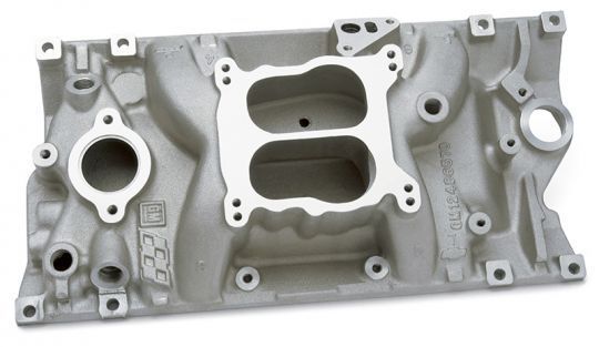

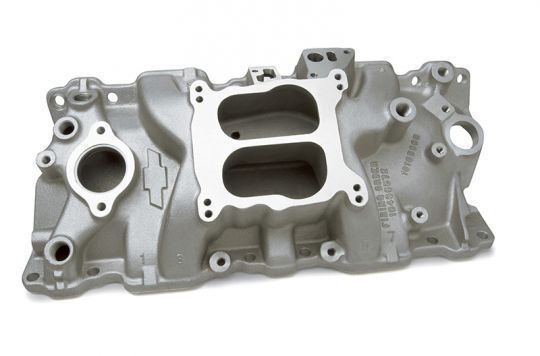

Based on the manifold design, it looks like a Vortec (manifold to head bolts are vertical instead of angled like earlier SBC's). Compare the three manifolds below. The GM optional Vortec manifold appears to be very similar to the ZZ4. You might investigate that one and see if it is shorter. Summit refers to it as a low-rise manifold.
https://www.gmperformancemotor.com/parts/12496820.html
https://www.summitracing.com/parts/nal-12496820
Summit Racing says Chevrolet Performance 12496820 intake manifold has the following front and rear heights.
  • Front height to carburetor flange - 3 3/4 in.
  • Rear height to carburetor flange - 5 1/4 in.
ZZ4
Vortec
Optional Vortec
