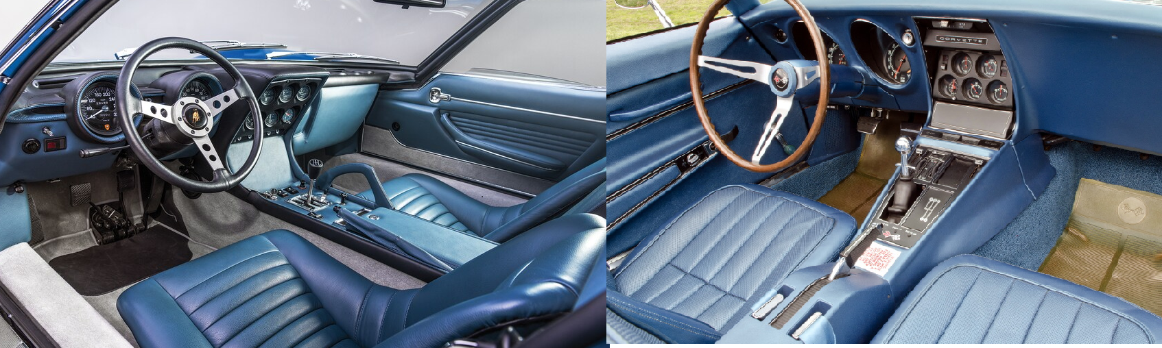

Look at the interiors- Muira on the left- 68 C3 on the right....striking similar-

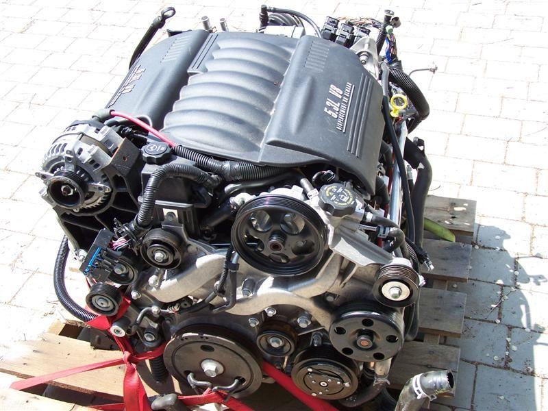

As far as the design- It be much simpler to mount the engine transversely- and can pretty easily be done with GM's LS-4- the ls set up for front wheel drive. Can be found in the Impala/MonteCarlo and others IIRC 2006-2010.
And there are a bunch of kit cars using this combo- LS4/transmission/diff in one compact package

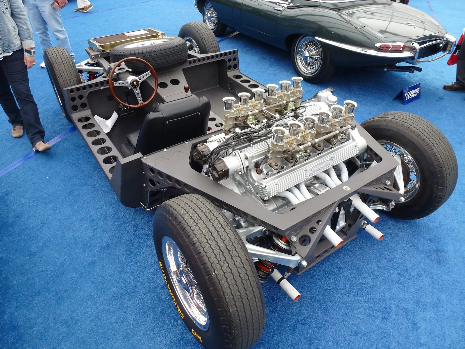

Here's how it's done in the Lambo-
And here's the LS-4- that could easily fit behind the seats

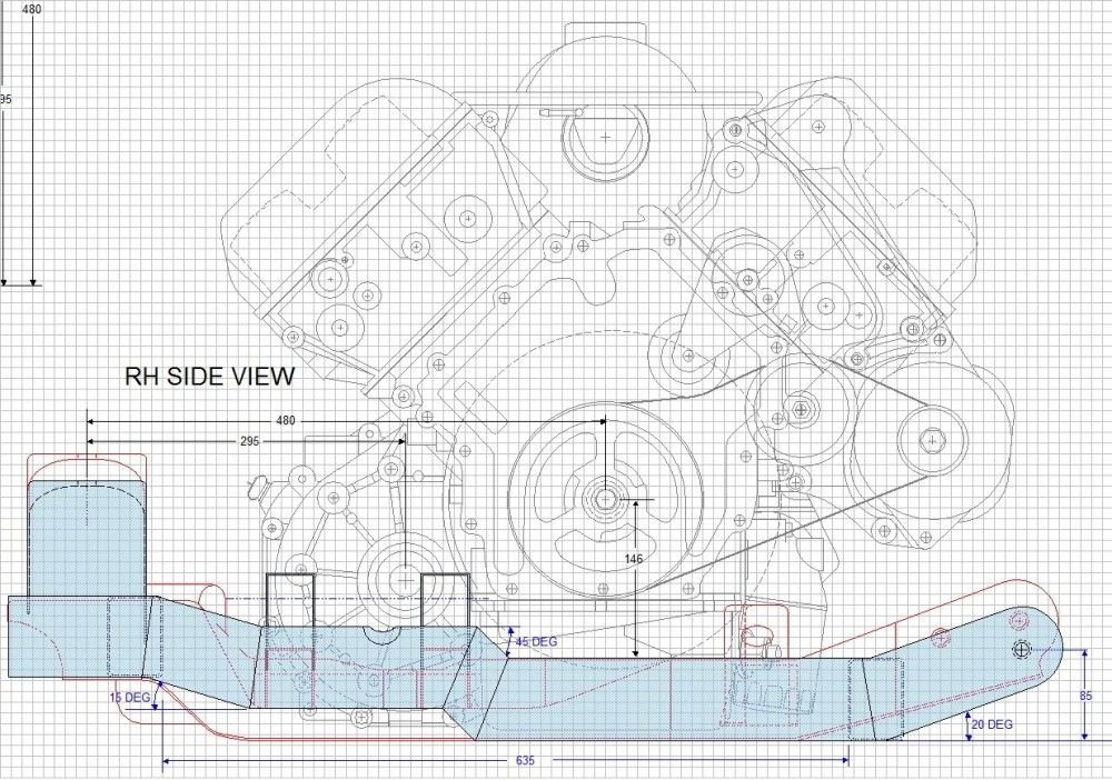

I like the LS 4-lots of performance parts available- and the track was within a inch or two of the C3. However fitting behind the rear seat- the centerline of the rear tire would have to be move back 7 inches.
Anyway here was my mock up of a C3 midengine - transverse mounted LS

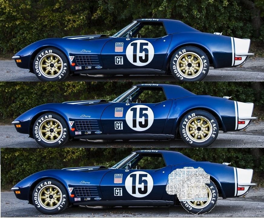

Using a traditional sbc/trans combo bolted to the rear diff will put the engine very far forward leaving less cockpit room.. A better idea would be to use that Porsche trans that is also the diff/trans axle and adapt the drive axles/cv axles to it. Anothe issue is the bubble back of the 78+ cars would allow engine sound and heat through to the cockpit very easily and make it a pita to work on unless you used an 82 CE hatch. A better idea would be to use the flat back window cars from the 68-77, then you could cut the quarters and install hinges to open the back to gain access to the drive train. like this
