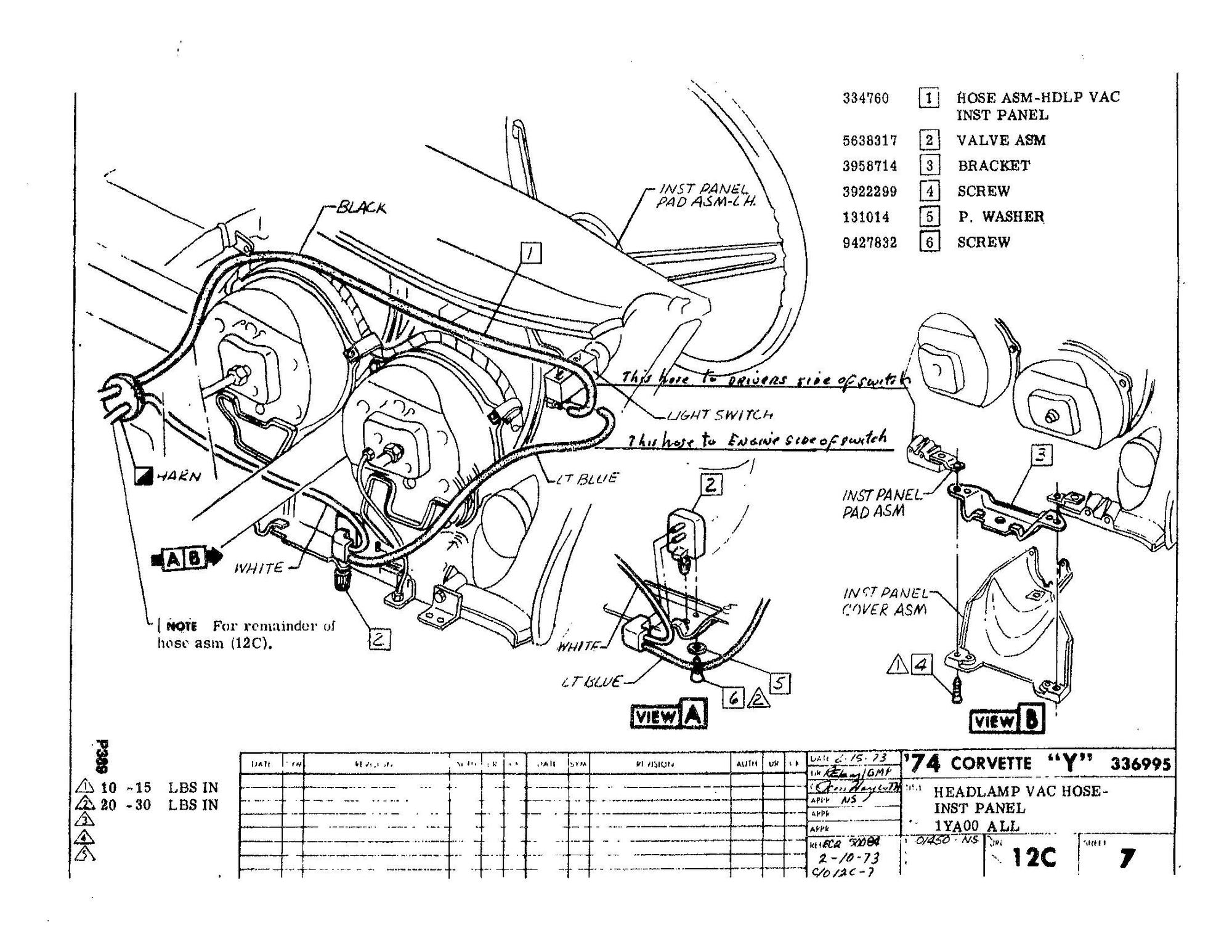

Can I use a 1972 Headlight Switch in A 1975 Corvette? I have a new 72 switch on hand.

Default Yes
https://willcoxcorvette.com/corvette...t-switch-68-77

The GM service replacement P/N 1995191 switch covered all cars 1968-1977.
