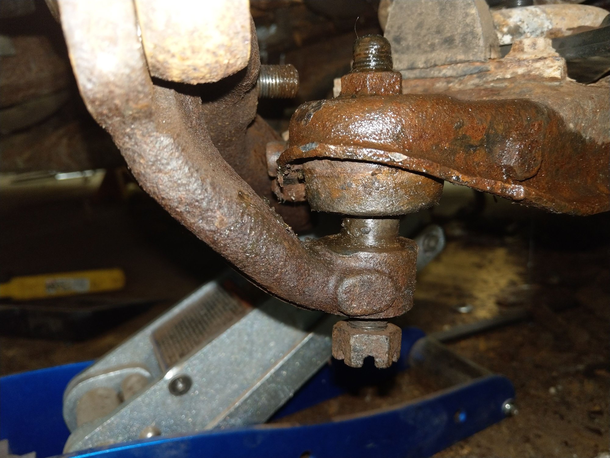

I am struggling to get remove the a arms on a 77 corvette and was wondering if I am doing anything wrong.
I have the spring compressed with a spring Comressor tool.
I have the upper and lower ball joint bolts unscrewed nearly all the way off.
I have a Jack under the lower a arm for extra safety.
I started hitting the leer a arm with a pickle fork in the pictured location. Is there any steps I have missed cause I'm not getting the separation I Am expecting.

You have to do the top one first.
Also because you have left the nuts still on the ball joints ,you don't need to compress the spring , I always leave it so it helps pull the spindle piece down ,you must do the top one first .If its stubborn get 2BIG hammers, hold one against the bracket directly opposite where your hitting with the other .The hitting area is cast into the piece ! two raised areas opposite each other. You want the weight of the hammers hitting , I use a sledge hammer , but choke the handle for better control , so I am not really smashing it ridiculously hard.
when it pops , then put the spring compressor on ……..

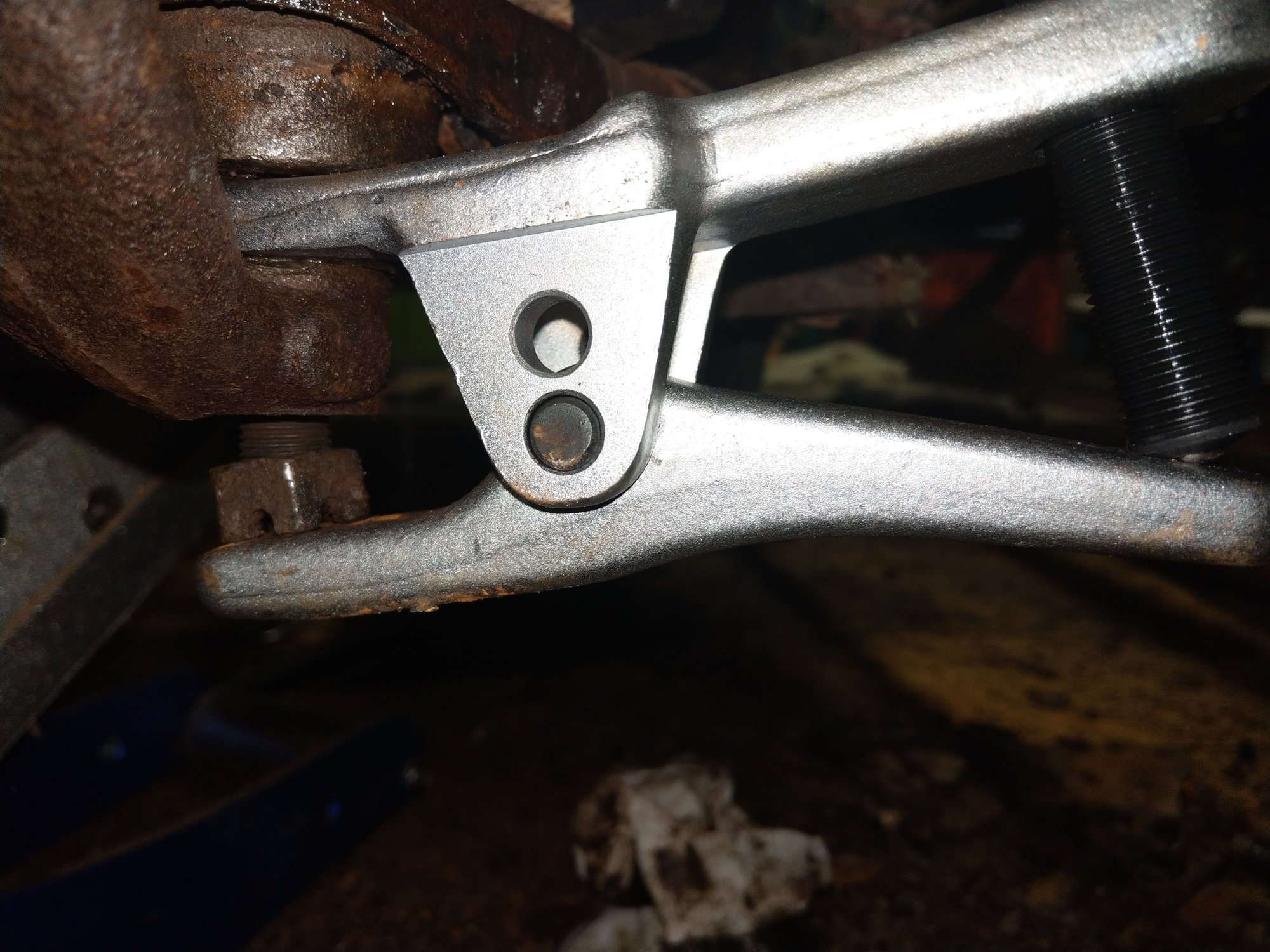

I got the tool from autozone. Started in top one. Four turns and pop it came loose. Went to the bottom one, and I have it nearly all cranked in and it's not popped yet.
let me make sure I am still going this correctly.
I still have floor Jack holding up lower arm just a bit for safety.
I Have top ball joint popped but nut is still on it. Bottom nut is still slightly on.
Spring is still compressed.
Am I putting the separator in the correct location as shown in pictures?

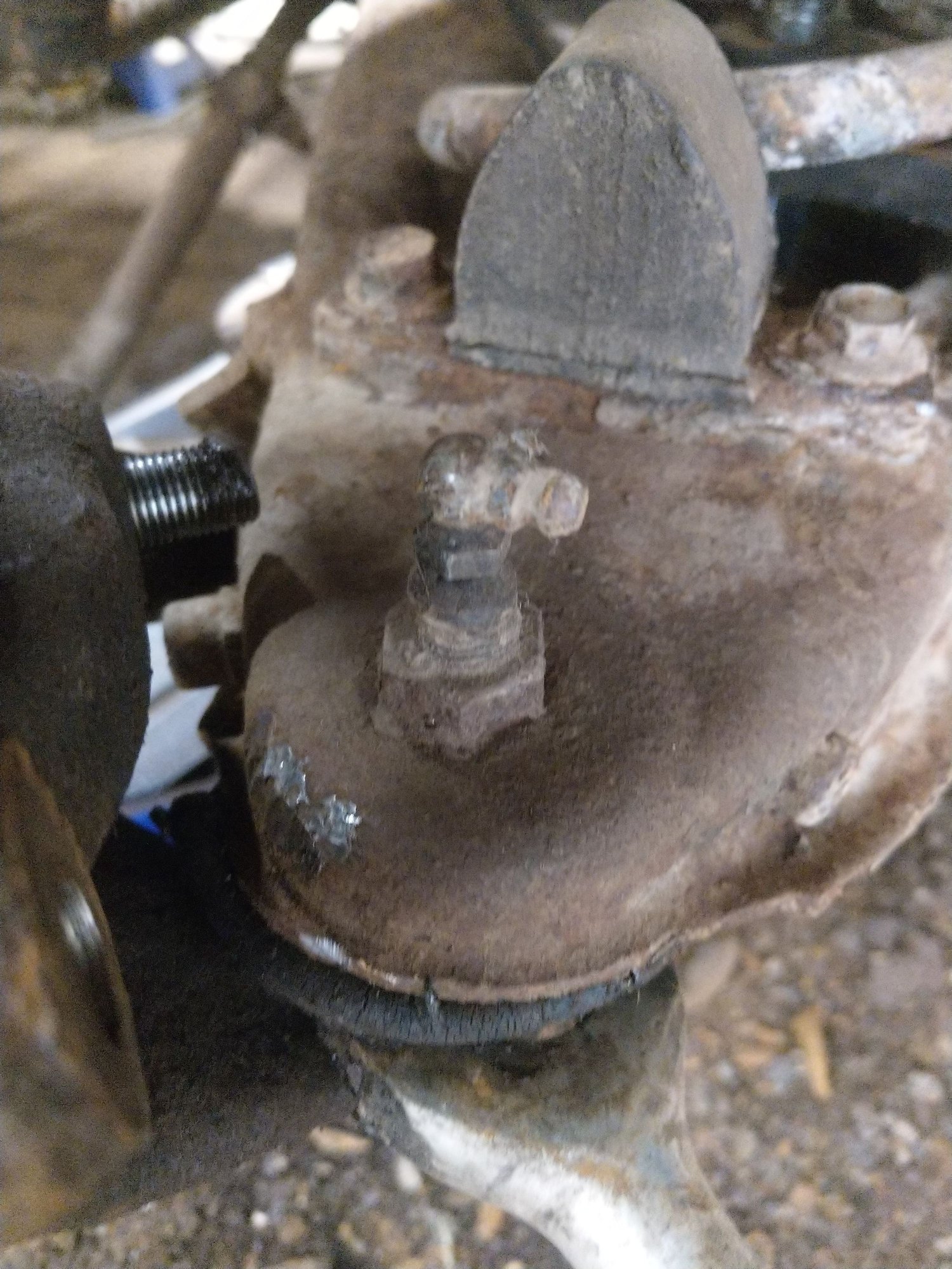

Does the Bolt that is above need to be removed for any reason. It had a grease fitting but it snapped off.
Thanks

I would smack it with a hammer after a few turns. After the hammer a few more turns - go back and forth between turning the bolt on the separator and hammer.
