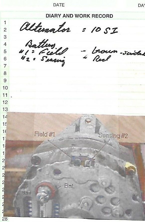

I don't know if these carried through to '69, but I would change the voltage regulator if it is external. When you turn on your headlights, the sensor, or field, (I don't remember which of the two) wire is supposed to kick in another set of windings, or such, that increase the output. Sounds like this is not doing its job.

You might want to check the two-wire connector to see if your wires and connections are good.
