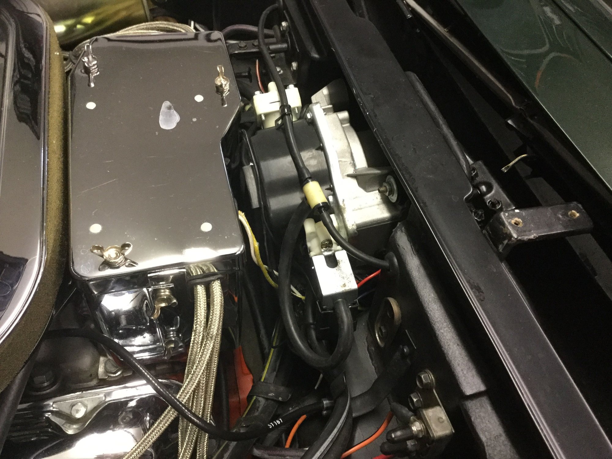

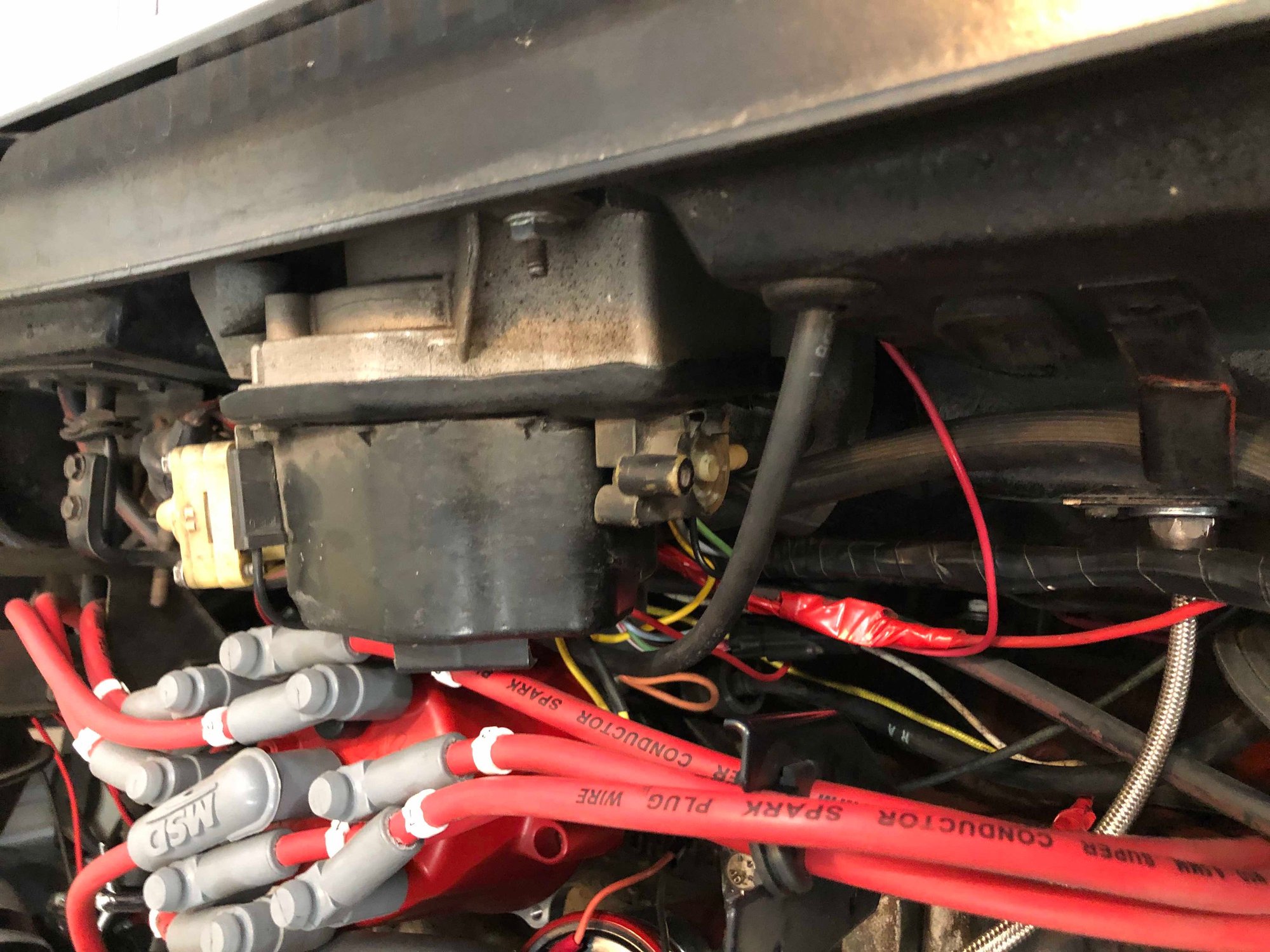

So the wiper has never worked since I got the car fixed and I finally decided to look into it, On the drivers side there should be a piece that works with the windshield washer fluid and it has a couple of electrical parts that go on it as well this seams to be missing does anyone have pictures of the drivers side of the washer motor?
