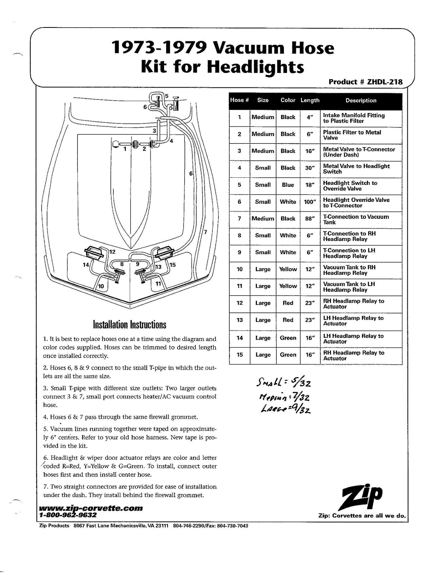

Hello, I have an anniversary model of the 78. The previous owner has allowed it to sit and rot for the past 20 years. So now 1 of the issues that I have to deal with is the giant web of dry rotted vacuum hoses and rusted through emissions system. My question to day is this, are all of the vacuum lines the same diameter? If they are it would make my life 100% easier and faster to just by a 40ft length and call it good. Now if it is the case that they are not all the same, does anyone have a list of the different sizes I will need? I'm just trying to avoid 30 trips to the auto parts shop.

There are a number of different sizes used. I suggest the kits from Doc Rebuild. Everything cut to length, color coded like the originals and fit just like the originals. The kits also come with tees and clamps.
If you do get your own hoses be aware that outside diameter sometimes matter--most notably at the headlamp vacuum relays.

http://www.corvette-101.com/vacuum.htm

Buy the hose kit from Doc and save yourself some headaches. The hose kits also include all the smaller command side hoses. The color coding is extremely helpful, particularly 5 or 10 years down the road when you have to fix another vacuum issue.

Note that there are a number of hose kits: Headlamps, Vapor Canister/PCV, Emissions, Cruise Control, HVAC. The only vacuum hoses not included in those kits are a little short one on the transmission at the modulator valve (auto only) to the power brake booster. The HVAC lines are of a different material, use a different connection method and seem to last much longer than the others. I would not replace them unless you confirm leaks.
