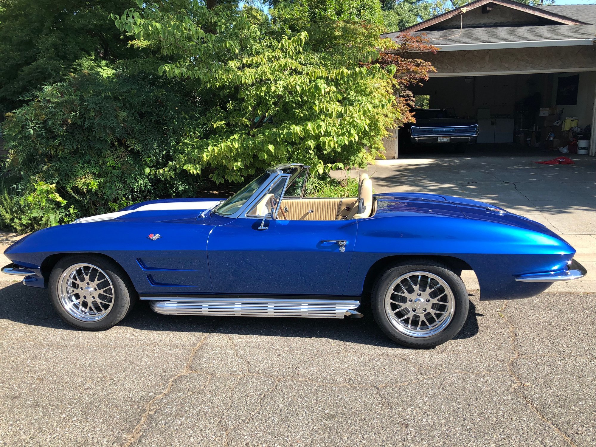

While I love the look of rally wheels on my 68 I did go with some custom wheels for my 63. I looked at so many pics of every 63 on google and this forum and really liked the way Bose wheels looked. Quality is incredible, not cheap but not completely outrageous. I went with 17 in which seems to work well with stock suspension. I wanted to look some what like newer factory corvette wheels.
17 in Boze
15 in stock wheels
