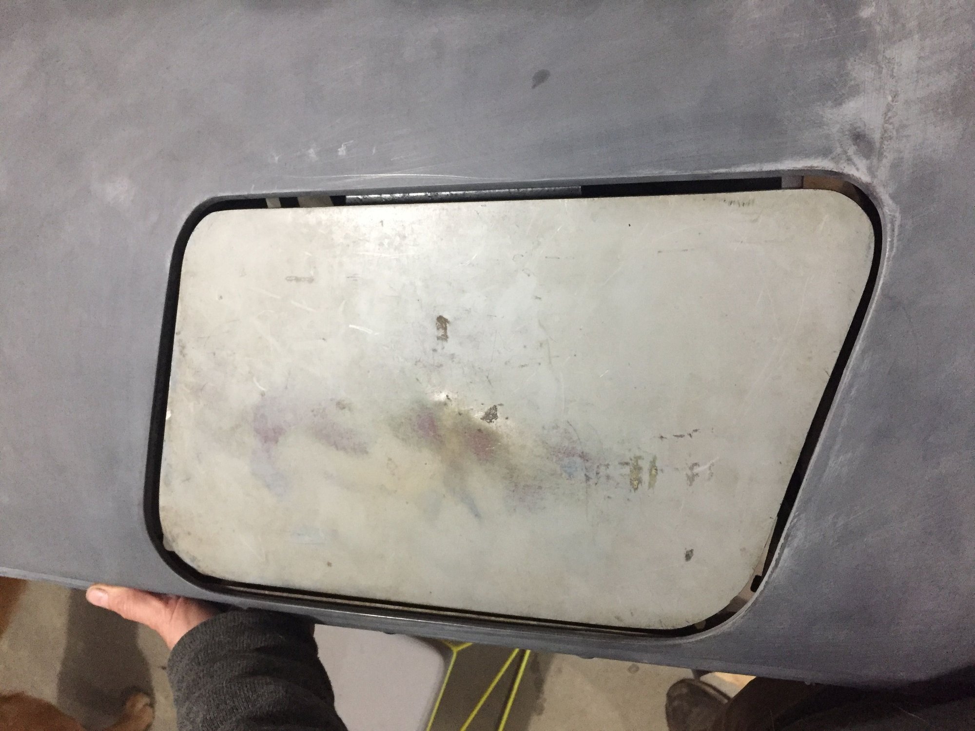

Hello everyone, the quick back story is that I bought a 68 that was completely disassembled.
I’m trying to figure out why the headlight doors are much smaller than the openings. They are also smaller than the edges of the bezels.
Am I correct in assuming that the lids of the doors should at least be flush with the tops of the bezels?
The gap around the head light door is almost 7/16”, which I didn’t bother adjusting because it’s not going to look right with that much space.
Are there different sizes of headlight doors for C3’s?
Any thoughts would be appreciated!
Thanks

In 1968 there were 3 different size head light doors each were about 1/4" larger the the previous. You may have a later build car with an earlier bucket.

Thanks, that explains a lot. Seems like the best remedy is to find doors that are correct for the opening? Larger doors would also cover the bezels.

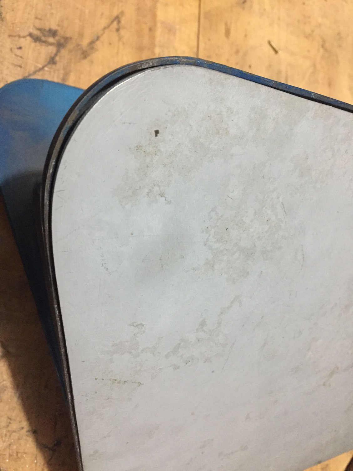

Thanks but no one will want these doors in trade. Both left and right have repairs, and one is a little warped. I looked into new ones, no mention on any suppliers site of different sizes. $250 each YIKES.

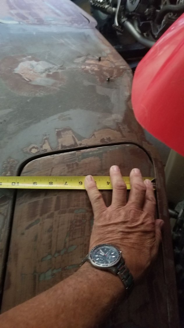

https://www.ebay.com/itm/Corvette-OE...temCondition=4. https://www.ebay.com/itm/68-69-70-71...temCondition=4. Measurements. Measure the doors and openings. Post pics with tape measure in place.

my 75. 10 inch opening. 9-13/16 door. Diag. 18-1/2 long way. 14-3/4 short way.

THose look just like my early 68 doors. Good luck. Even more of a problem is finding the correct early pot metal headlight bezel. they changed the sizes but kept the part numbers the same

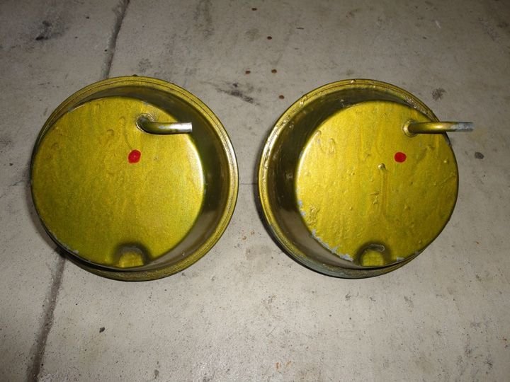

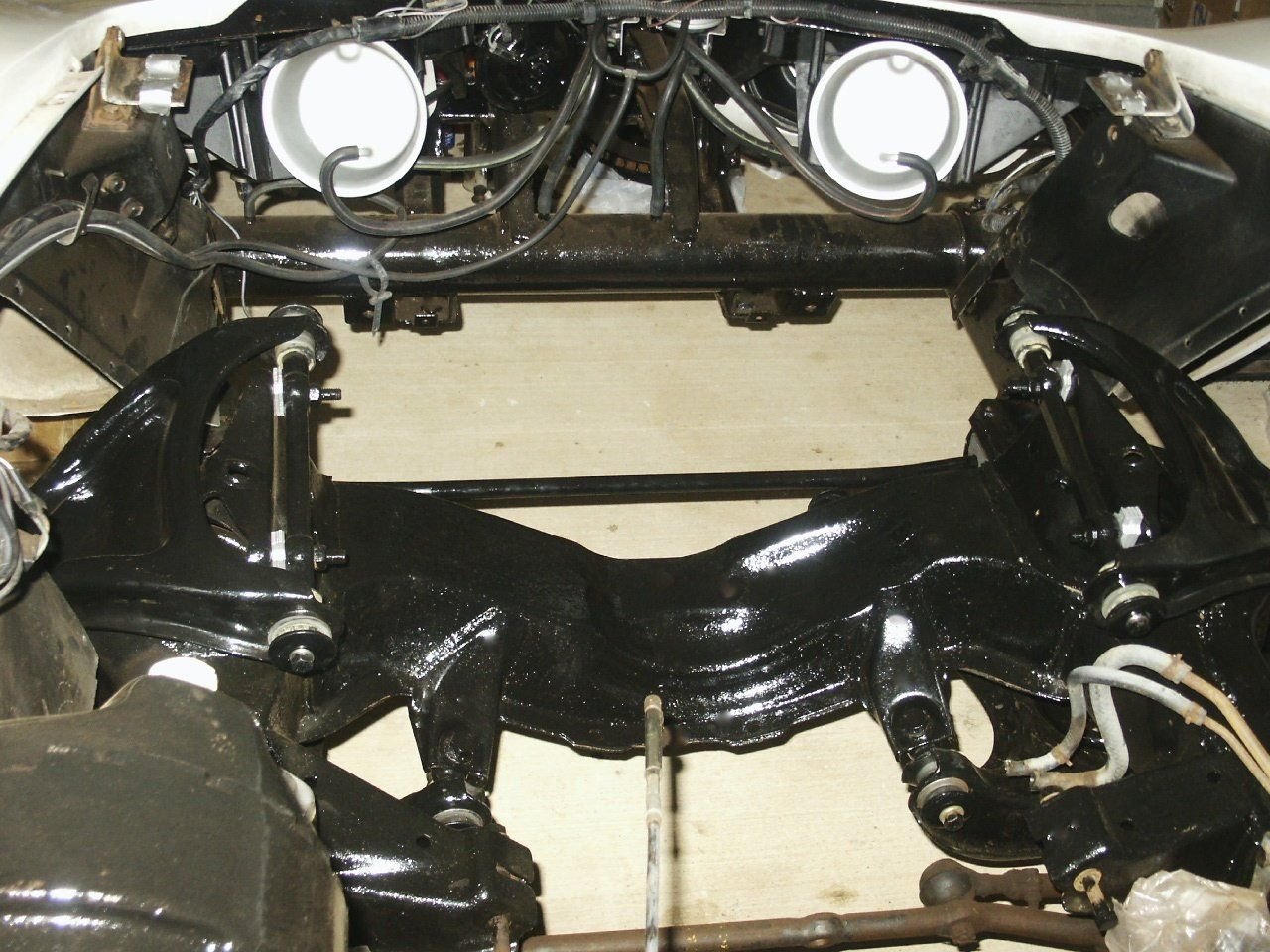

There were several changes in the headlamp door system in the March time frame. The doors were one, the other were the actuators that move the doors up/down went from both vacuum tubes seen with the hood open pointing to drivers fender plus offset from center of the actuator to drivers side. To were each actuator is pointing to its associated fender with the tube centered. Also the hoses went from thin wall the a thicker wall design. First photo is early design 2nd is later design.

My 68, which is an October 67 build, has the actuators in the second photo (where each actuator is pointing to its associated fender with the tube centered.) 1968 is simply a weird creature when it comes to its pieces and parts....
