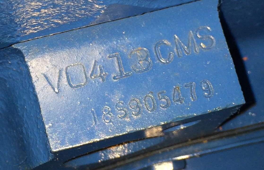

Right below the passenger side valve cover, in front , will be a squarish pad. It will have a partial vin and the engine information. Like this or is that information gone?

If the pad is decked and the info is gone, then even if it was original, it “used to be numbers matching.” Not sure if you are looking at the right spot, though. (See photos above). Earlier blocks have a more oblong shaped pad.
010 blocks are common for these cars (and others) over a number of years. It would be correct in 1979. Can you see the casting date on back of the block?

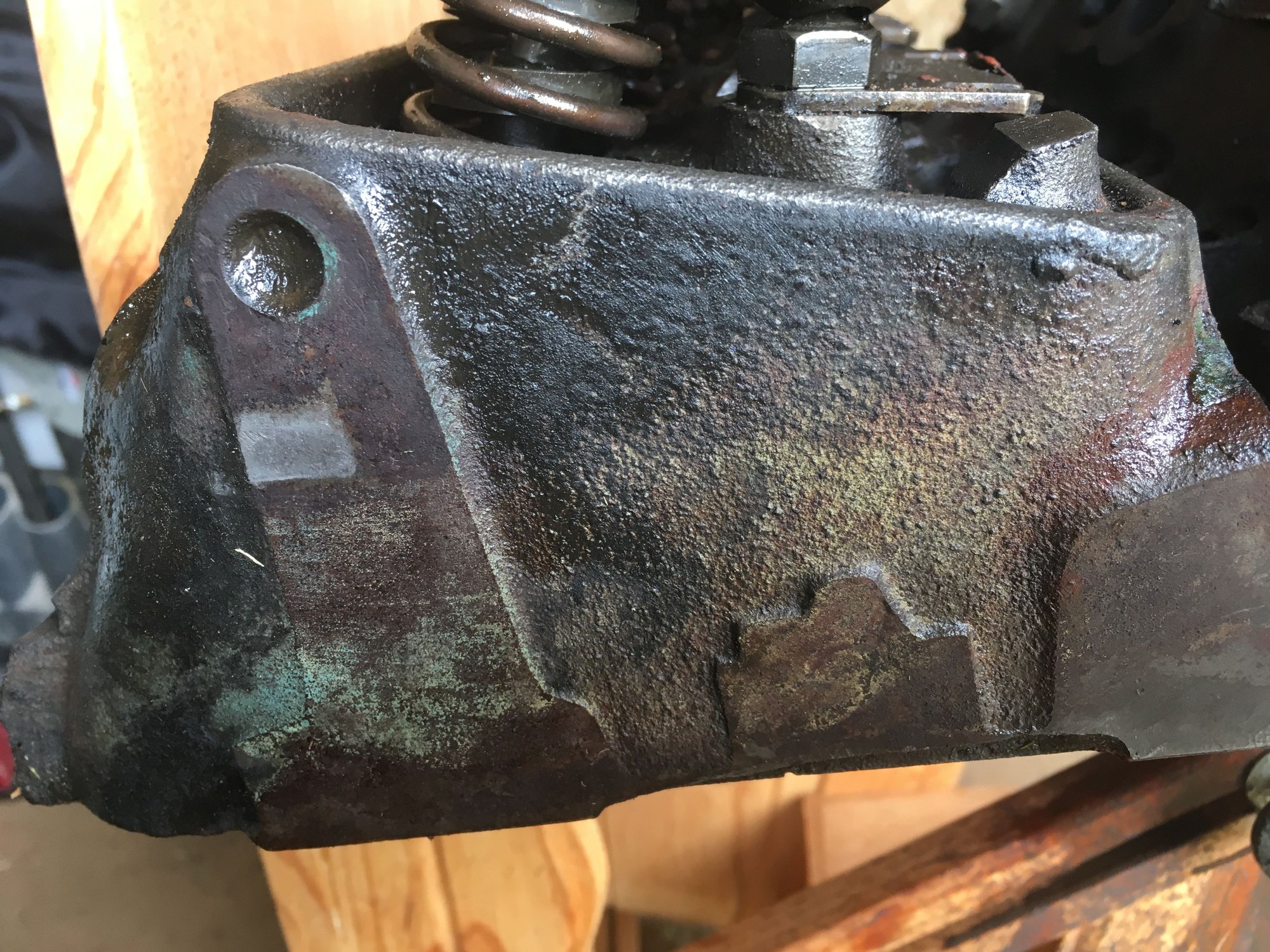

Shiny spot on the left was where the air conditioner bracket was

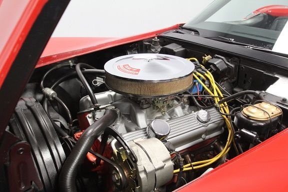

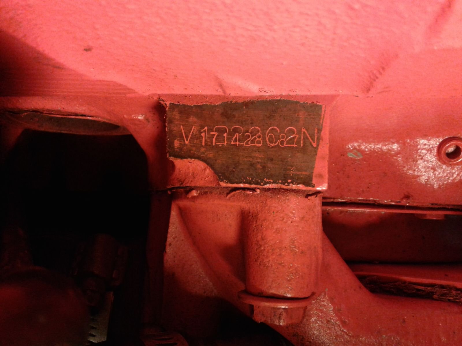

Front passenger side of the engine.
Here is another picture of my 1968 that might help...front passenger side of the engine block. First prize to anyone that can tell me what the C2N code means...can't find it on any of the lists.

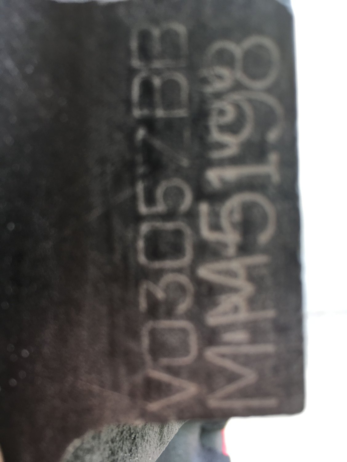

Sorry I misunderstood I kept looking on the heads and there’s nothing on them but this is off the block

ZBB is correct for an L-82 with AT. I can't read the VIN derivative stamp in your pic. Does it match your VIN?
Old Sep 20, 2019 | 02:12 PM
stingr69's Avatar
stingr69
Joined: Mar 2004
Posts: 7,458
Likes: 1,484
From: Little Rock AR
"ZBB" = '79 Corvette L-82 with automatic transmission.
Assembled on March 5th 1979.
If the last few digits of your VIN match the last few digits of the VIN derivative number stamped on that pad (smaller stamping), the engine is original to your car.
Picture is a little hard to read.

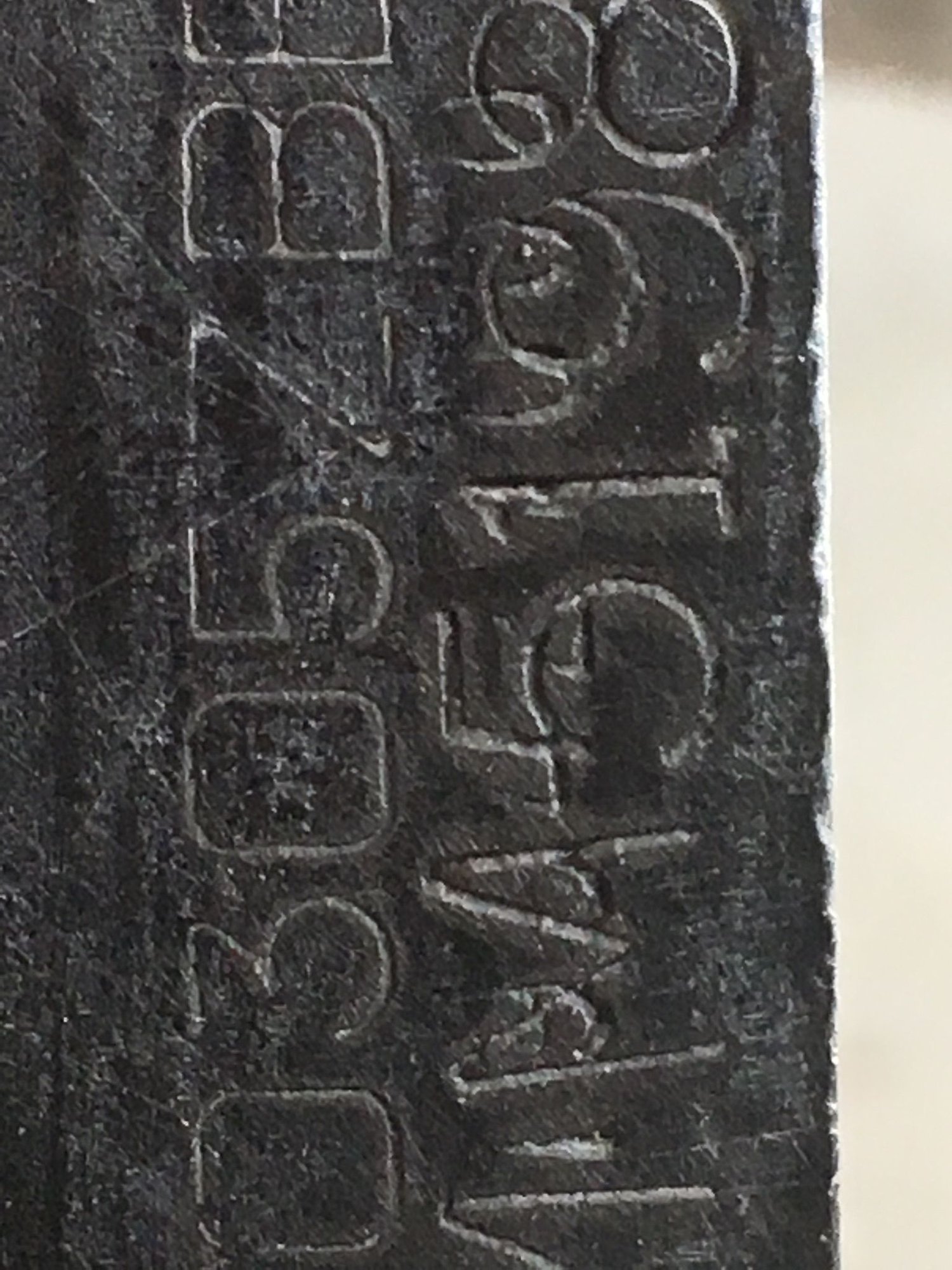

Not sure why someone stepped over top of it very hard to read even up close and personal with a magnifying glass I think the numbers are right but if not it is what it is

Looks like it very well could be -27000...congratulations!

That double stamping is odd though. Like to see a more clear picture.

That small design pad wasn’t found on a 1968, that the later design.
68 blocks had the longer oblong design.
Seems C2M is a ‘77 305, C2N comes up as a Phoenix or something. Looks like an error.

I agree that the pad is not for a 68, it is a later design, maybe late 70s.
Checked all my sources and could not find any listing for C2N.

Yes...the engine doesn't look a 1968. Since it has a 2 bolt main, a 3970010 engine block casting number and a passenger side dip stick I am leaning toward it really being a 350. Or a miss-stamped block.
I don't believe the sticker...
Thanks for the inputs.

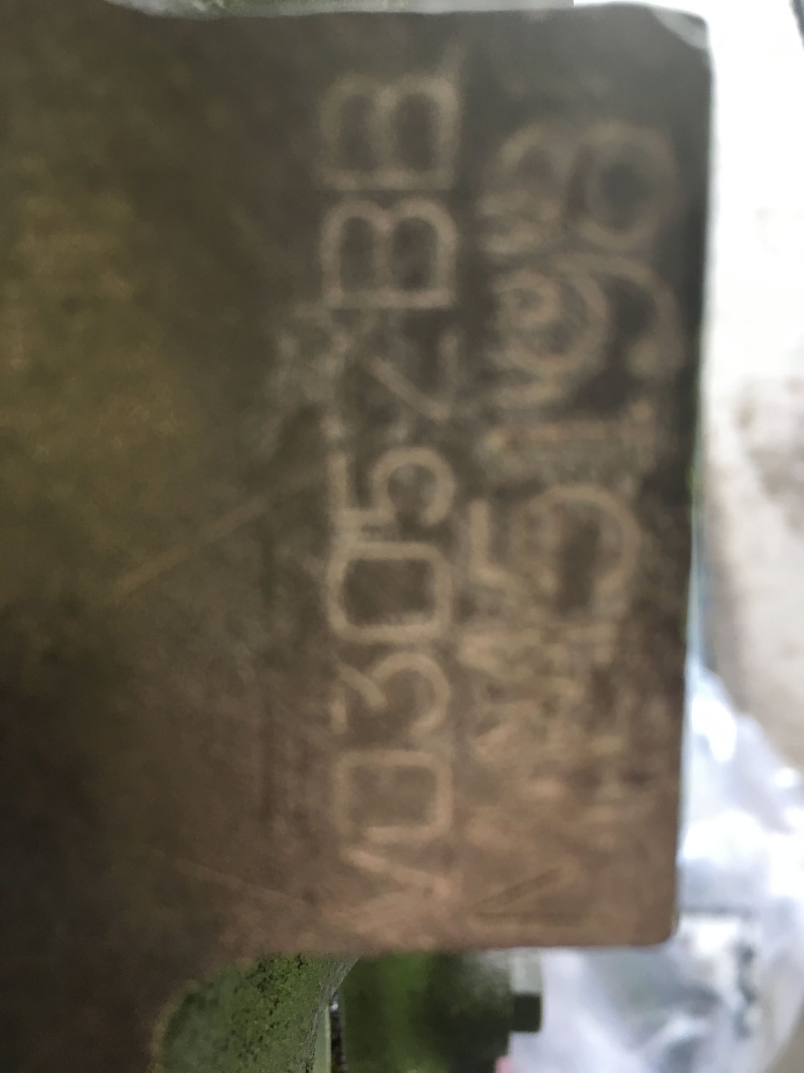

This is as good as l can get it. I have a 4 bolt main and wind age tray. Aluminum heads and Q-jet 4bl. If it is or isn’t has become irrelevant to me as I have no plans to sell it. I will let the kids or grandkids figure it out after I am gone.
