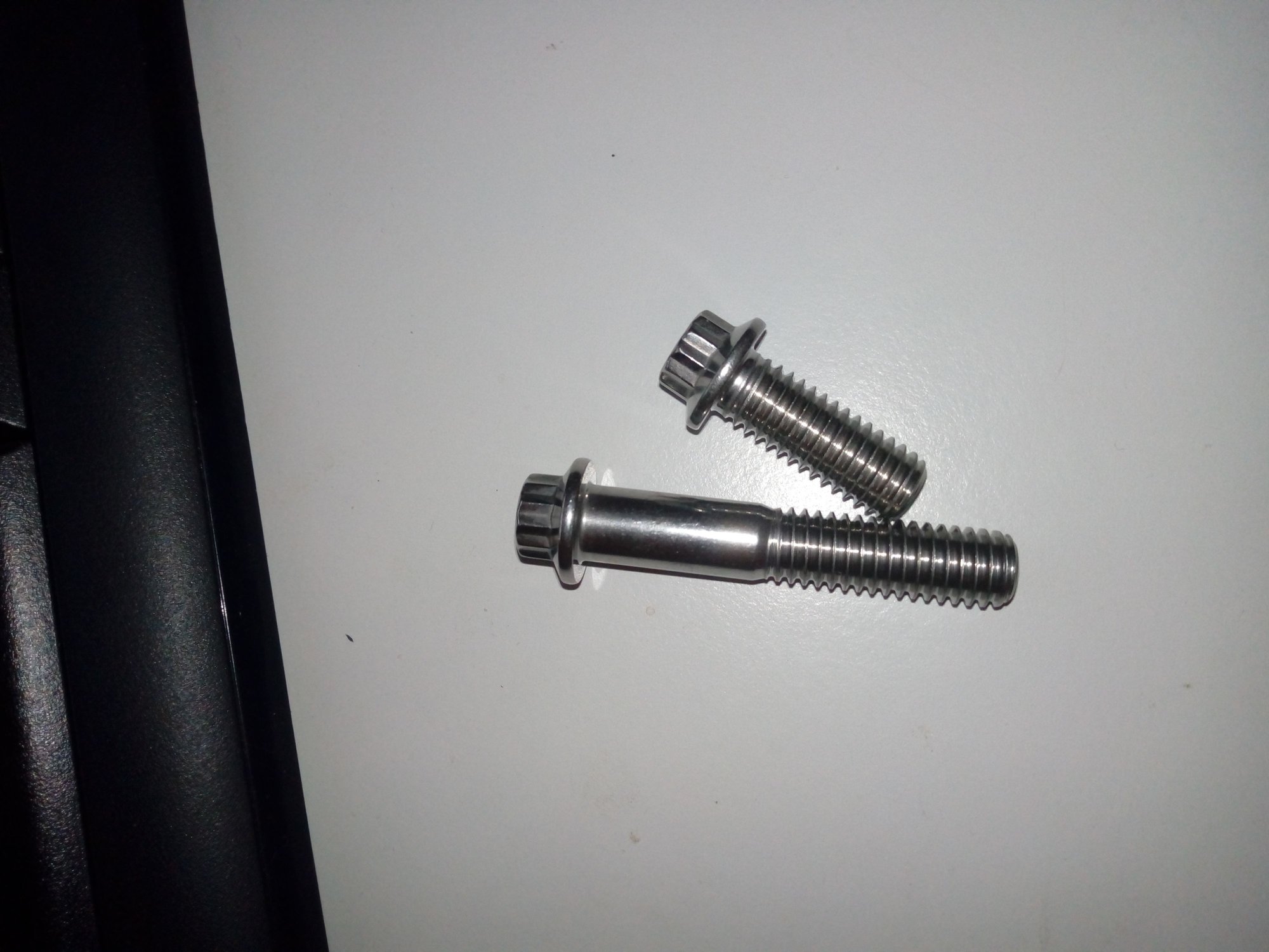

1. Can I install these ARP bolts for the water neck without washers, or isn’t that a good idea? I ask this because my bolts are a little too short when I use the washers. (ARP 430-7401)

Now the bolts. ARPs are top of the line. Unfortunately, if you want just one bolt, they come in packs of five. Rather pricey with shpg.
Have you tried Summit and search specifically "water-neck bolts" SBC, ARP?

- The length of the ARP bolts (picture) is good when used without washers.... but is it good to use them without washers?

I forgot you are not in the U.S. so getting parts is more difficult. However, you don't need washers. You have bolts with washer built in.
Don't forget thread sealant on the bolts where it goes into the water jacket.

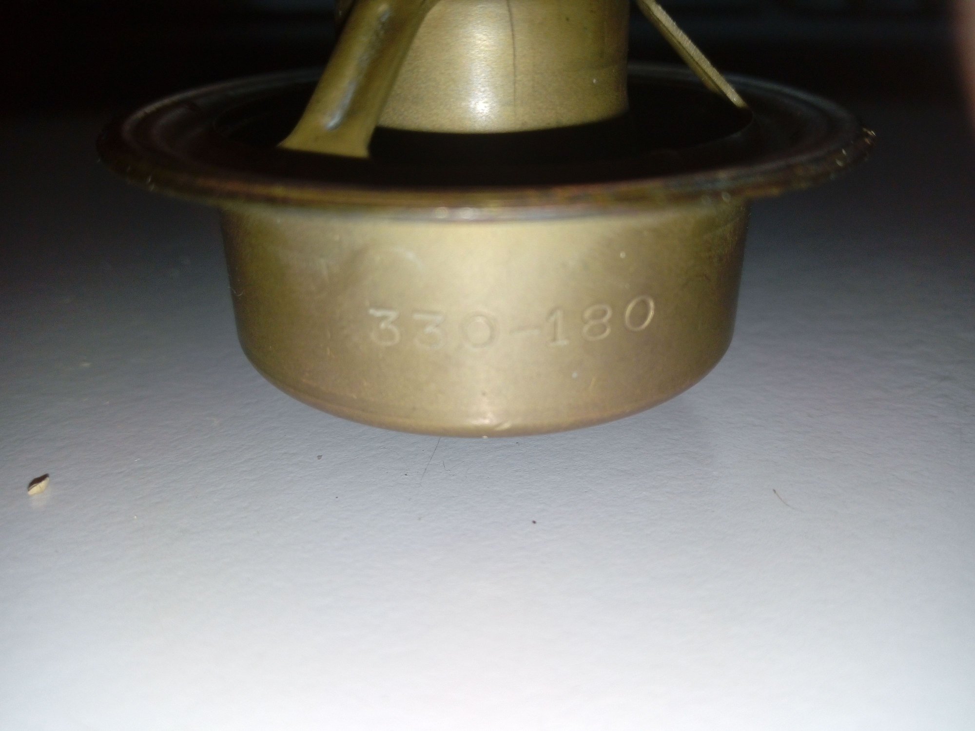

The 'old' thermostat says: 330-180
I can't find any brand name.
Would the '180' stand for 180 °F?
I think I found which brand it is, but I'm not sure:
Flowkooler Robershaw series high Performance thermostat 330-180
https://www.summitracing.com/int/par...-180/overview/

That would be a safe bet. Another brand worth mentioning is Stewart.
And again, drill two holes in the flat part.
