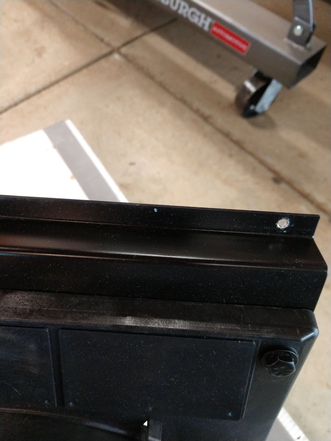

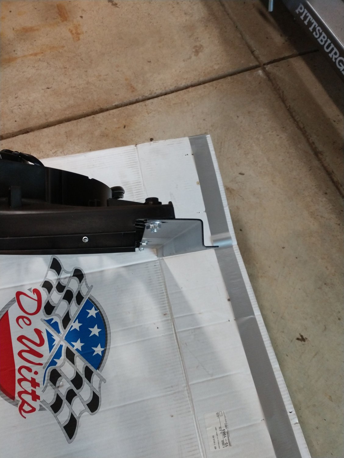

My dual-Spal fans came with the install kit from DeWitts, which you can purchase separately:
https://www.dewitts.com/collections/...s/fan-brackets
But there's not much to it. A few pieces of angle aluminum are all you need.
