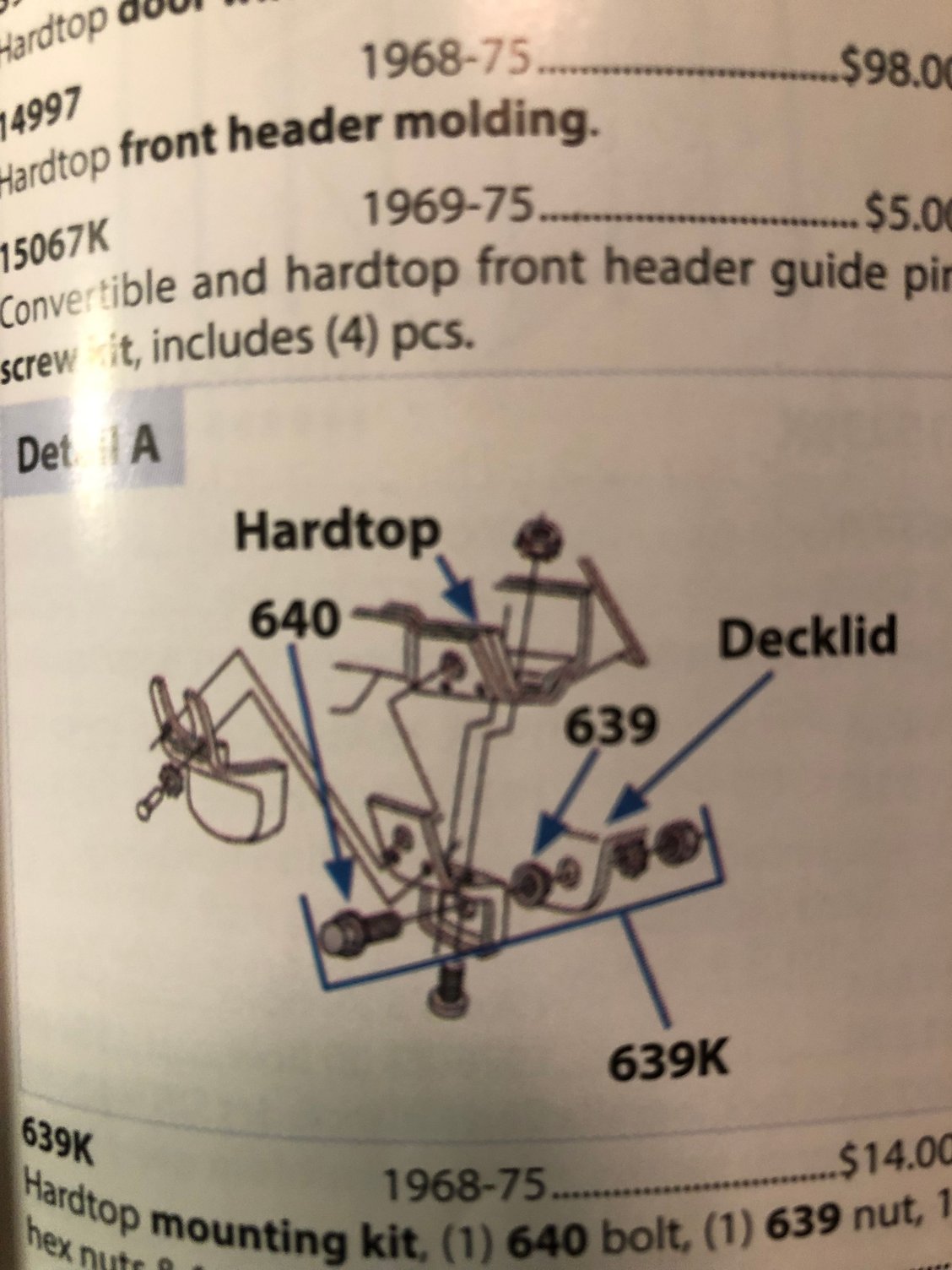

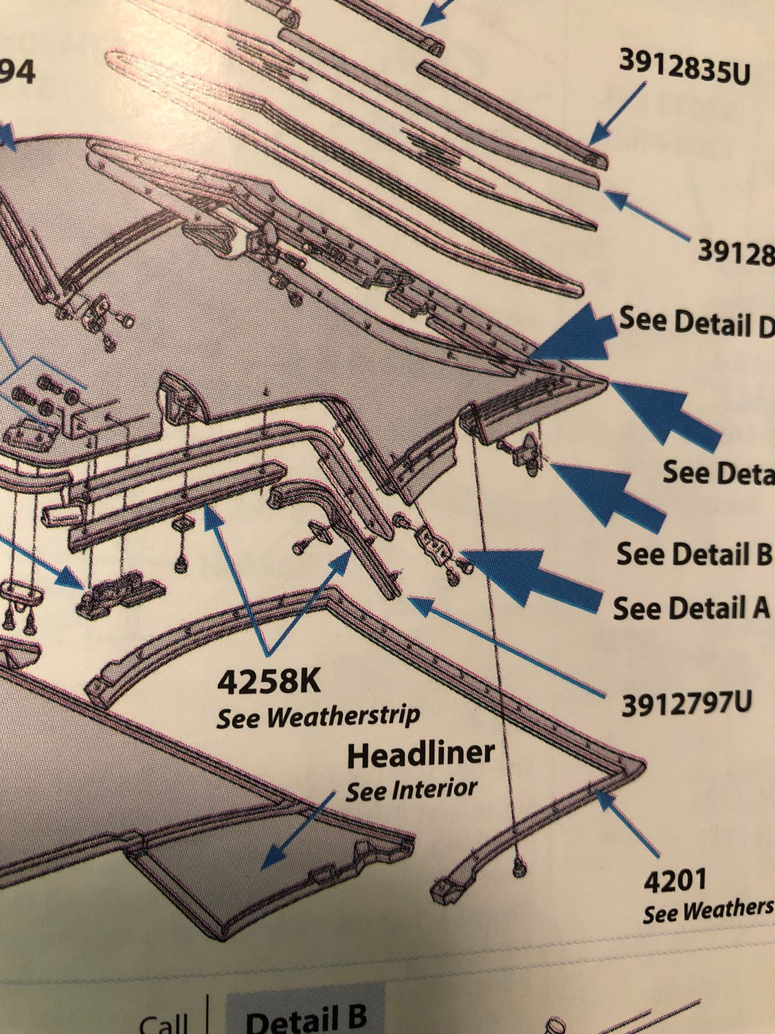

Detail A, page 129 Paragon Corvette Reproductions
My 73 as well as other years (68-75) have right and left chrome brackets (covered by a rubber boot) that attach to the rear deck. I am guessing that your hard top does not have the brackets. The hard top for my car was purchased after the car left St. Louis. I know this, because there are bolts that go through special receiver mounts to secure the brackets/top, and my car did not have them. Ernie at Willcox was kind enough to locate a set of the brackets for me, as none of the vendors stock them. I will attach two illustrations from the Paragon Catalog. The AIM also shows them.
