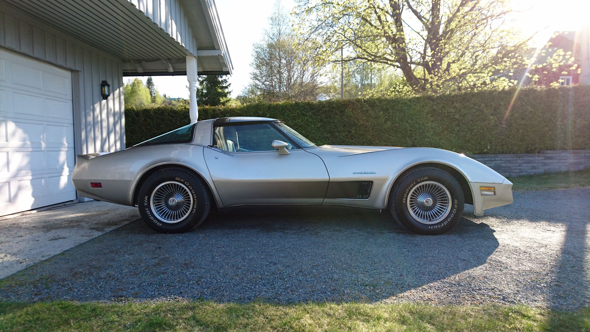

Here is a picture of the car parked outside my garage (the car will soon be moved to a better insolated, heated garage).:

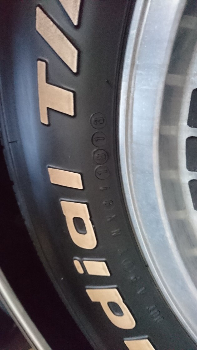

* All tires have 20,0 PSI, and show the numbers "1813" in circles, making me suspect they are manufactured in week 18 in 2013, that is seven years old. The thread is good.

The plan for tomorrow is to check the torque on the wheel bolts / lug nuts. According to the owner's manual (7-2), the torque for standard wheel nuts is 110 Nm (80 lb.ft), and for aluminum 122 Nm (90 lb.ft). I don't know what kind of bolts I have, so I'll settle for 110 Nm.
According to the manual (5-14), tire pressure should be maximum 35 PSI. This corresponds with the placard on the driver side door and what is written on the tire itself. However, I read on several sites online today that lower pressure is OK, and in some cases recommended. 20 PSI might be low, so I will inflate all four to 25 PSI before hading out tomorrow.
