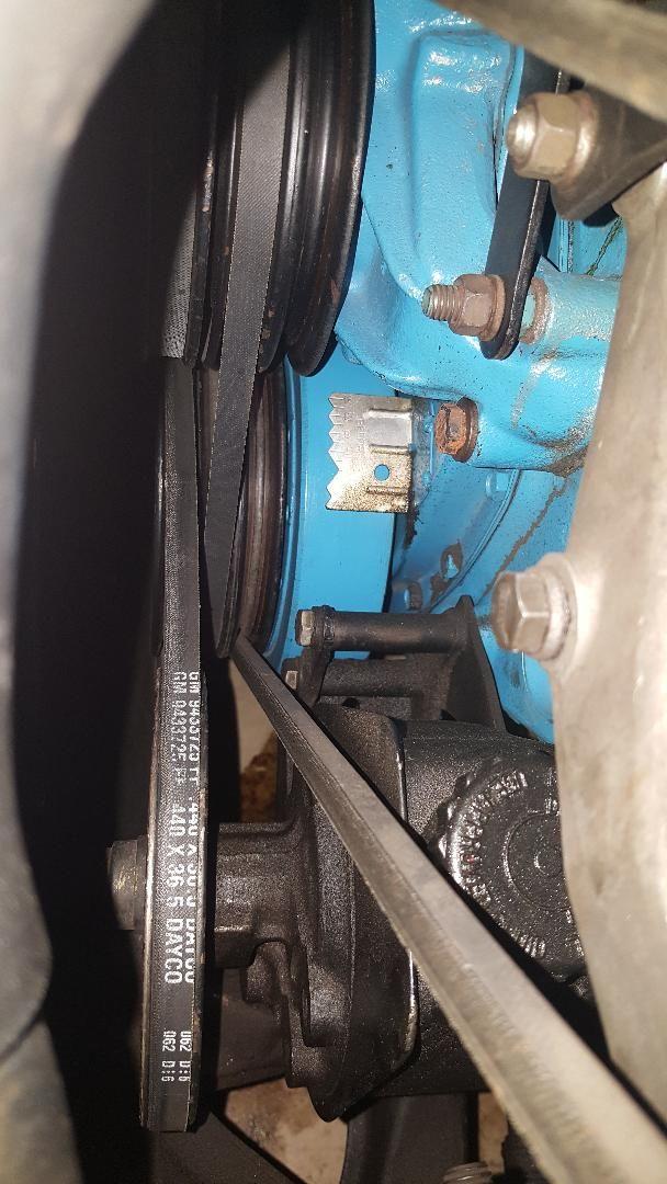

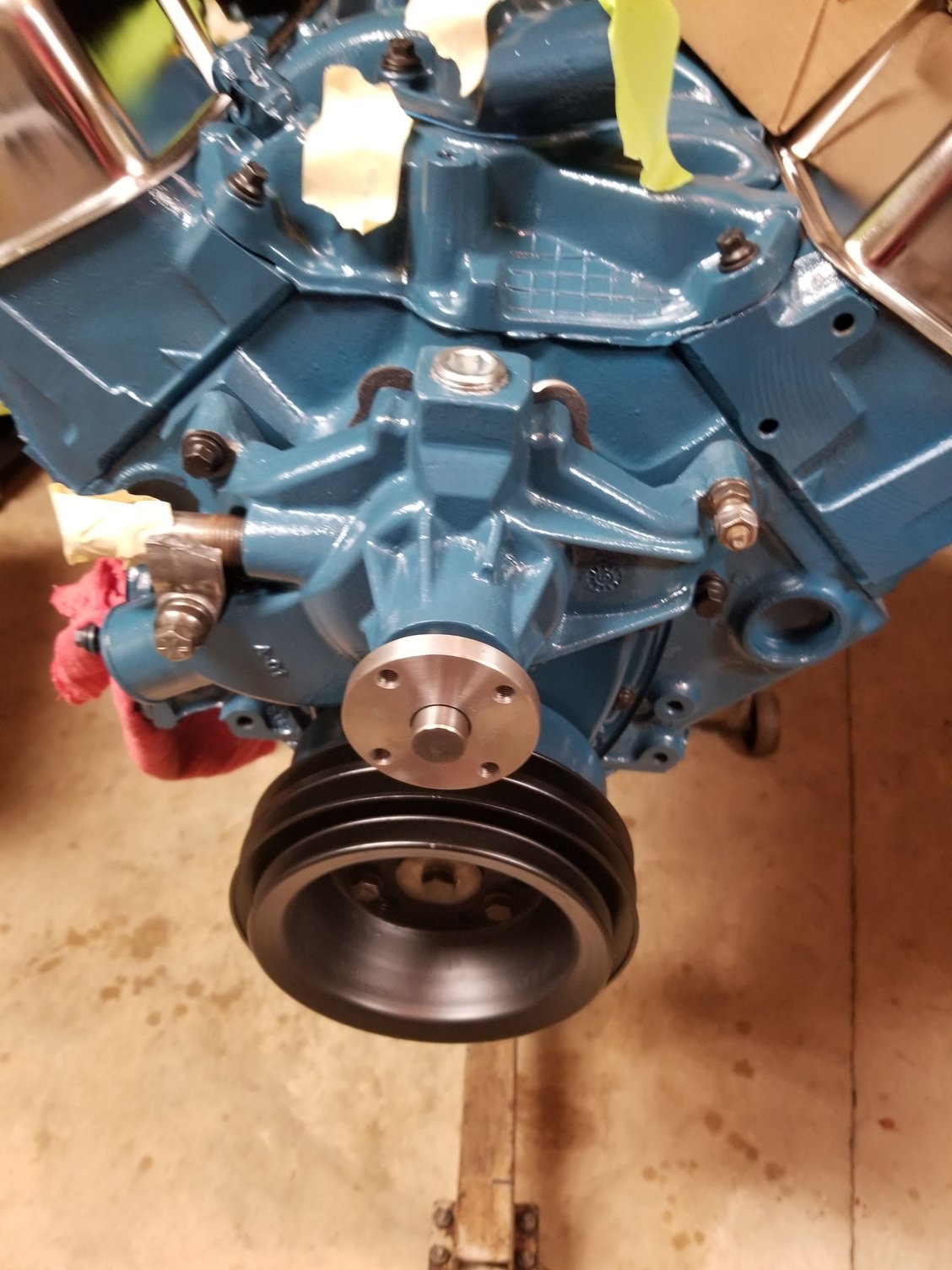

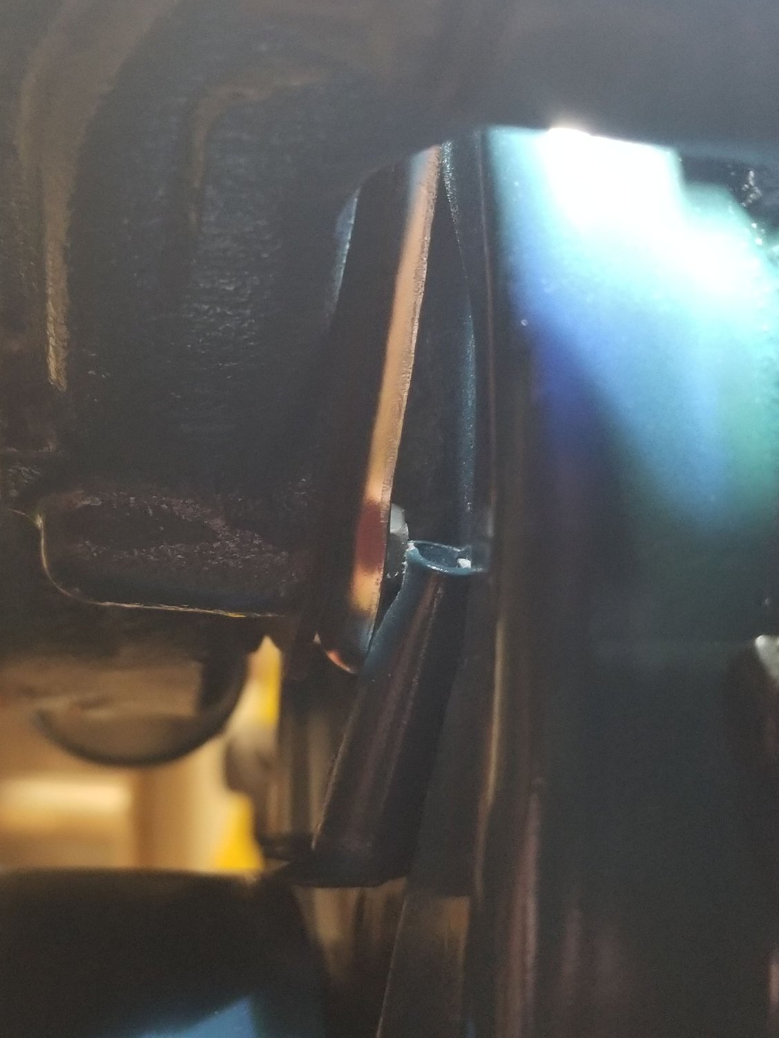

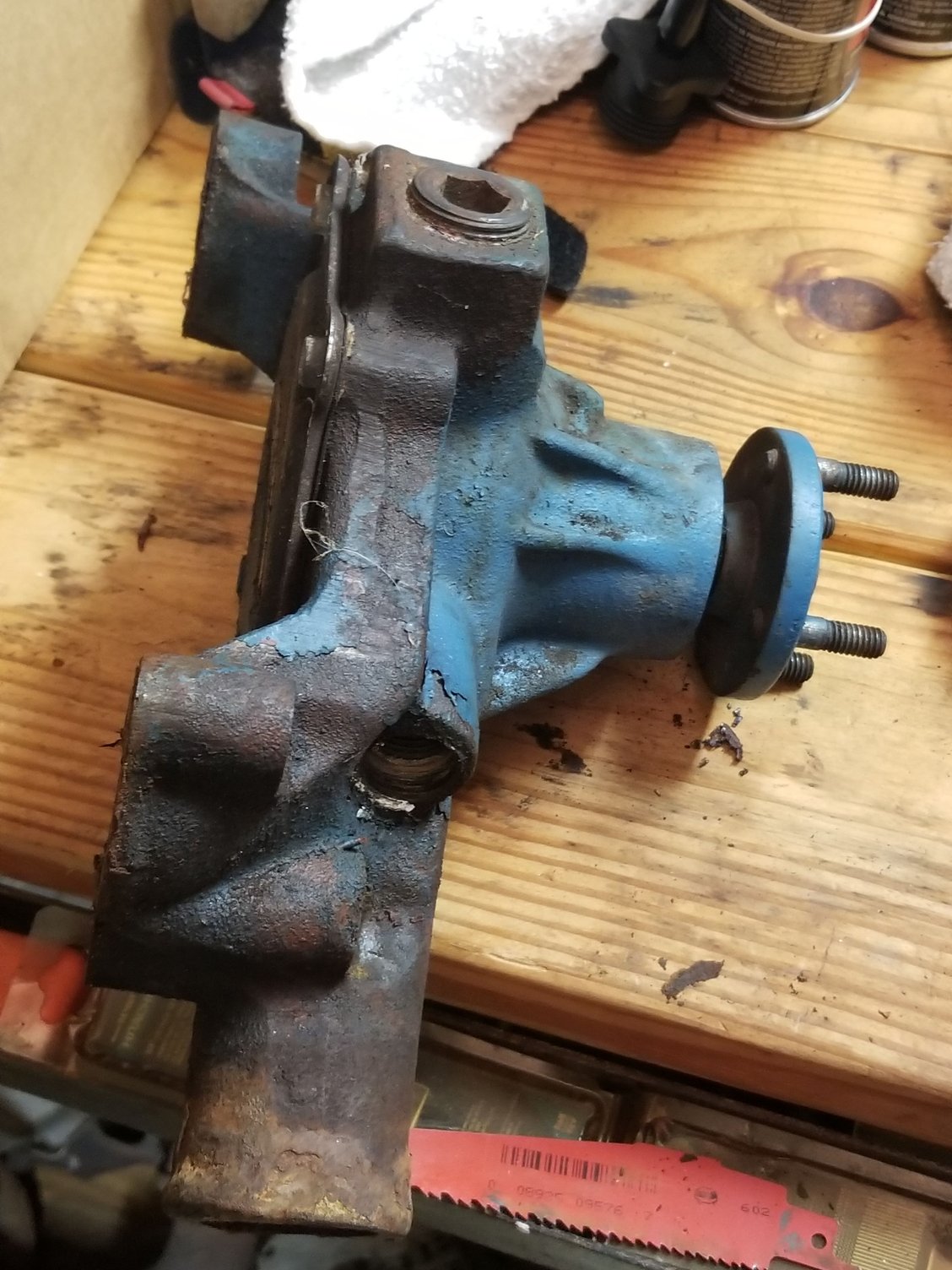

Old pump.
Old and new pump "looks" the same.
Where it's hitting timing mark.

the plate on back of water pump is supposed to have bolts with thin heads so they don't stick up off the back of the pump and hit the timing cover. if it is a bolt or two, buy bolts with smaller heads or take right angle grinder and trim the bolt down a bit. or borrow bolts from the old water pump. also check pulley alignment. mebbe could get away with double gaskets to space pump a 16th or so forward. changing timing cover is oil pan and balancer off. last choice...

Timing mark.
MelWff, this is what I got.....my mechanic asked if that was the correct cover. The machine shop may have given me the wrong cover back.

IIRC, trucks with those have Long WP ... Long pump body legs ... stands off forward from timing cover.
Pull the pump ... grind-cut ONLY the tube off ... remaining tab has your zero ... Verify with sp hole TDC stop ... that your damper & tab coincide w/ True TDC.

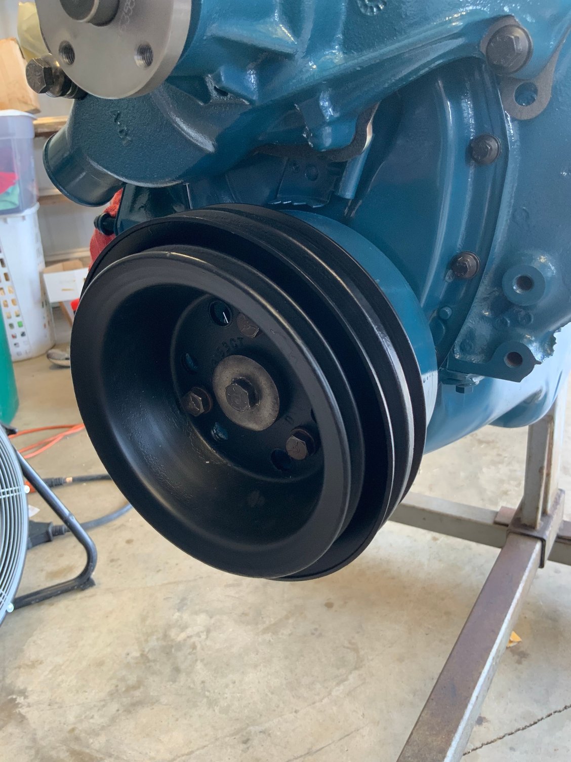

Cover looks wrong to me. That tube is not used for timing or anything else on your engine. The timing marks would be wrong for the original '80 Corvette harmonic damper. These parts are wrong.
1980 L-82 stock setup. Yours might be a little different because of the smaller diameter damper BUT this setup angle is correct. Some other vehicles use timing marks in other orientations because that is the way to SEE THEM in service. The brackets and accessories would be in different locations for different vehicles so the timing marks and balancer marks move as a pair together depending on original application. The tab on your cover is closer to 12:00 where the Corvette tab would be closer to 2:30 and close to the edge of the timing cover. Need the right cover and positively verify the balancer Top Dead Center mark actually line up at Top Dead Center.
1980 L-82 original timing cover setup.
