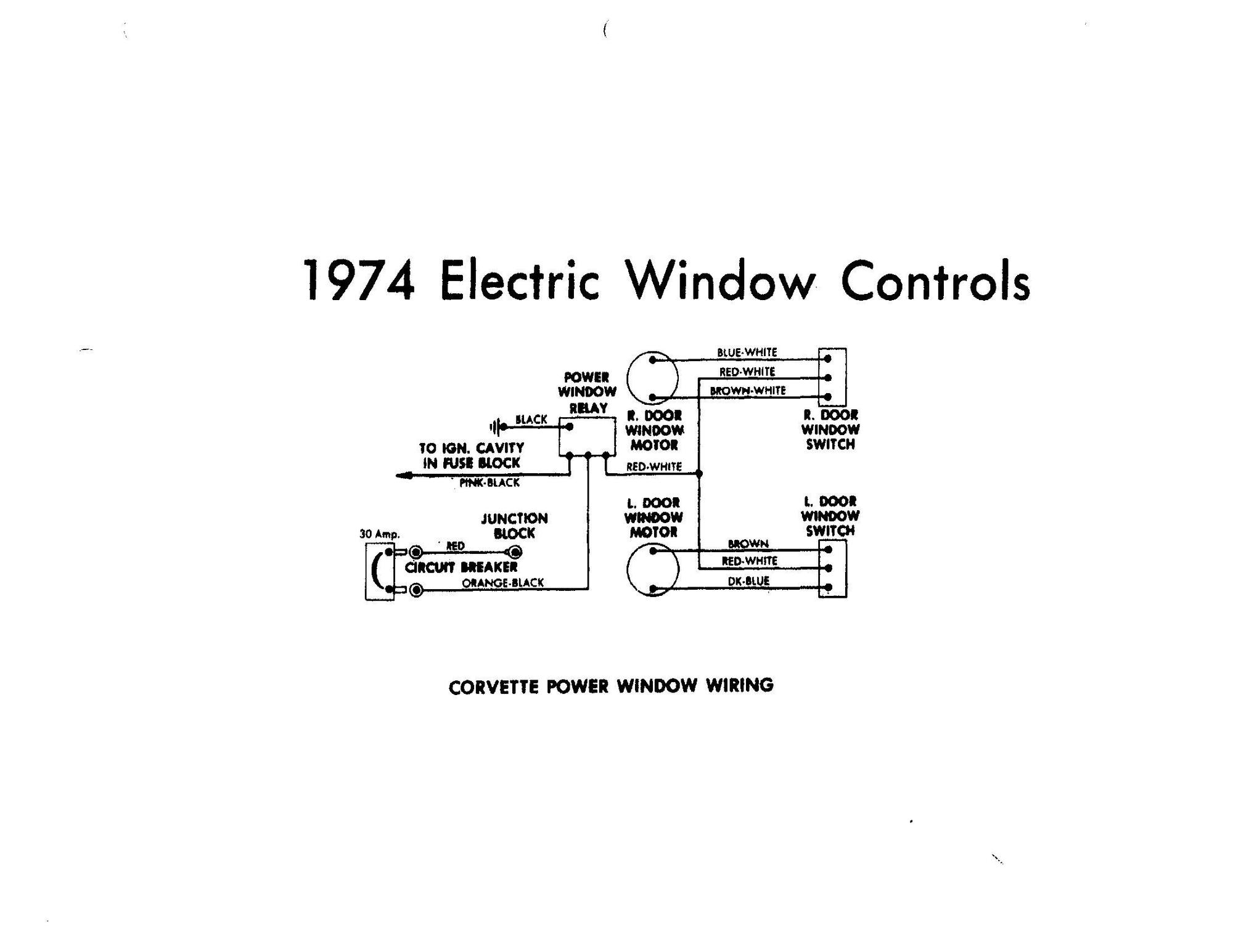

Originally Posted by yelo80vette
Right. It has one blue and one brown wire. Basically one wire for up, one wire for down. Compared to some door motor wiring I've seen during my research, it's stupidly simple. Just like me when it comes to automotive electrical repair. Thank Derek !
The ground is the motor case when mounted on your door.
The two-prong plug on the motor sends 12 volts to one terminal for UP and 12 volts to the other terminal for DOWN.
Check that the PINK-BLACK
is plugged into the fuse box.
Old Oct 5, 2019 | 04:18 PM
yelo80vette's Avatar
yelo80vette
Joined: Jul 2012
Posts: 51
From: Columbus Ohio
Excellent information. Great diagram. It's dumbed down so even I can understand it. This gives me a lot more info to go on. Thanks lots !

From: Cape Girardeau Missouri
That '74 wiring diagram does not what was used in '80 !!
Yours does not use a relay. It has a circuit breaker (small oblong aluminum "box") in the fuse box with (PWR ACC) written below it. They are thermal and supposed to reset but they go bad sometimes. Remove the breaker and check it for continuity.
To Power window, come on. Work with me !
Old Oct 7, 2019 | 07:24 PM
yelo80vette
Joined: Jul 2012
Posts: 51
From: Columbus Ohio
I did see that and I knew the "80 didn't use a relay. Since the 2 or 3 breakers that are in the fuse box have been there for at least the 13 years I've
had the car, I was going to purchase new ones and replace them anyhow. Thanks for the info.
