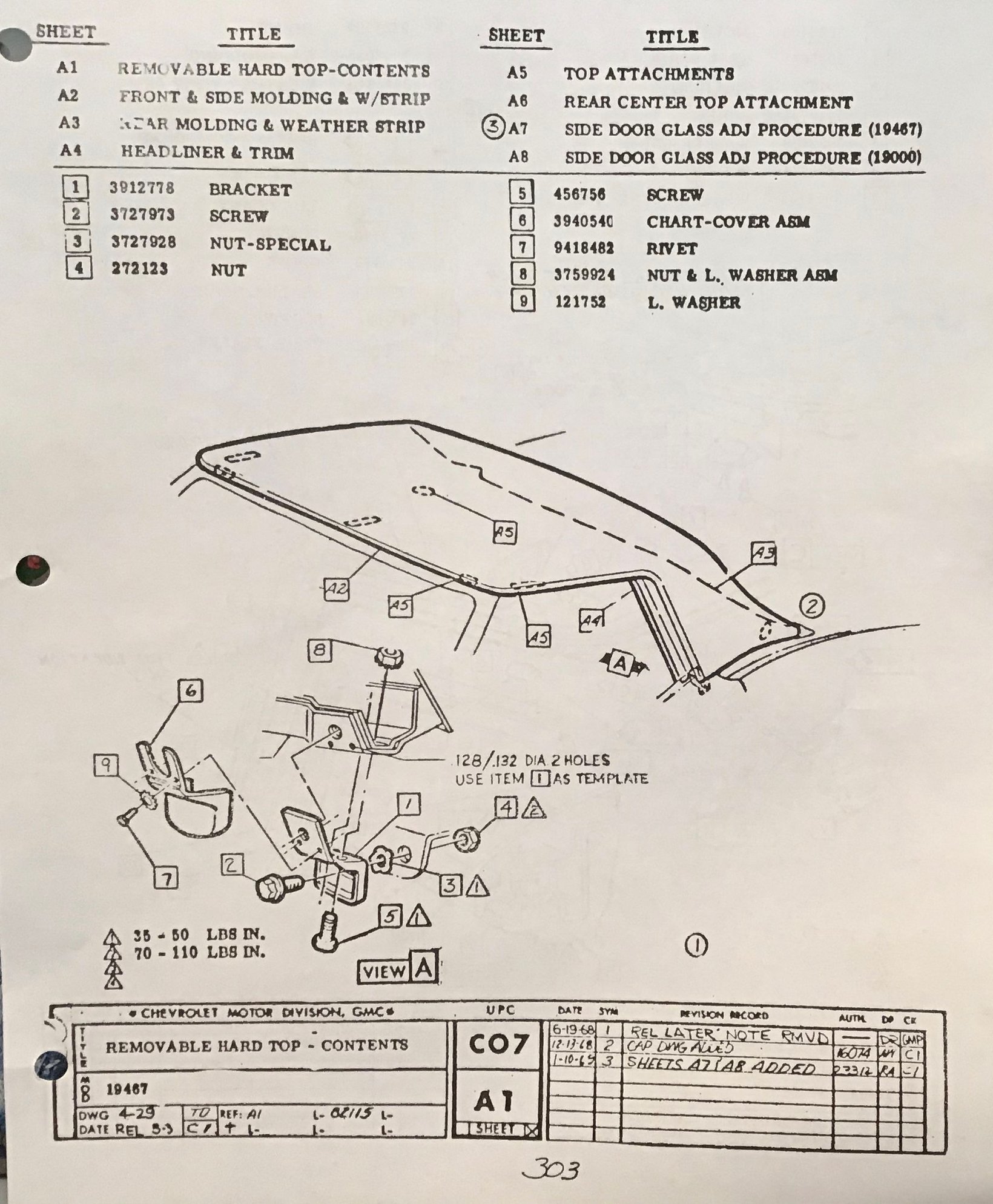

Here are some pages from the AIM that I hope will help. I bought my hardtop in 75 when GM announced there would be no more convertibles. It has spent most of its life in storage.
Note 7 on page A6 instructs how to locate the hole in the middle of the deck without scaring the deck with the bolt. It worked for me.
Thanks Pete (and everyone else)!
