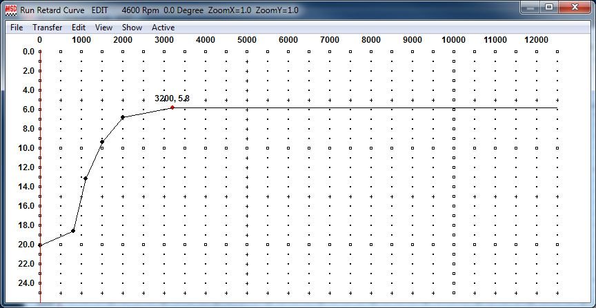

Here is what the retard curve look like on the laptop.
In this example @ 3200 RPM the module will retard the ignition by 5.8 degrees. So If the distributor with 0 degree retard = 36 degrees the ignition module timing will be 36-5.8 = 31.2 degrees.
So at 1000 RPM ~ 15 degrees retard = 36-15 = 21 degrees. The vacuum curves works the same way. It adds addition retard but based on engine vacuum.
